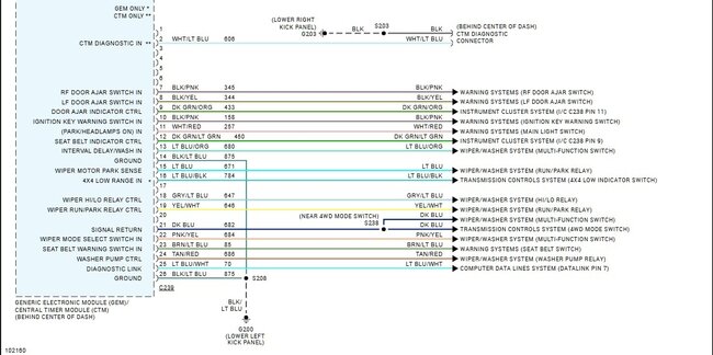

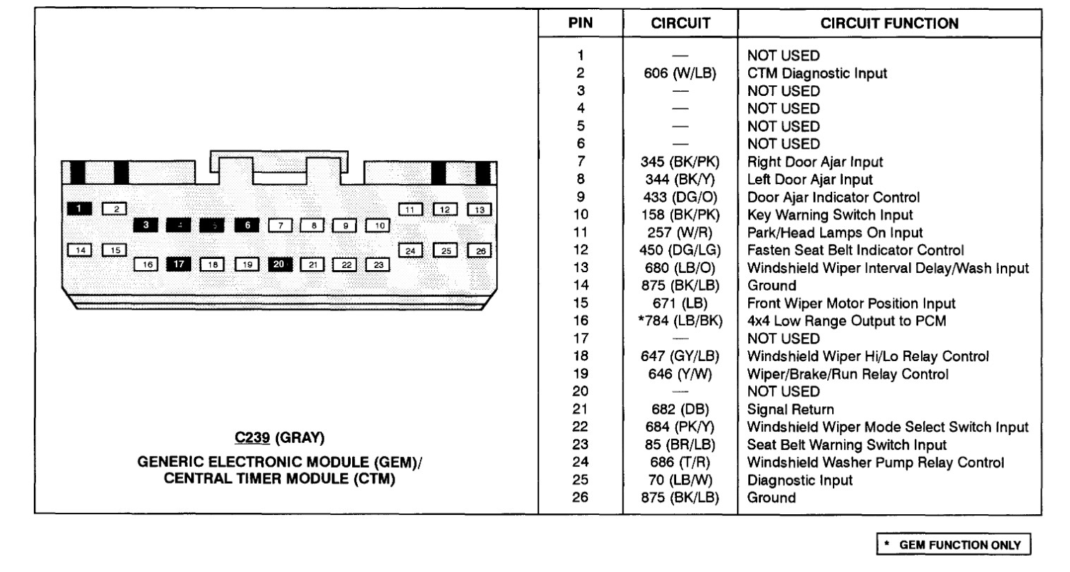

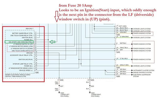

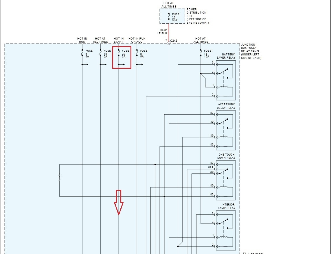

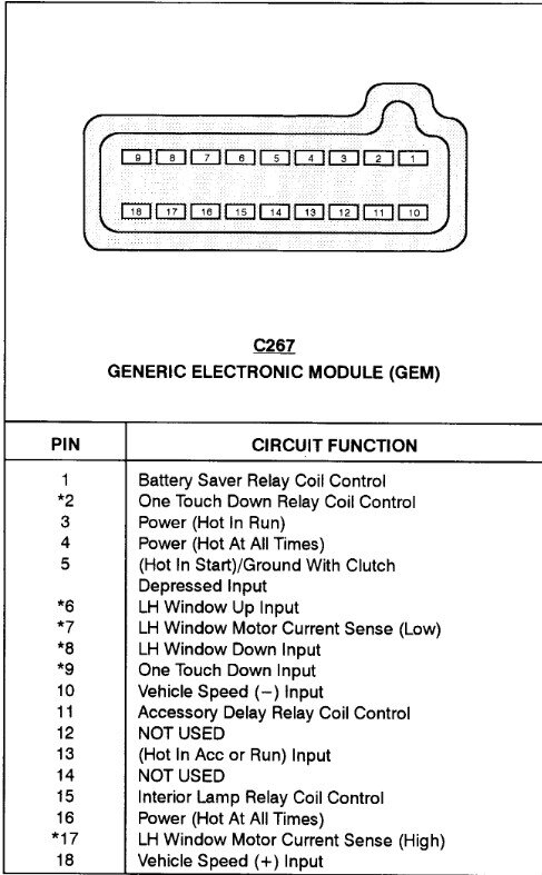

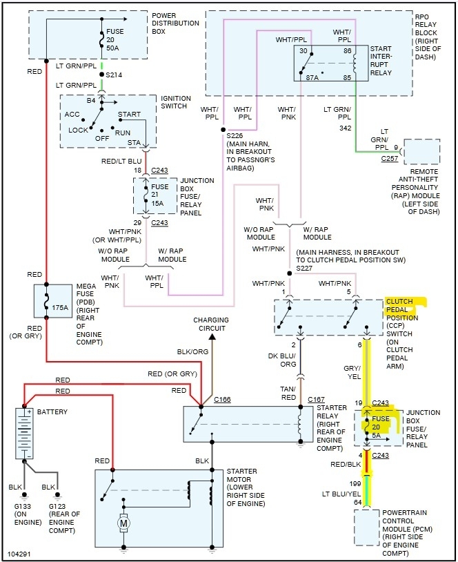

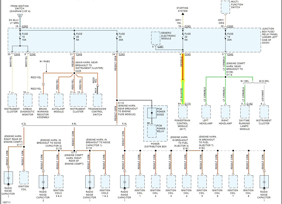

Ok , everything looks good on the PCM/ fuse box .
I tested fuse number 20 for power with key in start position, no power. But with key off it's getting power now ,,,,
It's not making since to me .
I cranked the motor over and the rpm gauge isn't moving and no check engine light .
The crankshaft sensor is new . So is the camshaft sensor is new also .
What is the problem

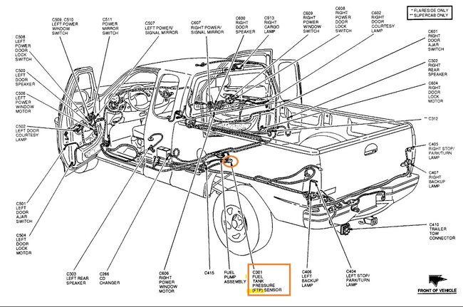

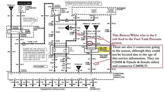

Ok I will recheck on Fuse 20, but which sensor did you check the 5volt reference on and how did you check it? For example if you unplug the throttle position sensor (TPS) on the throttle body, turned the key On and only read 1.2volts (Brown/White wire), I would do the same for the next sensor you can get to which is the EGR position sensor (DPFE). If that sensor reads the same exact voltage reading as the TPS on the Brown/White wire, you are going to have to get to the fuel tank pressure sensor and unplug it as well. Its not easy to get to but you need to be sure this isnt a shorted out sensor pulling the 5volts down. I am kind of surprised you have any voltage on the reference wire.
Let me see if there is an easy connector to get to so you can unplug the fuel tank pressure sensor without having to mess around at the top of the gas tank, you can get to the plug but they are difficult. So if we can isolate that circuit by unplugging it somewhere easier that will help with any frustration. That 1.2volts might be the issue, I assume the battery voltage is ok, if its dropped below 12.4volts I would put a charger/maintainer on the battery while testing, or you will get skewed readings. And yes you should get a resistance reading, but checking resistance while a circuit has current running through it will give inaccurate readings, so you need to unplug components and circuits if youre going to do a resistance test on them.
I really only use resistance readings for checking components to have the correct resistance(to be within Spec), for a quick for short to ground test, or a quick continuity test. But for power and ground testing directly from a fuses source I will do an electrical load test so I am pulling more amps through a suspect circuit. A wire can test perfectly fine on a resistance test but only have 1 strand of copper left inside the wiring insulation. That situation will fail a load test using a higher amperage bulb. Anyway let me look for a connector for the tank pressure sensor.

Heres the location of the fuel tank pressure sensor, the 5volt feed to it needs to be disconnected somehow to verify its not the issue. You can slide under the truck and try to find the connector going to the top of the gas tank, it is possible with a mirror and flashlight to find the connector. But get it unplugged and see if the 5volts returns on the other sensors. I know its a pain, on these trucks I take the bed right off when I need to do a fuel pump instead of dropping the tank. But see if you can restore that reference voltage.

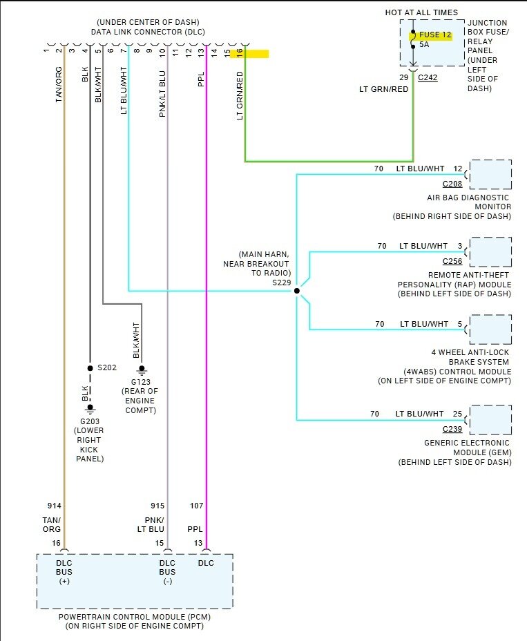

The last diagram is of the data link connector, you should have battery power on pin 16 and grounds on 4 and 5.
One last thing, is the battery voltage just dropping off after its had a full charge off the vehicle?

I went back and checked the voltage on the EGR sensor and I have 5 volts.
Checked the tps and have only 1.2 volts tested with a DMM .
Rigged up a turn signal bulb to test for amps like you said, the EGR sensor lights up the light . But the throttle position sensor reference wire will not light it up .
Is this the problem ?

I should clarify this circuit load testing with a turn signal bulb. That is only for checking 12volt power feeds and grounds that come directly from a fuse or going to a ground that does not pass through a module. Its not meant for use on 5volt reference circuits. That was my mistake in not being more clear about that. When checking the 5volt ref, just use a DMM.
When you checked the TPS I assume you had it unplugged to check the 5v feed? And the same for the EGR position sensor, you checked it when it was unplugged? If thats the case, I would go back and unplug the EGR sensor, leave it unplugged and then recheck the TPS again, if the 5volts has returned to the TPS sensor, then the EGR sensor is causing the short.
The trick in explaining this is that they share this 5volts, so for example if the EGR sensor is shorted out, while its plugged in, it will pull the 5volts on the other sensors down with it.
Now when you go to test and unplug the EGR sensor, you are taking the short circuit away due to the sensor not being plugged in anymore. Hopefully this makes sense.
It would be the same if the TPS was shorted out, it would cause the EGR sensor to read low as well when plugged in. When either sensor is unplugged in it cant short the 5volts to ground.
The EGR, TPS and Fuel Tank pressure sensors are the ones that share that 5volt reference.
So for now just unplug the EGR and recheck the TPS. To be honest its odd that the TPS is reading 1.2volts and the EGR is reading 5v. I wouldnt worry about the tank pressure sensor right now. Concentrate on the TPS and EGR sensors.
This circuit is designed, internally, inside the PCM to handle a short to ground or shorted sensor(same idea). They do this because the manufacturers know sensors short out and they dont want to be replacing computers every time a sensor shorts to ground.
If you find the 5v return to the TPS with the EGR sensor unplugged, the truck might start. But see what you find, I think youre close to the issue here. That low voltage on the TPS is obviously a problem.

I did as you said, I unplugged the tps sensor and the EGR sensor,,, I turned the key on and the check engine light came on I checked the tps sensor and it has 5 volts now. So I need to replace the EGR sensor correct

Yes and good diag work, plug the TPS in and see if it starts, it doesnt need the EGR position sensor to start, explaining how to test reference circuits can be very difficult on our end of things, so I am impressed. Hook the battery up and make sure it starts. When the PCMs go down due to shorted sensors like this, I dont think there is ignition spark or fuel injector pulse, so you shouldnt have to deal with cylinder wash from cranking when it wouldnt start.
