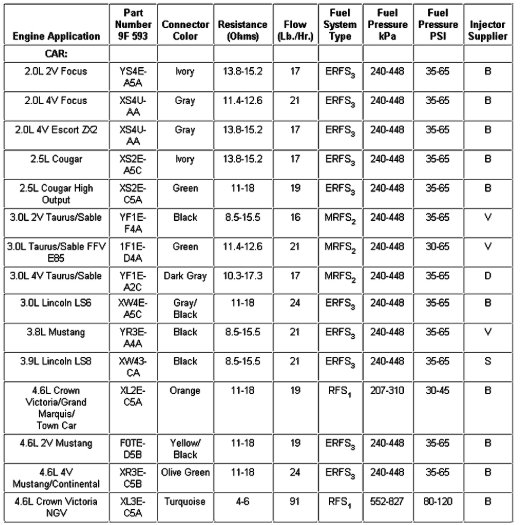

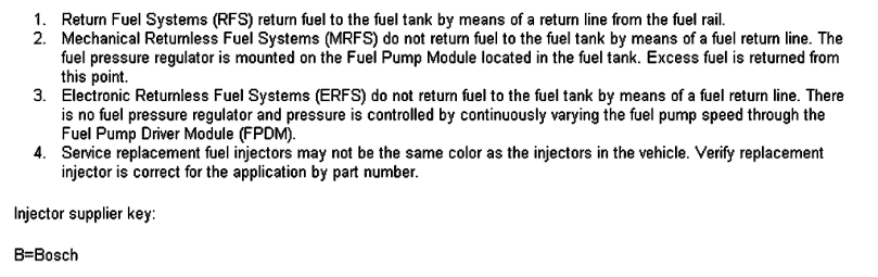

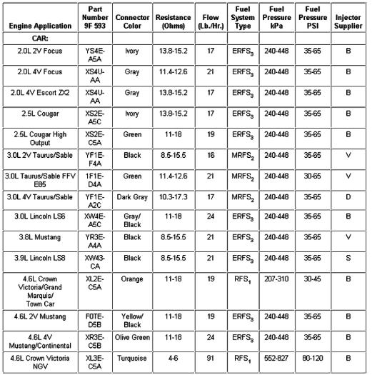

Have you checked the actual fuel pressure? It could be you have a weak or failing fuel pump even though you hear it running. If you don't have access to a fuel pressure tester most auto parts stores have a tool loaner program and can rent you one.Here is a tutorial showing what is involved:
The specification for you car is attached in the pictures below.Hope this helps and thanks for using 2CarPros.

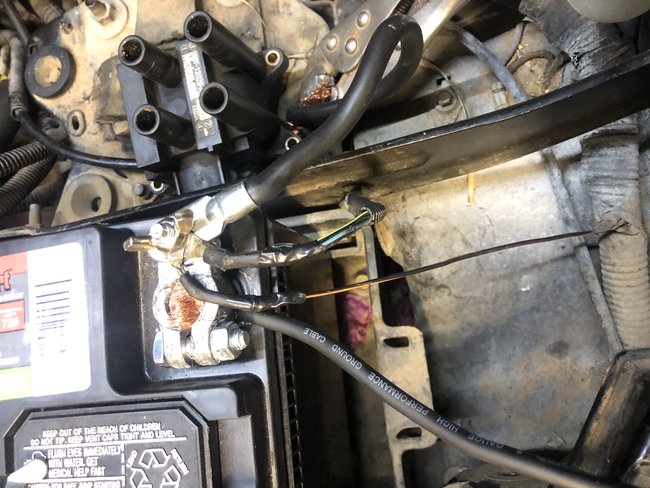

Yea, I checked fuel pressure by removing the two bolts that screw into the rail. And it seems to have good pressure but I don’t have the tester. I pulled the injectors and cleaned them as best as I could and I added another ground to the car but still no luck. When I pulled the valve that goes into the injector, I had a strong continuous stream of gas so I know I’m getting fuel, not a clogged filter. What I did notice is that on the negative battery terminal there is a main ground leading to the motor and transmission. And there’s also two thin wires, when I unplug those wires, the whole fuel pump and everything else cuts off. What could that be?

Can you please shoot a quick video with your phone so we can hear the engine cranking over? that would be great. You can upload it here with your response. This will tell us if the engine is any good before we continue. It sounds like you may have a clogged catalytic converter.
