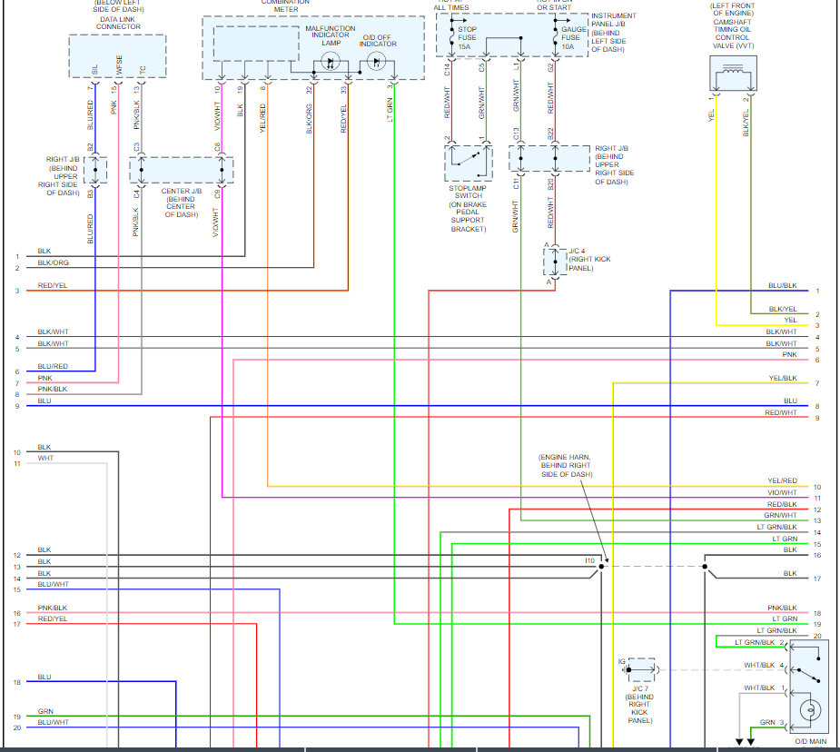

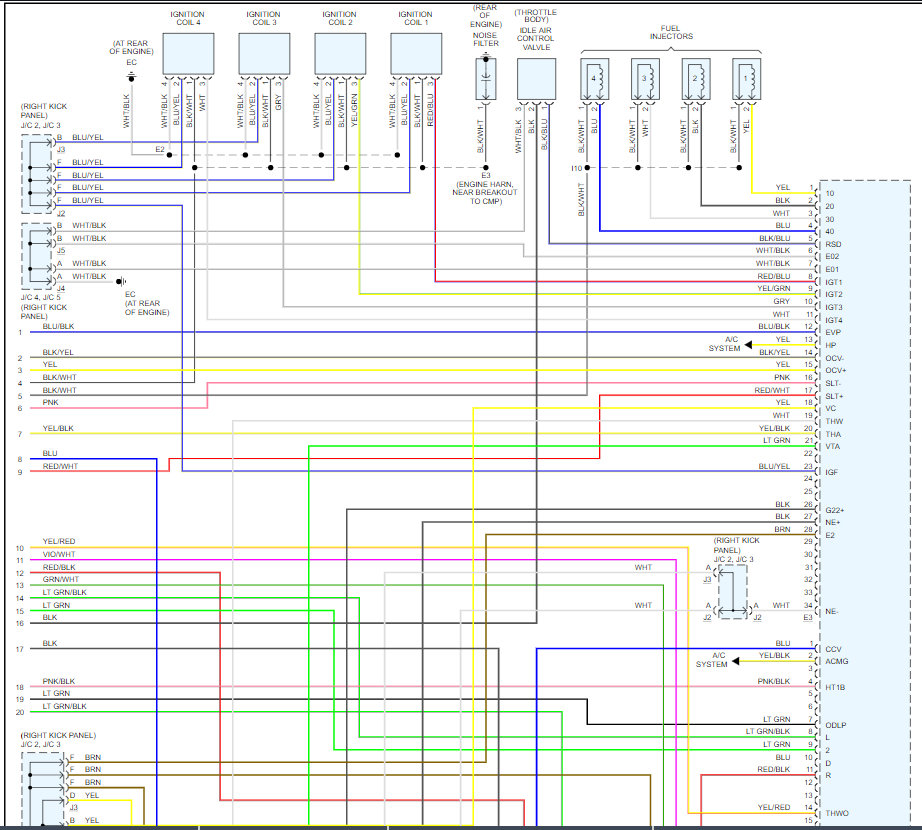

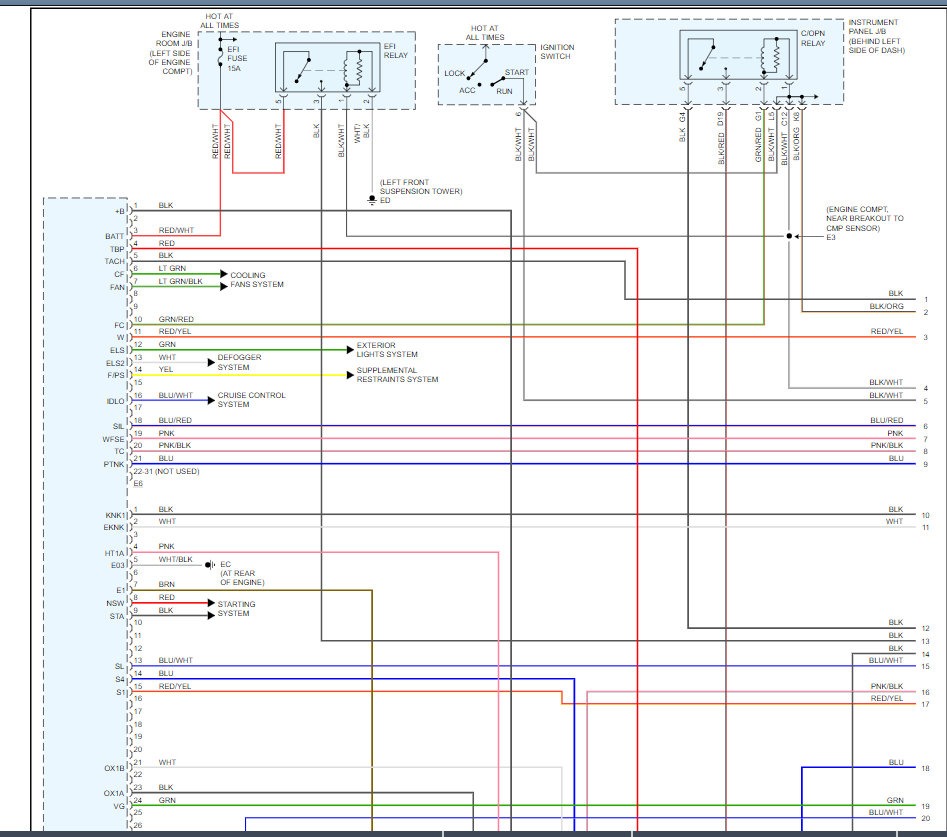

Good morning, I have checked the fuse and relay, they are in good condition. The fuel pump and fuel injectors are functioning but there's no spark on any of the plugs. I tested the wires connected to the coil just to find out that there's no ground in any of the plugs. What could have caused it?
Oct 14, 2020 at 8:01 PM
  • 54,832 POSTS

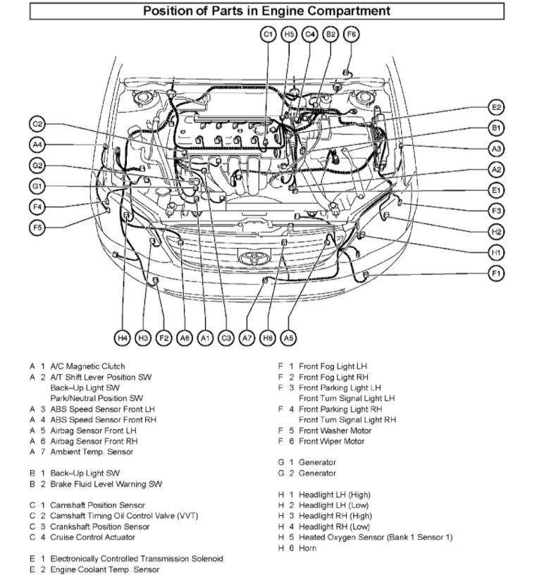

Most of the time it will be the crankshaft sensor which is common. to be sure here are are two guides to help us see what's going on:
and
I have also included the crankshaft position sensor location so you can check it out. Check out the diagrams (below). Please let us know what you find. We are interested to see what it is.
Oct 15, 2020 at 10:27 AM

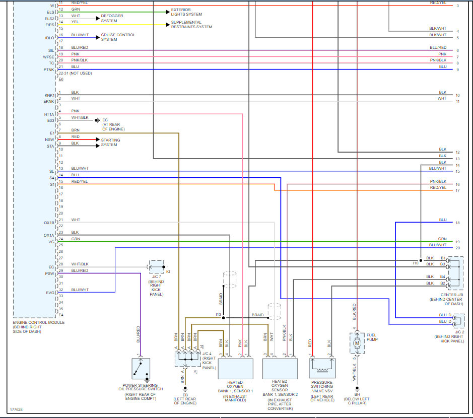

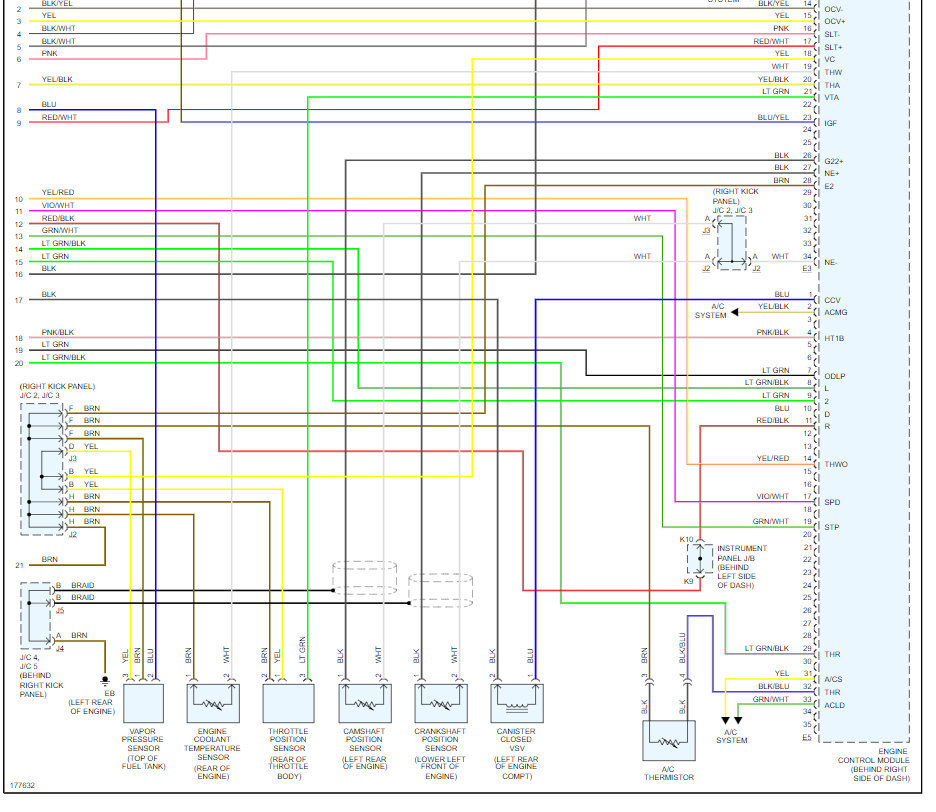

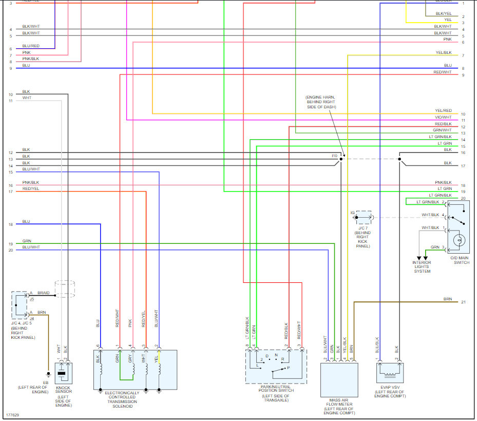

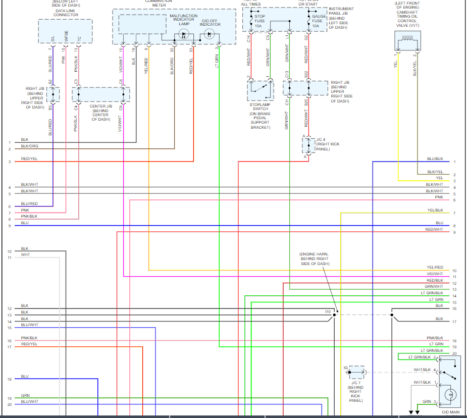

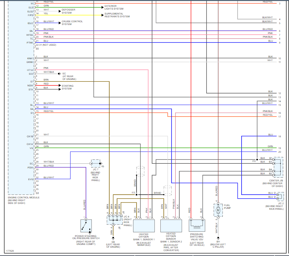

Here are the engine wiring diagrams with a guide to help check the connections.
Dec 6, 2020 at 5:18 AM
BLESSING EWOBOR
  • 753 POSTS
Thank you very much it was a bad connection at the crankshaft sensor
