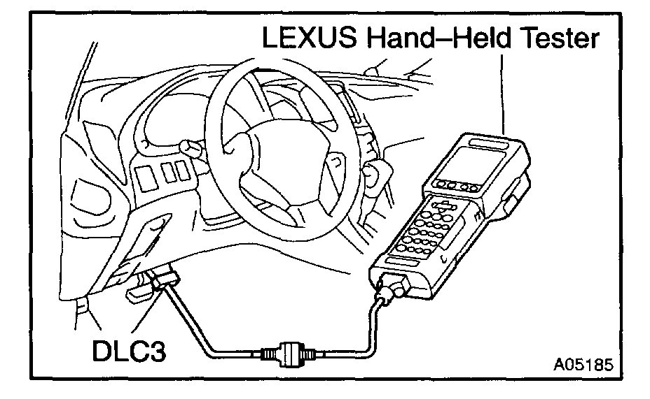

a. Connect the LEXUS hand-held tester or OBD II scan tool to the DLC3.
b. Turn the ignition switch ON and LEXUS hand-held tester or OBD II scan tool main switch ON.
NOTE: Do not start the engine.
c. Select the active test mode on the LEXUS hand-held tester or OBD II scan tool.
d. Please refer to the LEXUS hand-held tester or OBD II scan tool operator's manual for further details.

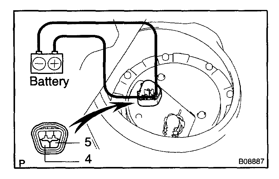

e. If you have no LEXUS hand-held tester or OBD II scan tool, connect the positive (+) and negative (-) leads from the battery to the fuel pump connector.
Picture 2
f. Check that there is pressure in the fuel inlet pipe from the fuel filter.
HINT: If there is fuel pressure, you will hear the sound of fuel flowing.

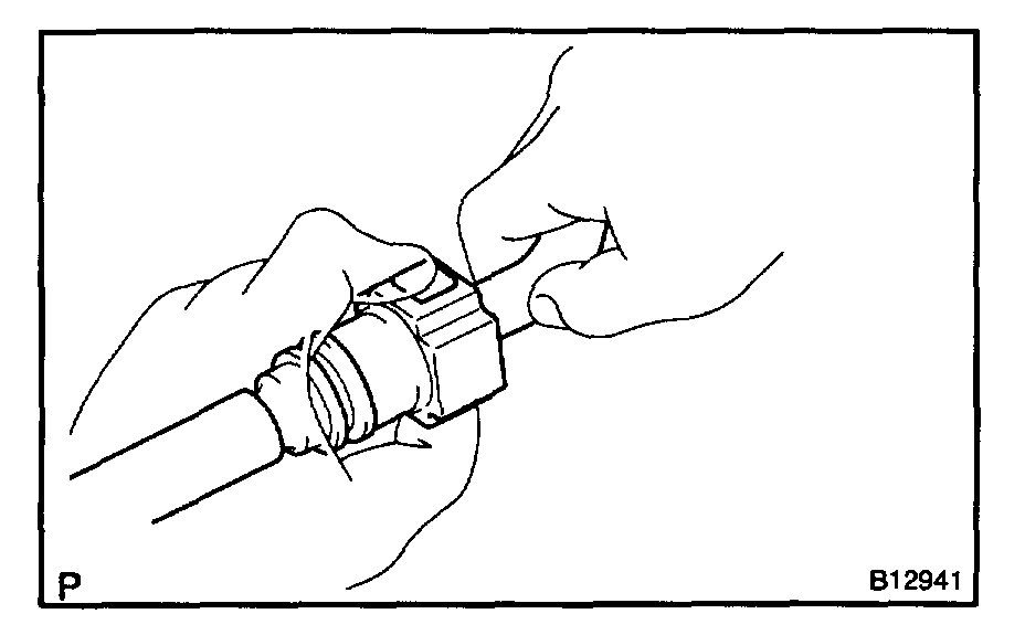

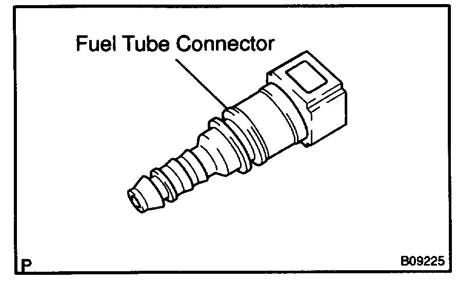

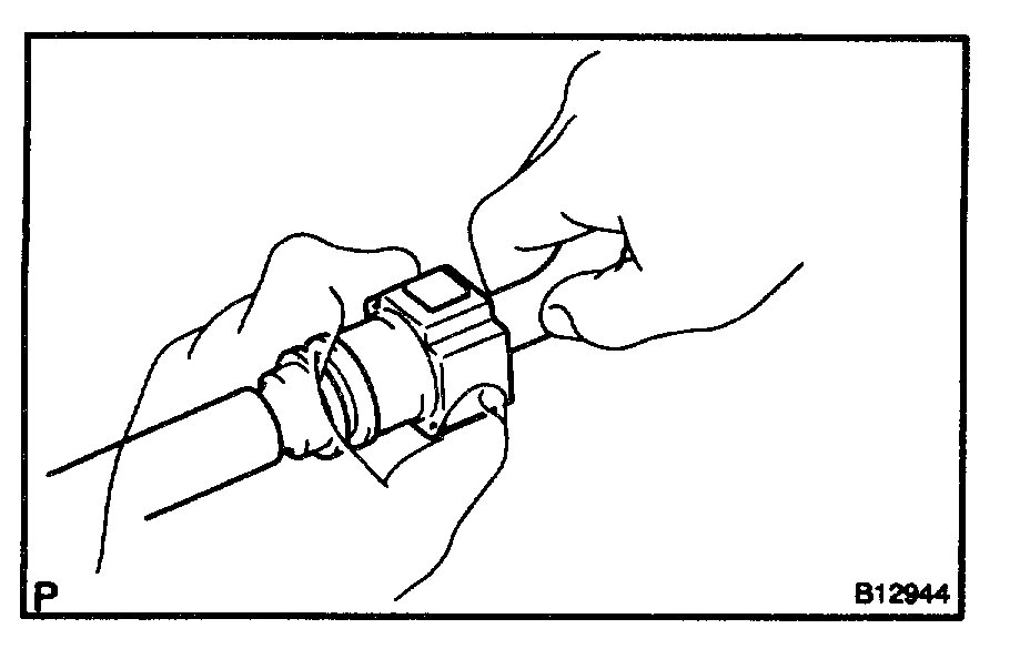

c. Purchase the new No.1 fuel pipe and take out the fuel tube connector from its pipe.
Part No.23801-20120

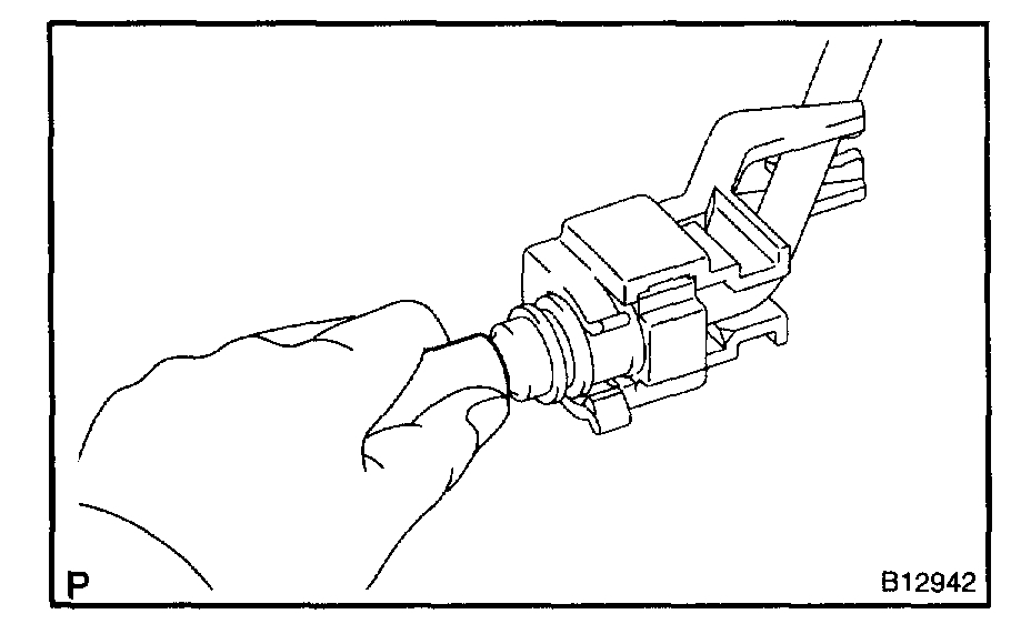

Picture 4

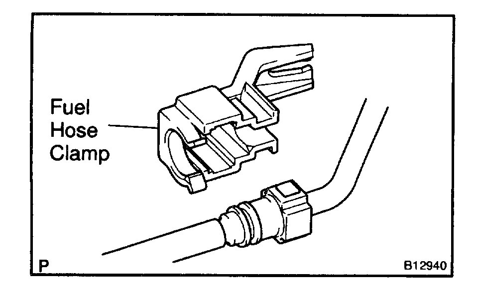

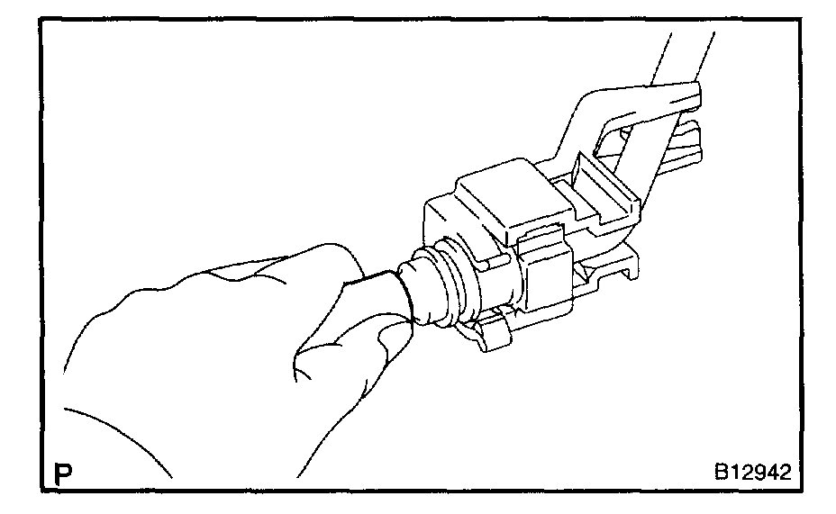

d. Remove the fuel hose clamp.
Picture 5
e. Disconnect the No.1 fuel pipe (fuel tube connector) from the fuel tube.

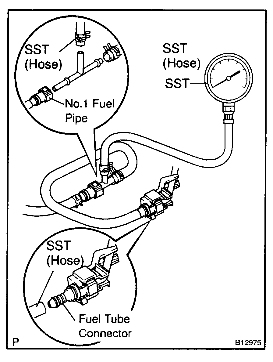

f. Install SST (pressure gauge) as shown in the illustration by using SST and fuel tube connector.
SST 09268-41047, 09268-41250, 09268-45014
g. Wipe off any splattered gasoline.
h. Reconnect the negative (-) terminal cable to the battery.
i. Connect the LEXUS hand-held tester or OBD II scan tool to the DLC3 (See step 1.).
j. Measure the fuel pressure.
Fuel pressure: 301 - 347 kPa (3.1 - 3.5 kgf/sq.cm, 44 - 50 psi)
If pressure is high, replace the fuel pressure regulator.
If pressure is low, check the fuel hoses and connections, fuel pump, fuel filter and fuel pressure regulator.

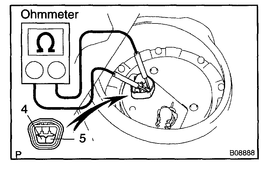

f. Using an ohmmeter, measure the resistance between terminals 4 and 5.
Resistance: 0.2 - 3.0 Ohm at 20 °C (68 °F)
If the resistance is not as specified, replace the fuel pump.
