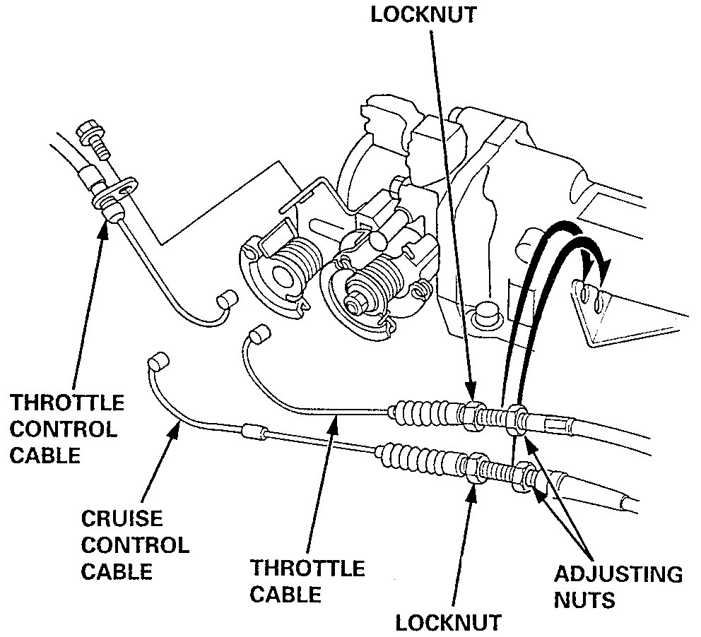

3. Remove the throttle cable, throttle control cable (Automatic Transmission [A/T]) and cruise control cable.
NOTE:
^ Take care not to bend the cable when removing it. Always replace any kinked cable with a new one.
^ Adjust the throttle cable, throttle control cable and cruise control cable when installing.

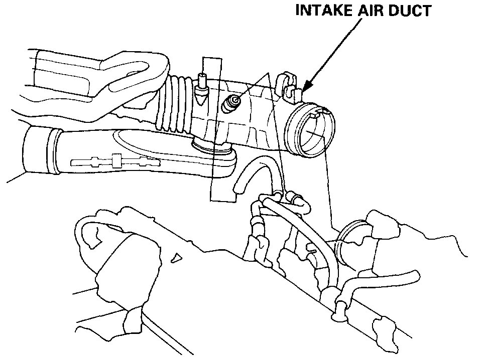

4. Remove the intake air duct.

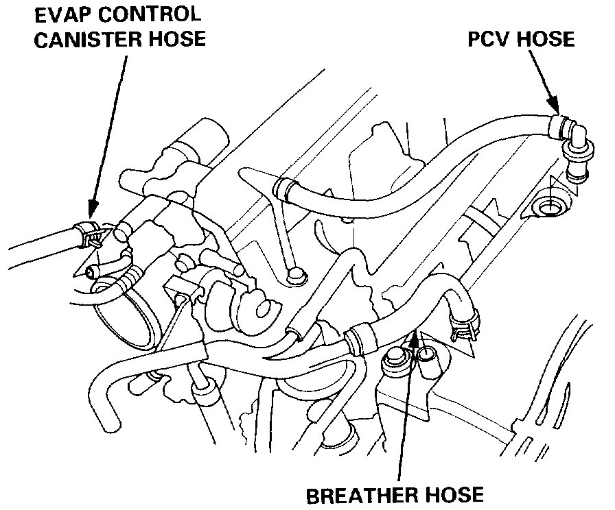

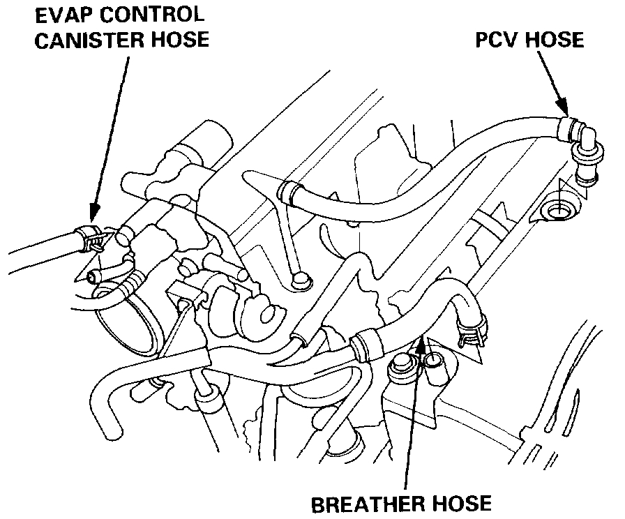

5. Remove the breather hose, positive crankcase ventilation (PCV) hose and Evaporative Emission (EVAP) control canister hone.

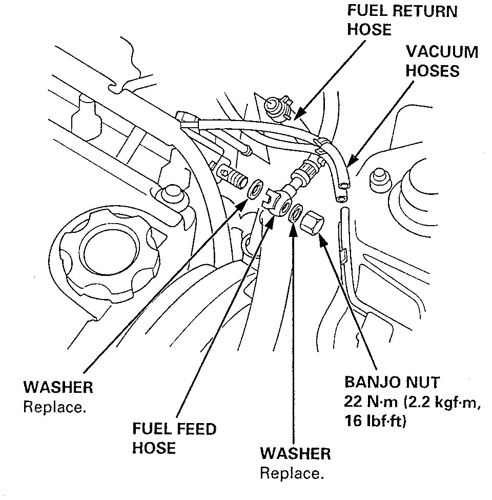

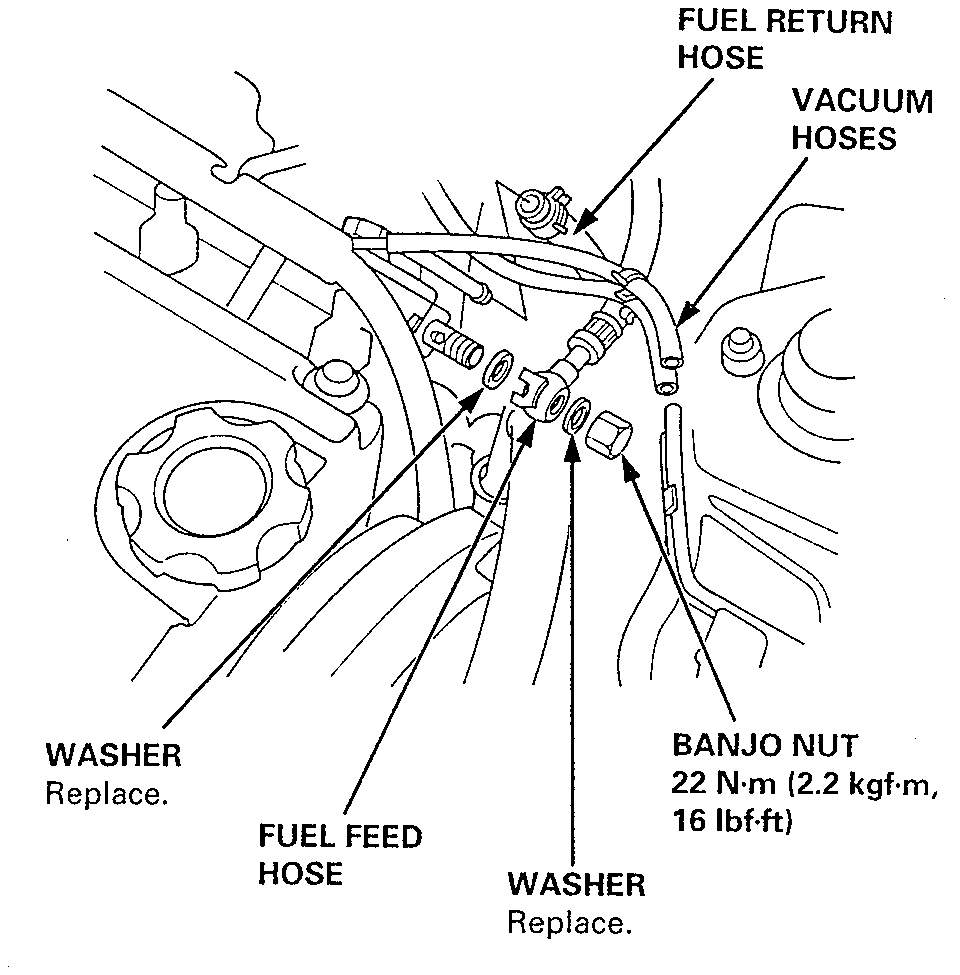

7. Remove the fuel feed hose, fuel return hose and vacuum hoses.

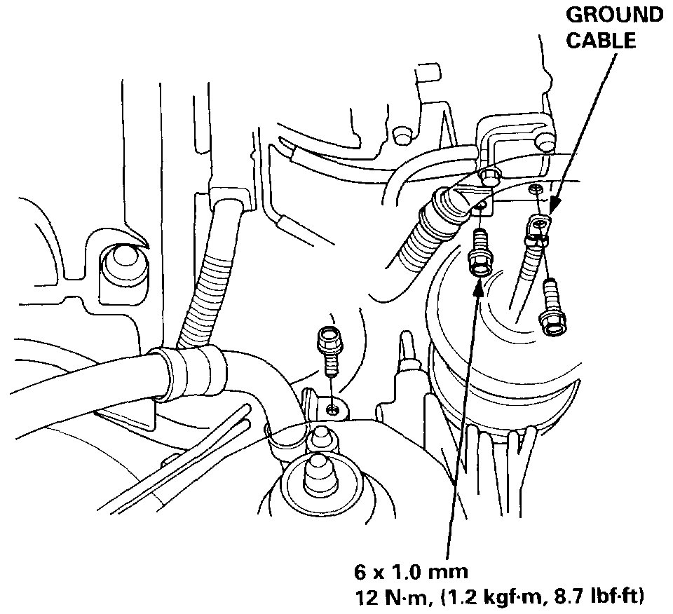

9. Remove the Power Steering (P/S) hose clamp, wire harness clamp and engine ground cable.

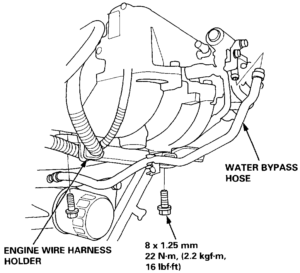

13. Remove the engine wire harness holder and water bypass hose.
14. Remove the engine wire harness connectors and wire harness clamps from the cylinder head and the intake manifold.

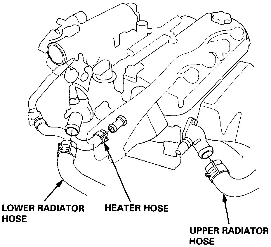

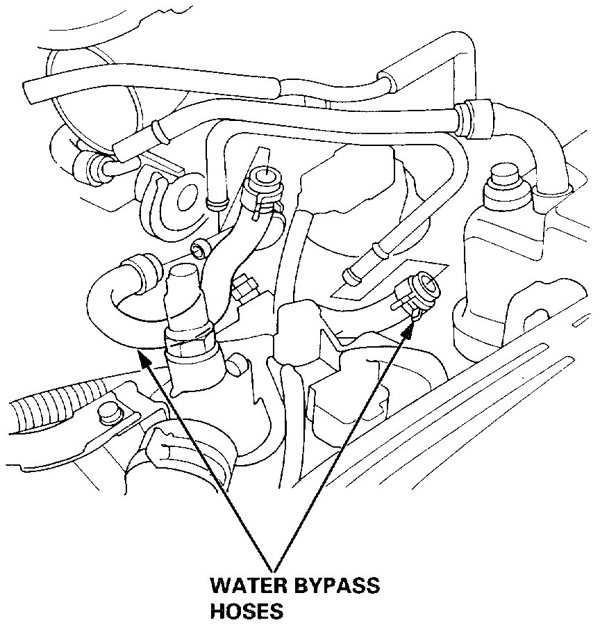

16. Remove the upper and lower radiator hoses and heater hose.
pic 8
17. Remove the water bypass hoses.

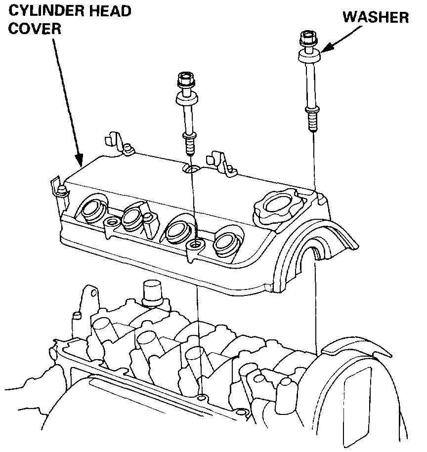

19. Remove the cylinder head cover.

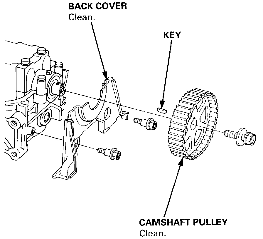

21. Remove the camshaft pulley and back cover.

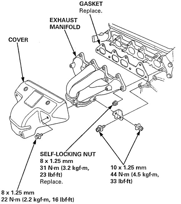

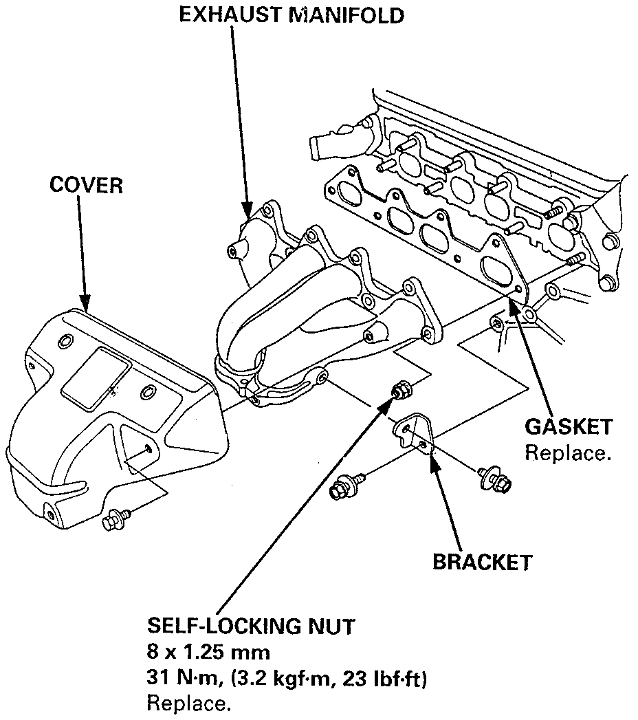

23. Remove the exhaust manifold.
pic 12

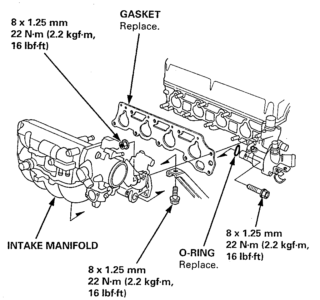

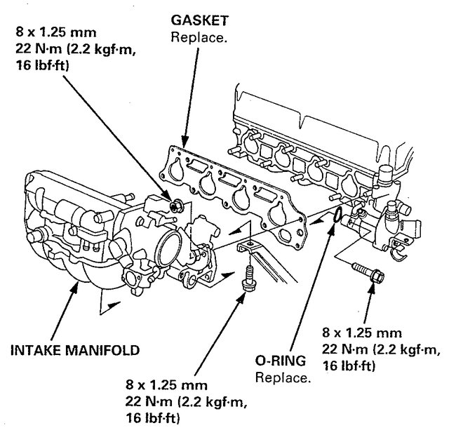

24. Remove the intake manifold.

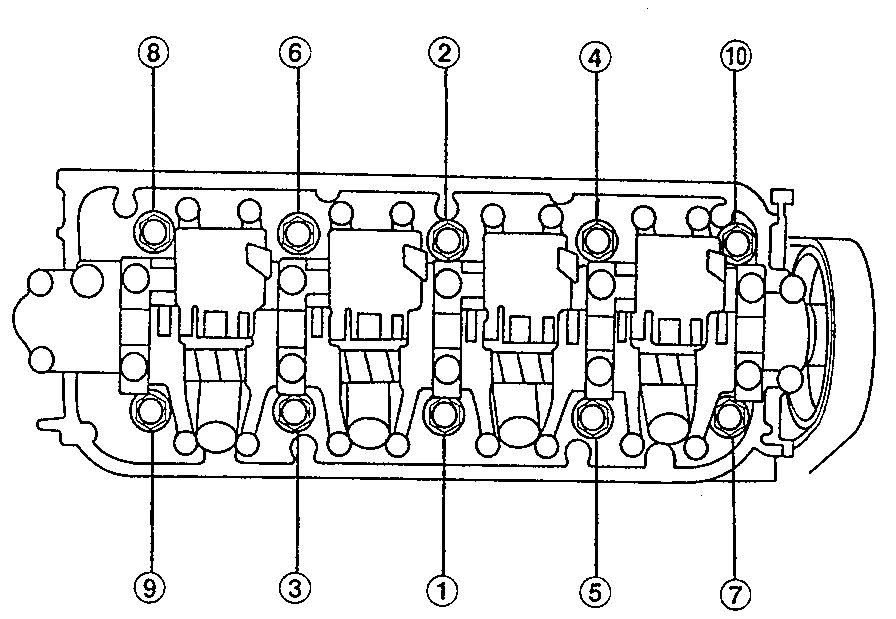

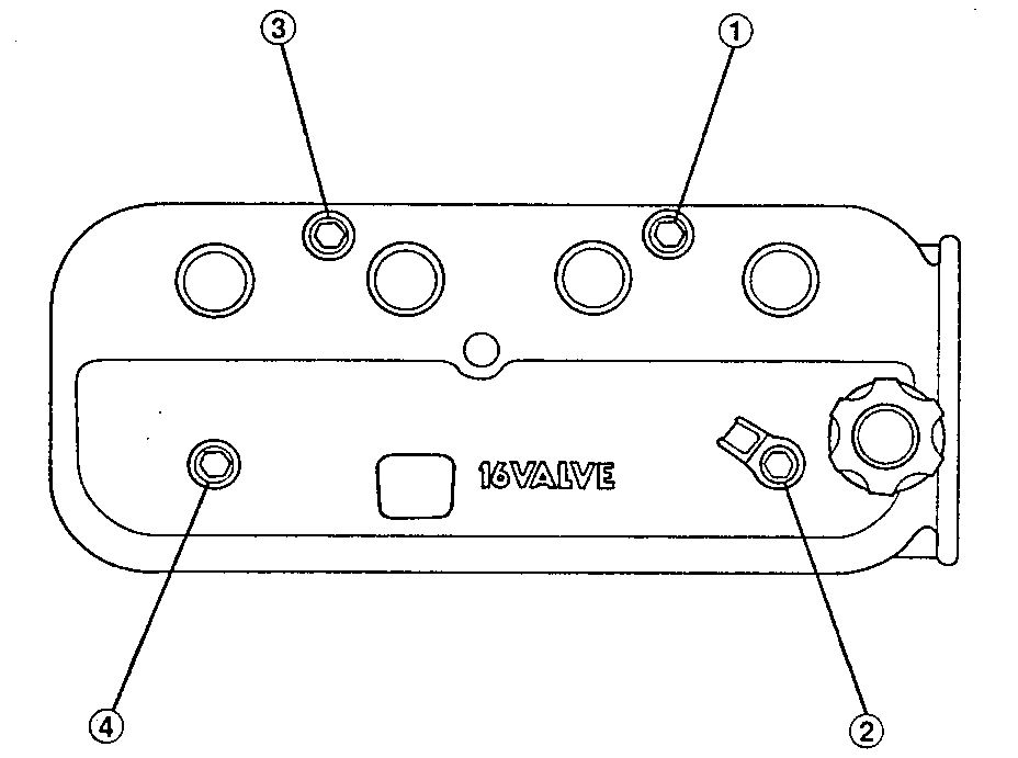

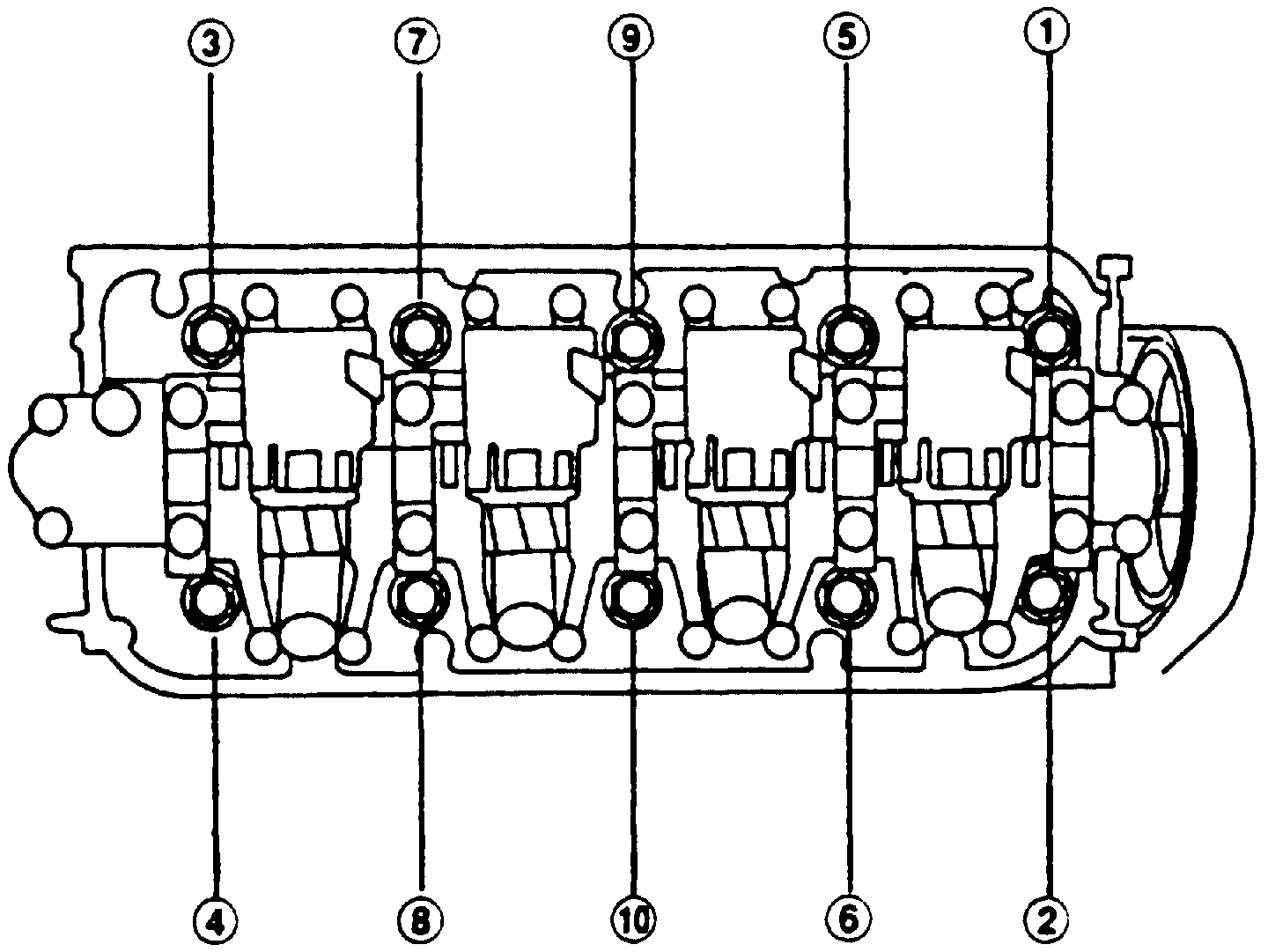

Fig. 11 Cylinder Head Bolt Loosening Sequence
pic 13
25. Remove the cylinder head bolts, then remove the cylinder head.
CAUTION: To prevent warpage, unscrew the bolts in sequence 1/3 turn at a time; repeat the sequence until all bolts are loosened.

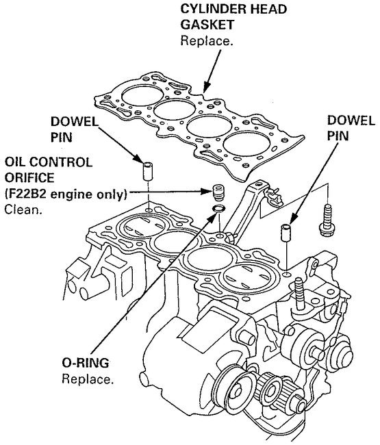

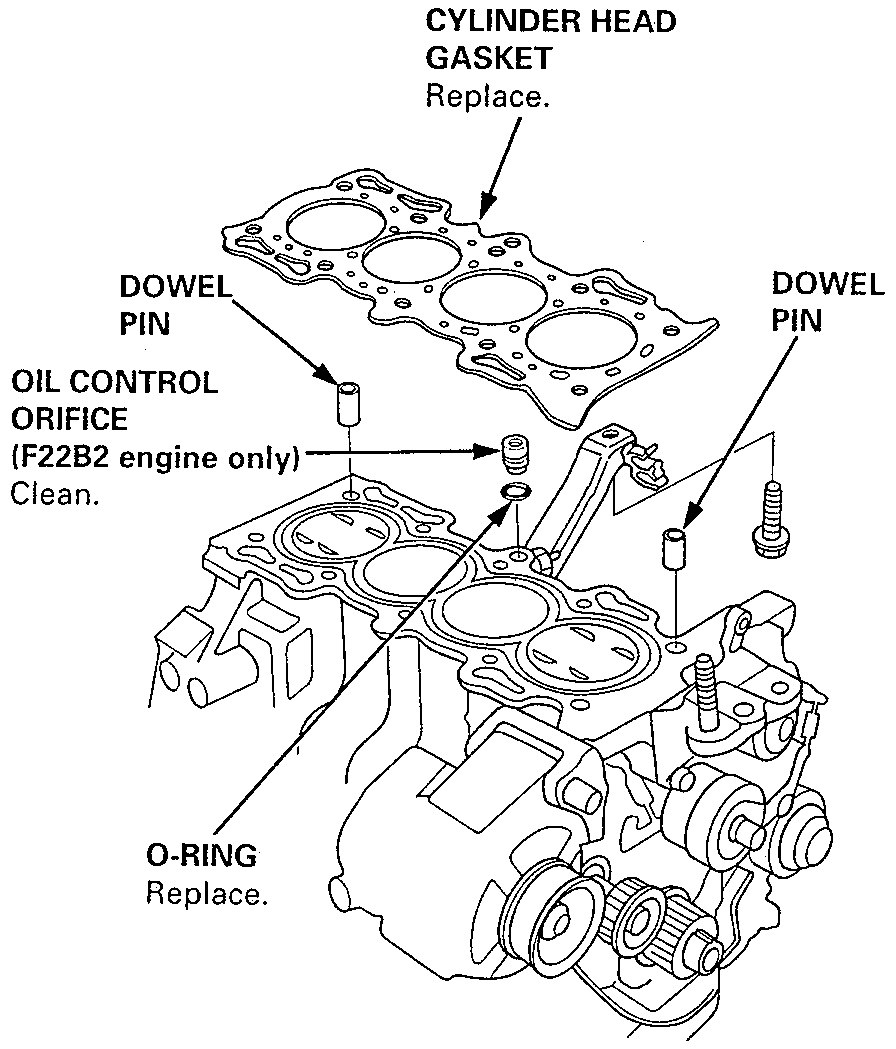

1. Cylinder head dowel pins must be aligned.
pic 14
2. Install the oil control orifice.

4. Tighten the cylinder head bolts sequentially in three steps.
^ 1st step torque: 39 Nm (29 ft. lbs.)
^ 2nd step torque: 69 Nm (51 ft. lbs.)
^ 3rd step torque: 98.1 Nm (72.3 ft. lbs.)
NOTE:
^ We recommend using a beam-type torque wrench. When using a preset-type torque wrench, be sure to tighten slowly and not to over-tighten.
- If a bolt makes any noise while you are torquing it, loosen the bolt, and re-tighten it from the 1st step.

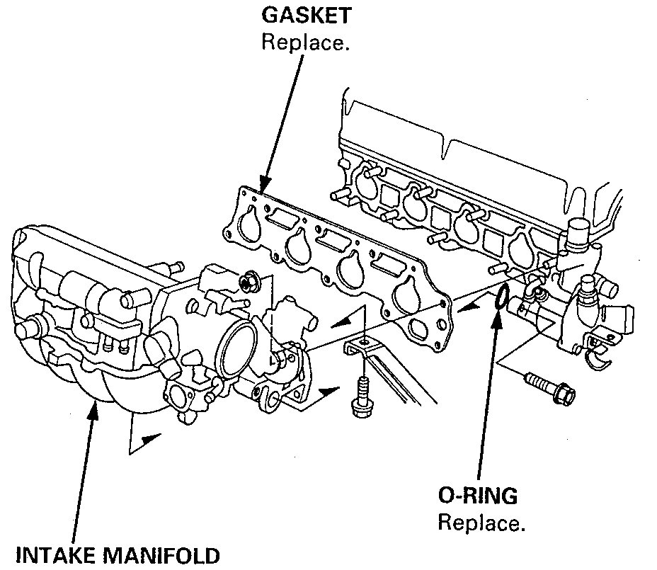

5. Install the intake manifold and tighten the nuts in a crisscross pattern in 2 or 3 steps, beginning with the inner nuts.
^ Always use a new intake manifold gasket.
6. Install the exhaust manifold and tighten the nuts in a crisscross pattern in 2 or 3 steps, beginning with the inner nut.
^ Always use a new exhaust manifold gasket.
pic 17

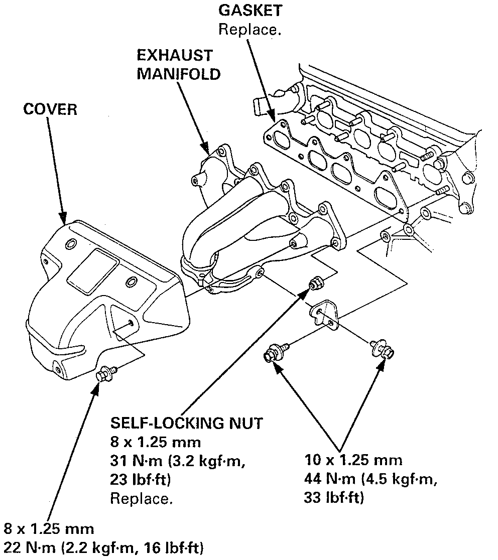

7. Install the exhaust manifold bracket, then install the exhaust pipe A and the bracket, and then install the cover.

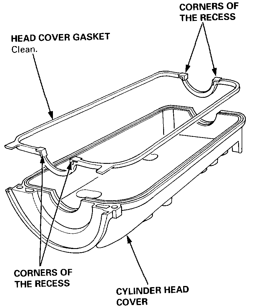

10. Install the head cover gasket in the groove of the cylinder head cover. Seat the recesses for the camshaft first, then work it into the groove around the outside edges.
NOTE:
^ Before installing the head cover gasket, thoroughly clean the seal and the groove.
^ When installing, make sure the head cover gasket is seated securely in the corners of the recesses with no gap.

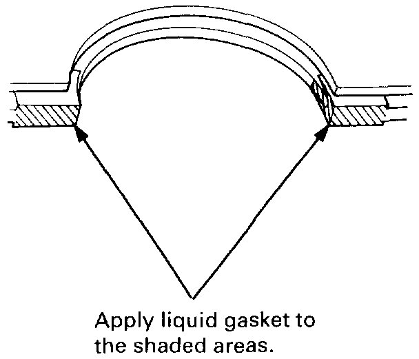

11. Apply liquid gasket to the head cover gasket at the four corners of the recesses.
NOTE:
^ Use liquid gasket, Part No. 08718-0001, or equivalent.
^ Check that the mating surfaces are clean and dry before applying liquid gasket.
^ Do not install the parts if 5 minutes or more have elapsed since applying liquid gasket. Instead, reapply liquid gasket after removing old residue.
^ After assembly, wait at least 20 minutes before filling the engine with oil.
pic 20

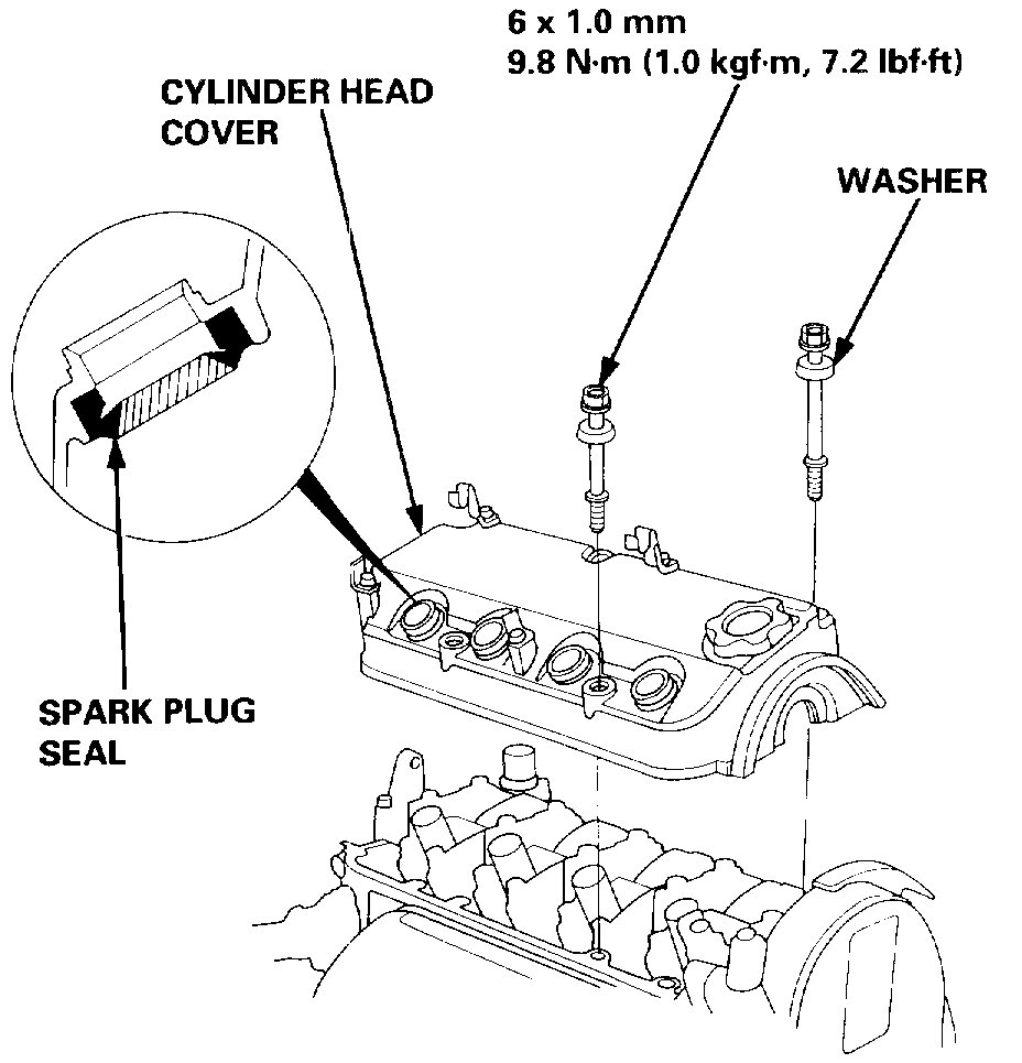

12. When installing the cylinder head cover, hold the head cover gasket in the groove by placing your fingers on the camshaft contacting surfaces (top of the semicircles).
^ Once the cylinder head cover is on the cylinder head, slide the cover slightly back and forth to seat the head cover gasket.
NOTE:
^ Before installing the cylinder head cover, clean the cylinder head contacting surfaces with a shop towel.
^ Do not touch the parts where liquid gasket was applied.
^ Replace the washer when damaged or deteriorated.

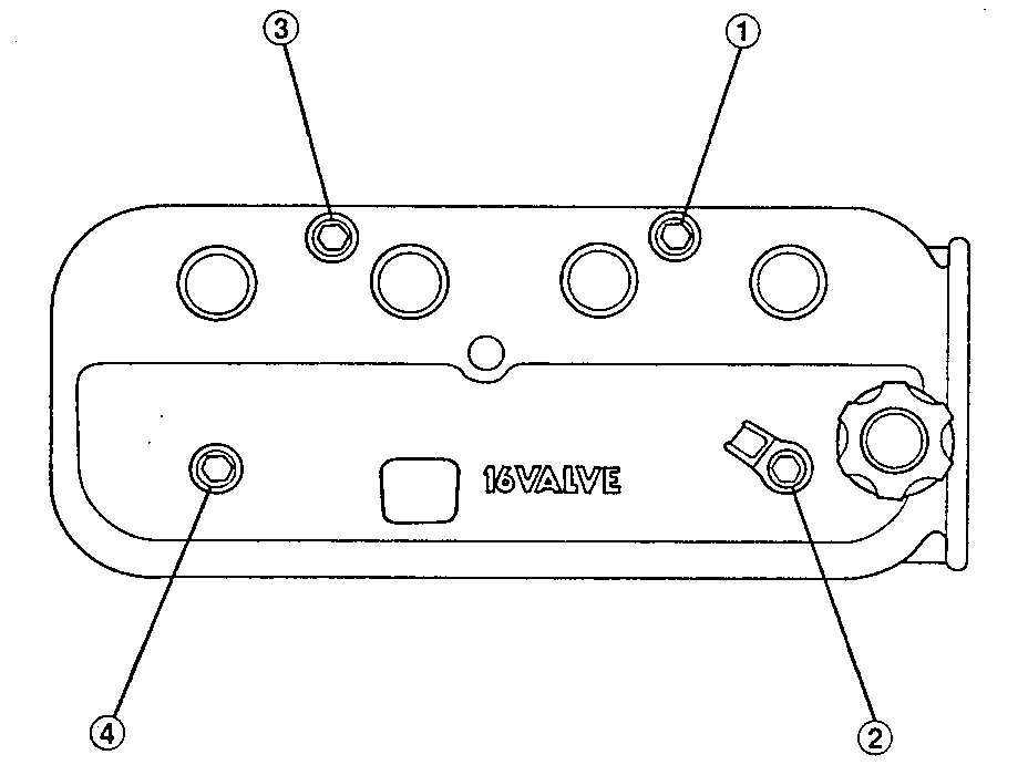

pic 21
13. Tighten the nuts in 2 or 3 steps. In the final step, tighten all nuts, in sequence, to 9.8 Nm (7.2 ft. lbs.).
