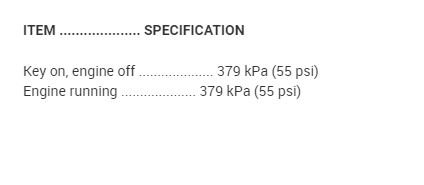

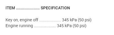

Fuel psi 20 to 30 psi,no spark and no movement on track. Sorry for late response it was a rainy day here in Florida. what's the next step you would like me to take?
Apr 17, 2020 at 12:19 AM
Okay, the pressure is no good. It needs 50 pounds. That is why it will not start.
You will need to replace the fuel pump.

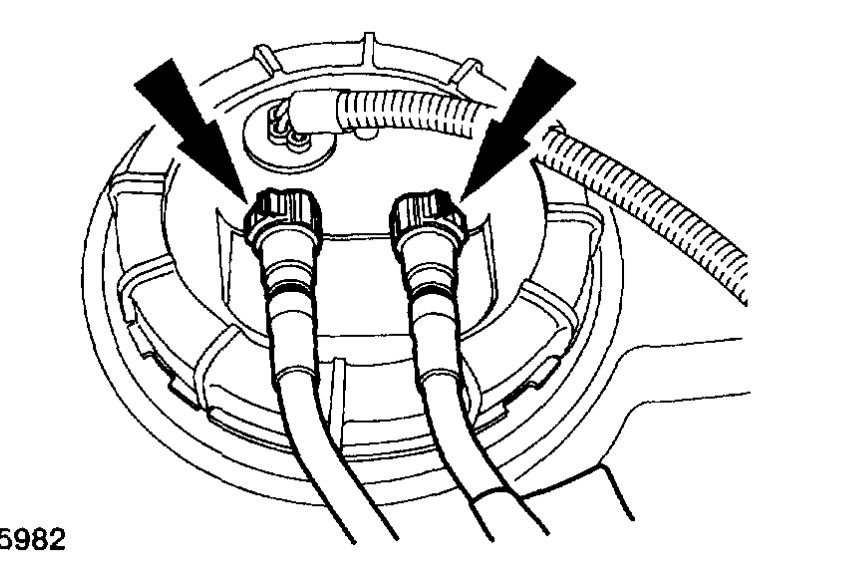

https://www.2carpros.com/articles/how-to-replace-an-electric-fuel-pump
REMOVAL
WARNING:
Do not smoke, carry lighted tobacco or open flame of any type when working on or near any fuel-related component. Highly flammable mixtures are always present and can be ignited, resulting in possible personal injury.
Fuel in the fuel system remains under high pressure even when the engine is not running. Before servicing or disconnecting any of the fuel lines or fuel system components, the fuel system pressure must be relieved to prevent accidental spraying of fuel, causing personal injury or a fire hazard.
1. Remove the fuel tank.
2. Disconnect the quick release fittings from the fuel pump.
3. Using the special tool, remove the fuel pump lock ring.
4. CAUTION: Carefully remove the fuel pump assembly to avoid damaging the fuel level sensor.
Remove the fuel pump assembly.
5. CAUTION: Note the location of the fuel pump alignment tabs.
Remove the O-ring.
6. Remove the fuel level sensor.
INSTALLATION
1. To install, reverse the removal procedure.
