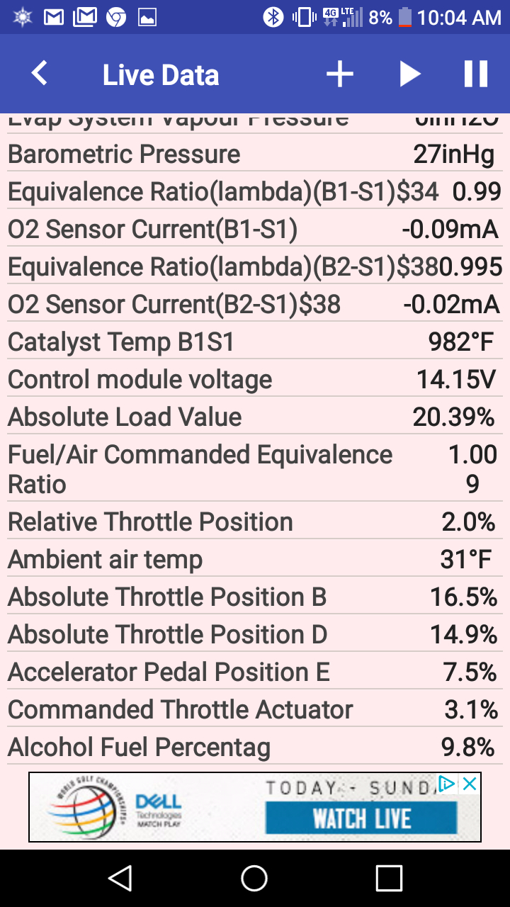

Okay, I forgot to mention in my previous post that I had the battery inside on the charger. I put it back in the car. Checked code reader wad showing an ABS code p1711 I think. That was under the ABS check on the Ford app. But said system pass on OBD fault scan. So I pressed the brake pushed the start button fired up on the first try. This is like the third time this has happened. Randomly wont start and exactly three days later fires right up. So I have spark fuel and air because it is running right now as i type. I still have no clue what is causing it. Battery? All three times was either jump started and this one being on the charger over night.

It was running anywhere from 13.2 to 14.6 depending on the engine load. Engine load was at 20-29% during that time.

Should be constant 14 to 14.5.
