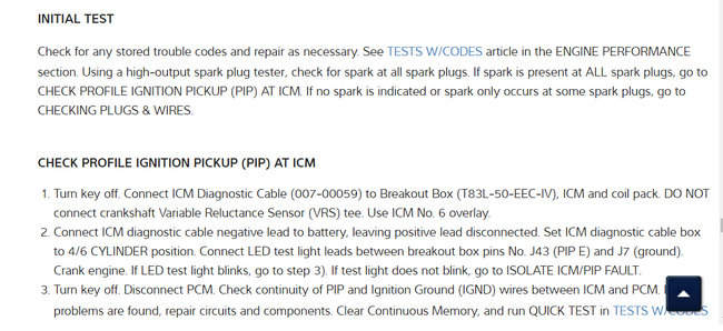

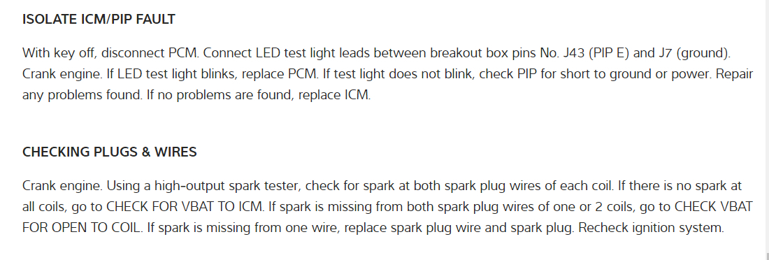

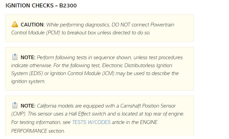

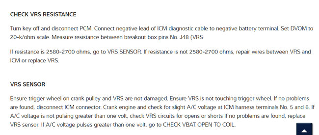

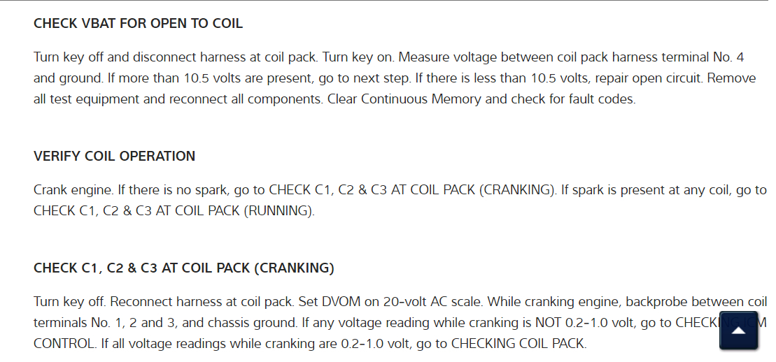

Truck will crank but not start. fuel pump works but not getting any spark. I have replaced crankshaft sensor, both coil packs, plugs and wires, ignition control module. It is not registering rpm when trying to start and the check engine light does not come on when I turn key to accessory.
Sep 18, 2019 at 4:40 PM

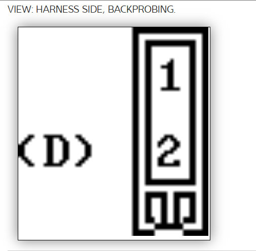

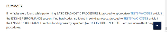

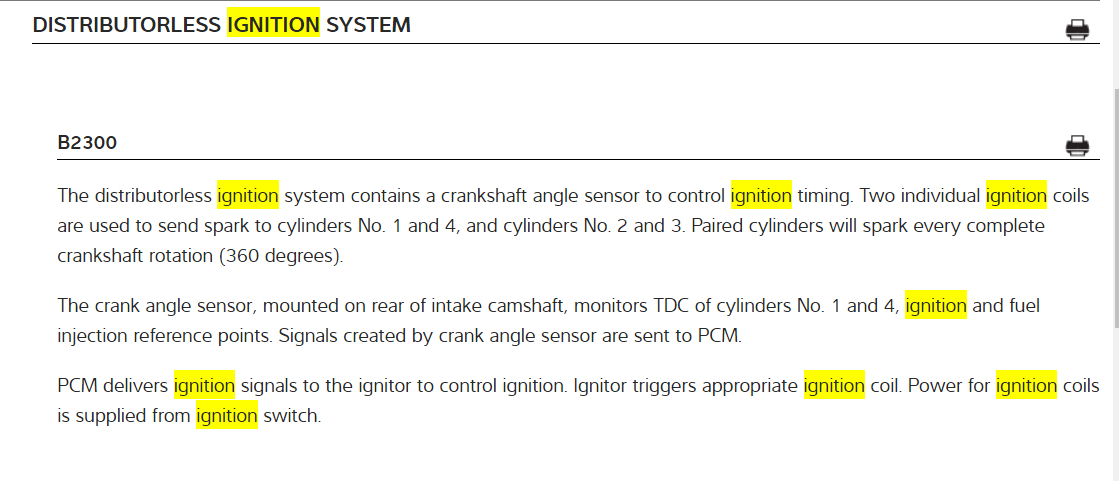

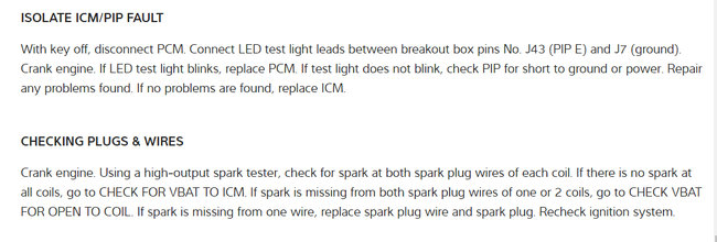

SCGRANTURISMO
  • 4,897 POSTS

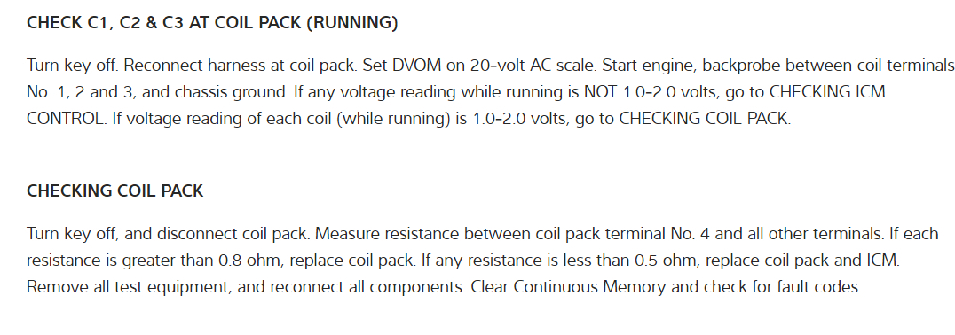

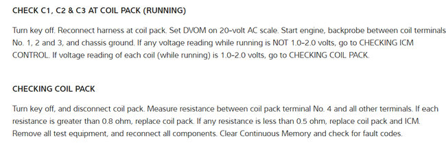

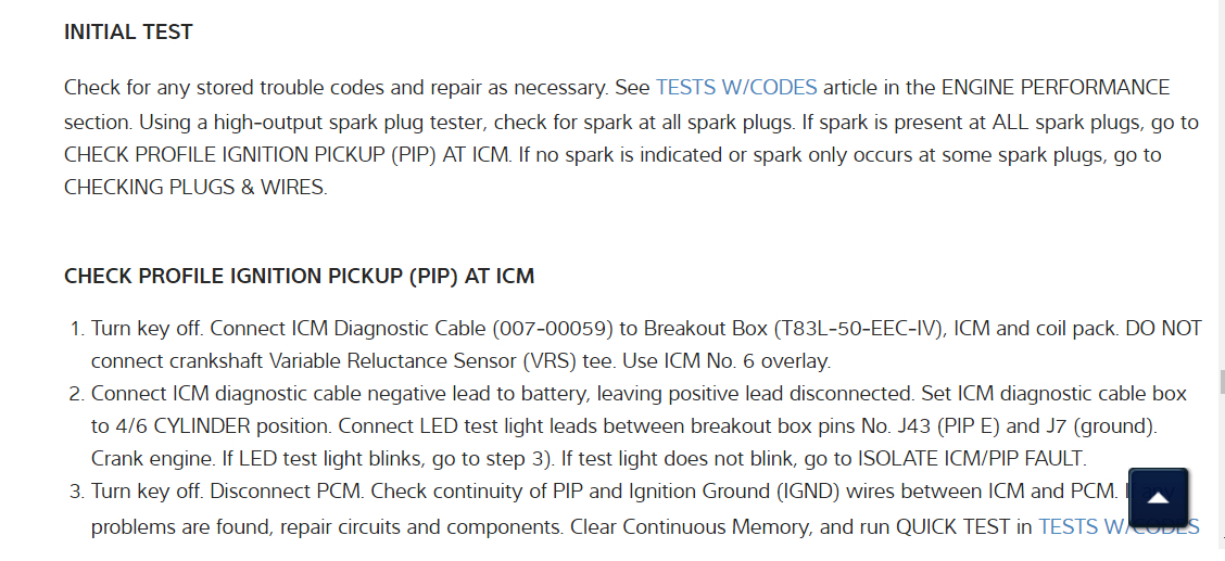

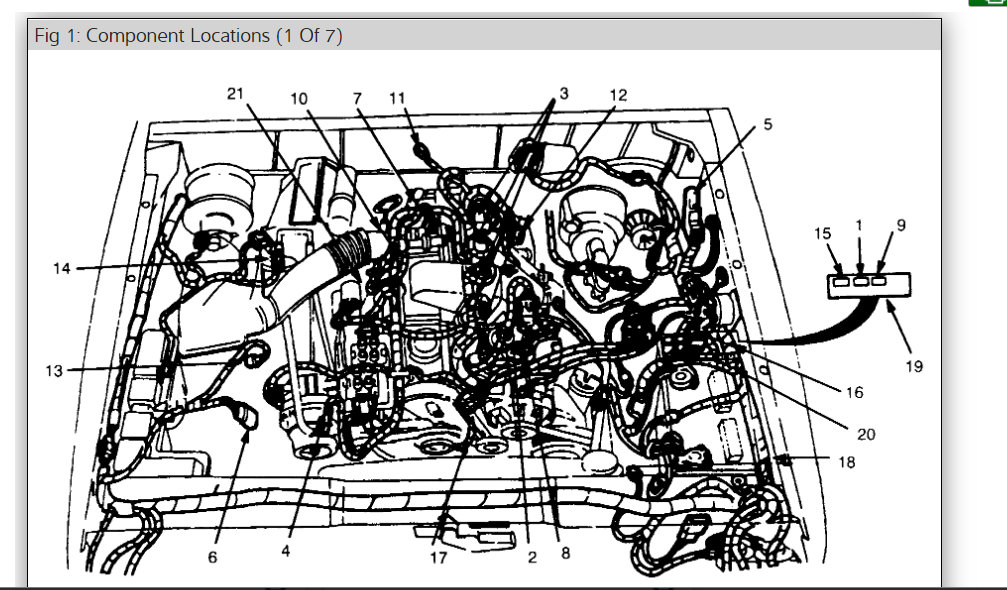

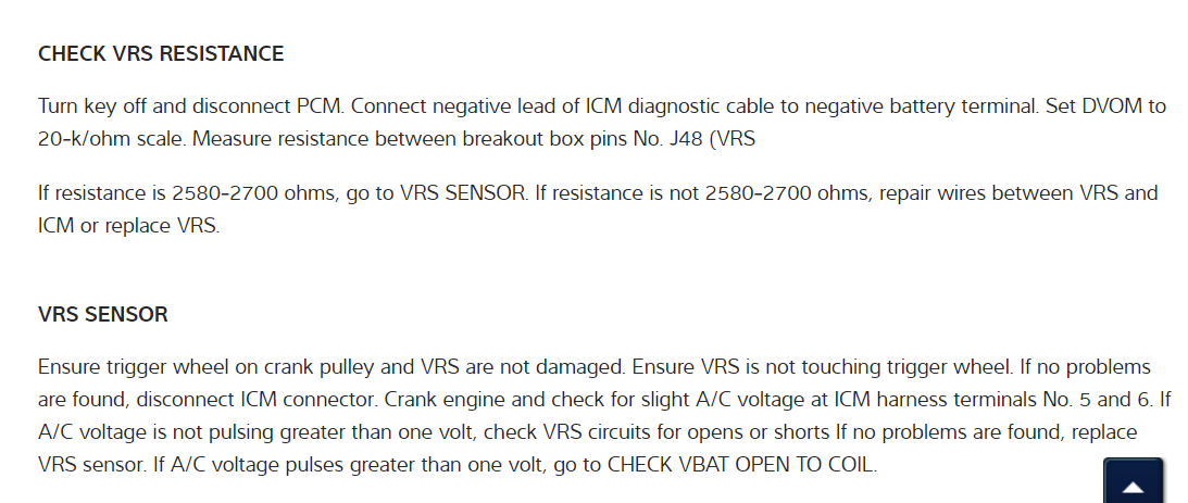

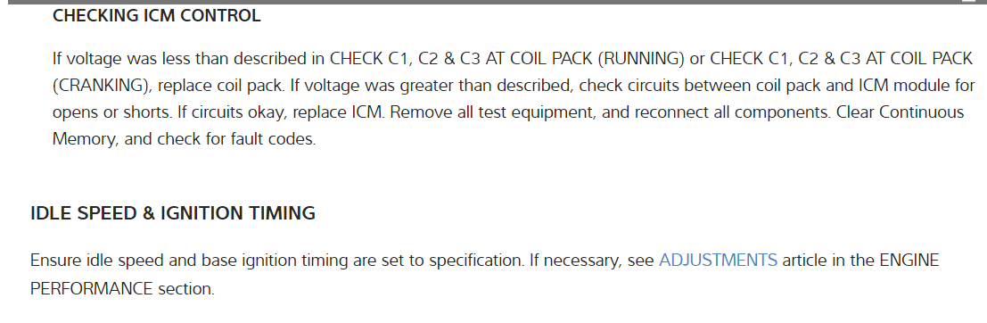

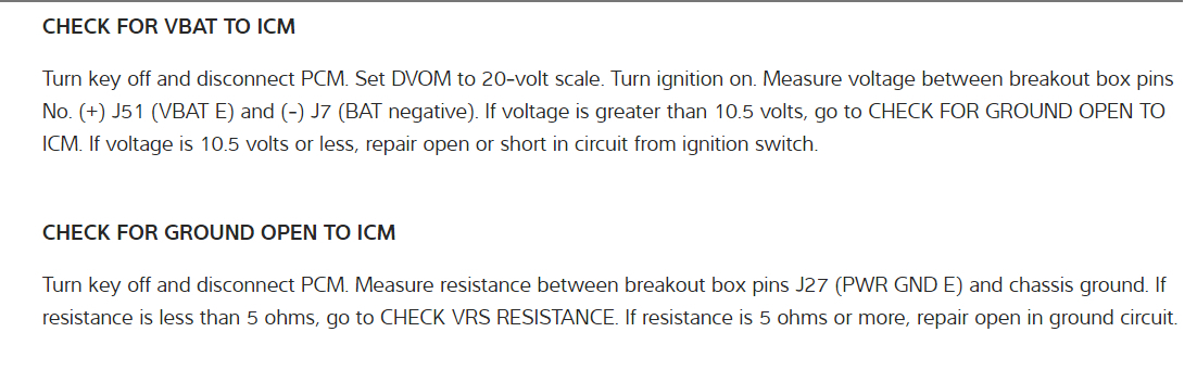

In the diagrams down below I have included the vehicle manufacturers diagnostic factory troubleshooting guide for your vehicle's ignition system. It does call for the use of a breakout box, which is available for purchase on Ebay or Amazon. Please go through the guide and get back to us with what you are able to find out.
Here is a guide that can help as well
Thanks,
Alex

Here is an update: I now have spark apparently when I installed the first crankshaft position sensor I had sheared the magnet off the sensor so now I have spark fuel pressure is around 20 psi. when I turn the key but truck will not start inertia switch seems to be working properly. ir is now registering rpm's when I try to crank but check engine light never comes on.

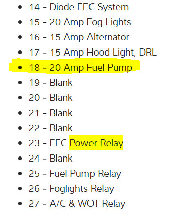

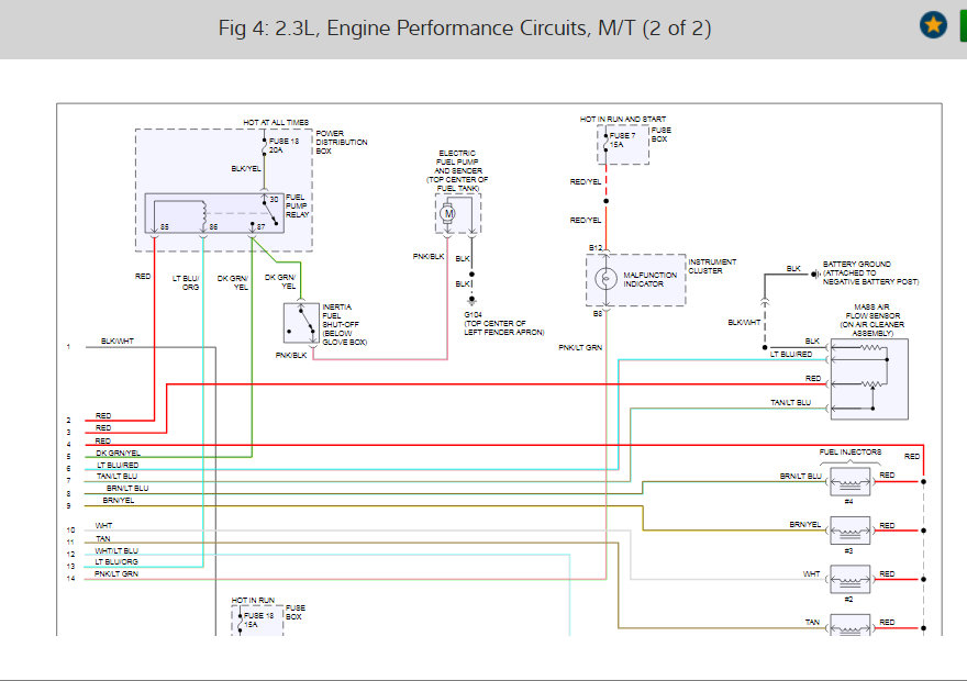

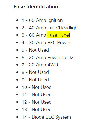

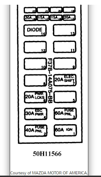

SCGRANTURISMO
  • 4,897 POSTS
Hello again,

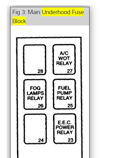

Could you please check Fuse #18(20A) in the Under hood Fuse Block in your vehicle. This is the fuse that powers your vehicle's fuel pump. In the diagrams down below I have included a wiring diagram of your vehicle's fuel pump circuit for reference as well as a diagram and callout for the Under hood Fuse Block of your vehicle for you. Here is a link on how to check a fuse, if needed, for you as well:
Please go through these guides and get back to us with what you are able to find out.

ERDACK
  • 7 POSTS
I have checked that fuse and it is good. I broke down and called a mobile mechanic and he hooked his snap on computer to the truck checked injectors with a kit and several other things he told me that every thing seems to be working as it should but there is some water in the gas and suggested that I empty the gas tank exchange my fuel pump for a new one just in case and replace the fuel filter with a new one. Does this sound accurate as far as you can tell? The amount of water that was in the gas as best as I can describe was about 1/8th inch of clear fluid settled to the bottom of a 20 oz bottle of gas. I know the fuel pressure koeo at the rail is within spec for the pump around 40 psi. Do I need to exchange my new pump for another one or should I just empty gas and replace the in line fuel filter. Refill with good gas? The mechanic that did the diagnostic claimed that if it did not work he would come back out for free also that he is 99.9% sure that the gas is my problem.
Sep 30, 2019 at 6:05 AM
SCGRANTURISMO
  • 4,897 POSTS
Hello again,
Yes it does. That is the reason I was having you check the fuse. It sounded like a fuel related issue to me. That is why you could start your vehicle and keep it running with starting fluid. I was checking and making sure that your vehicle's fuel pump was working.

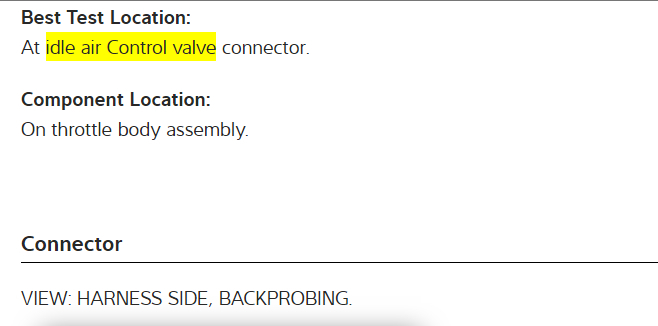

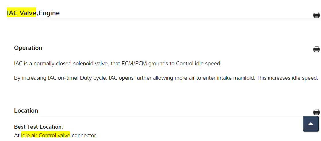

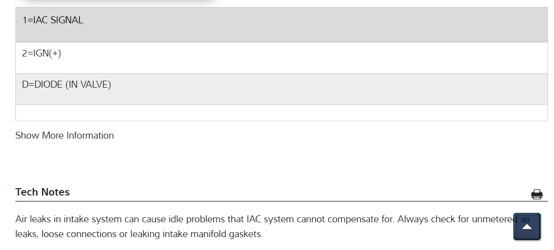

Okay, now here is another update. I emptied gas, cleaned tank out, replaced fuel pump, and filter. truck still will not start. new plugs wires and coil packs, checked injectors they seem good. I am getting fuel pressure truck seems like it wants to start but it will not stay running. the inertia switch looks fine, it has not been tripped. I pushed the button up then back down just in case. If the inertia switch is bad will the fuel pump prime at all? The pump is working for koeo prime I know for a fact so I'm not sure where to go from here.
Oct 7, 2019 at 9:20 AM

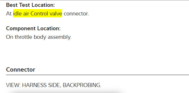

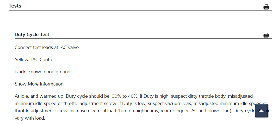

SCGRANTURISMO
  • 4,897 POSTS

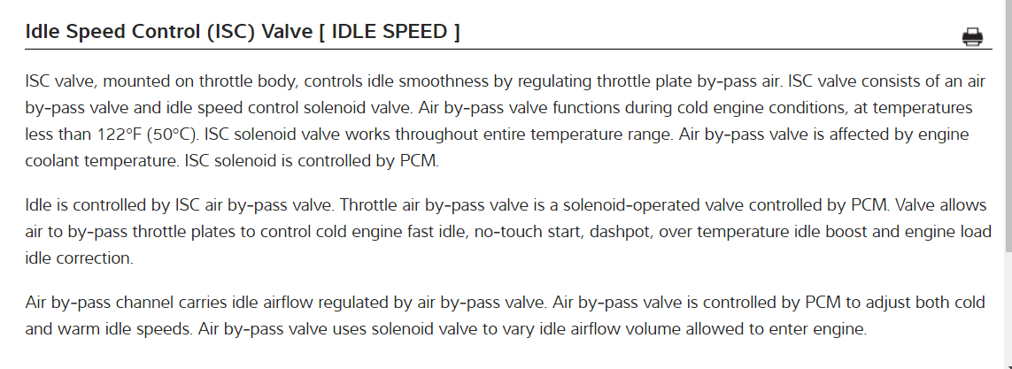

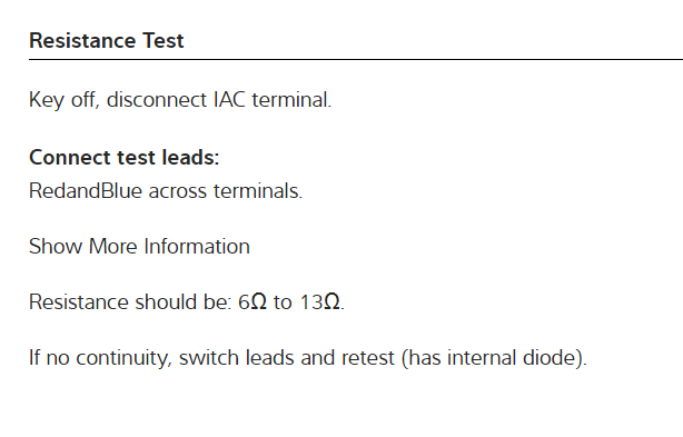

Hello again,

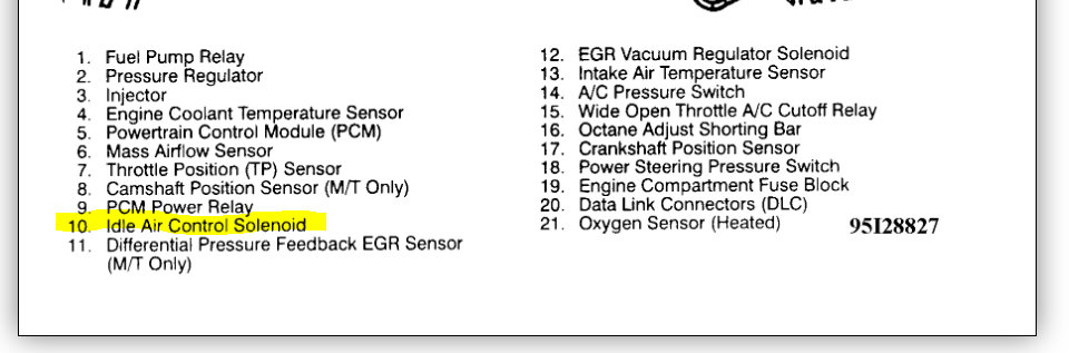

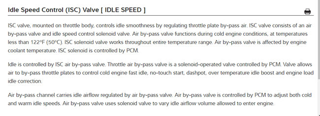

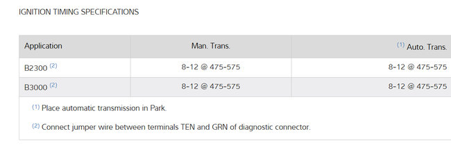

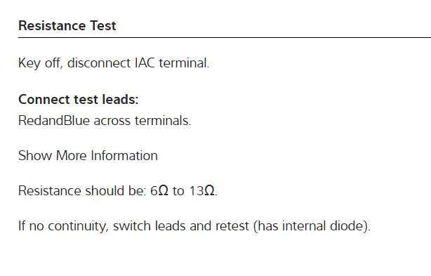

Okay, this could be a problem with your vehicle's Idle Air Control(IAC) valve. It let's air bypass the closed throttle plate at idle to keep your engine running. Here is a link for a generic guide on a IAC below.
https://www.2carpros.com/articles/how-to-replace-an-idle-speed-control-motor-iac
In the diagrams down below I have included the IAC location, testing, and how it operates specifically for your vehicle. Please go through these guides and get back to us with what you find out.
