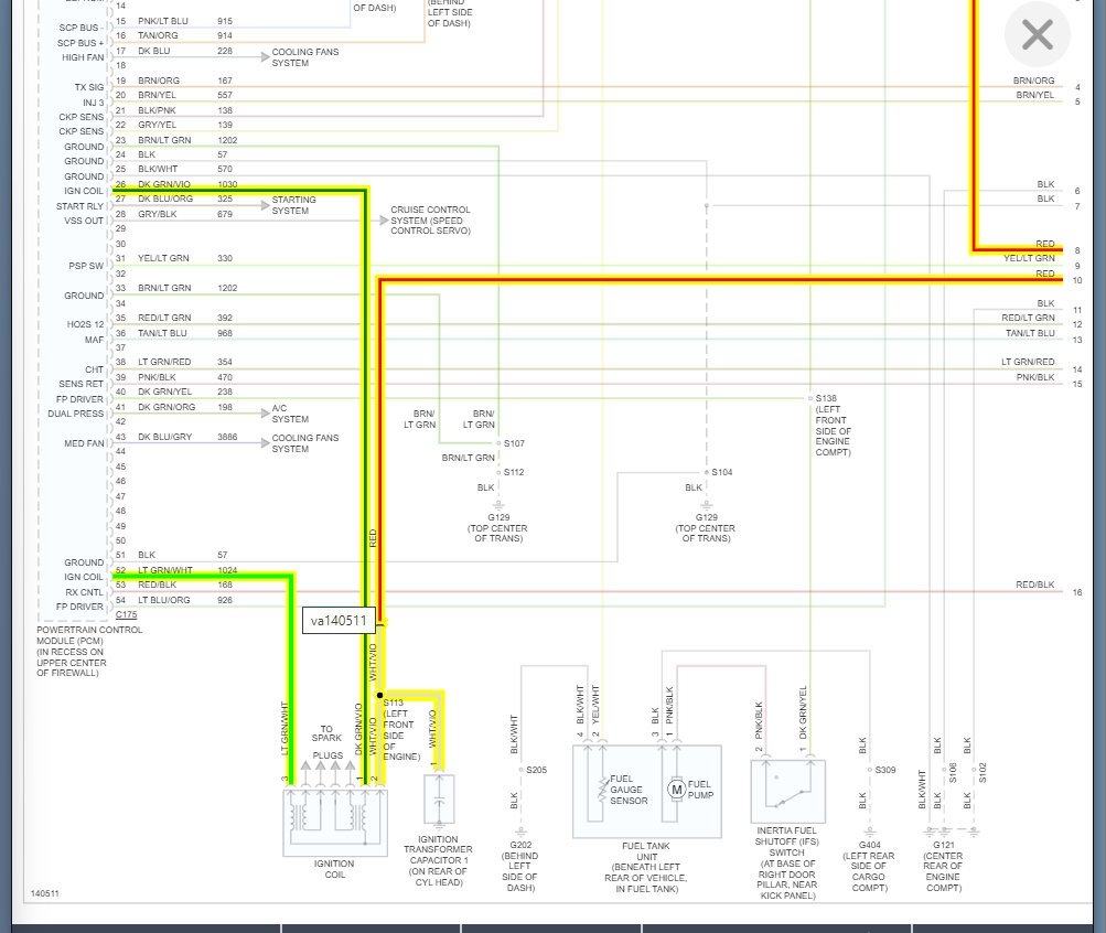

I have the car listed above with a 2.0 Zetec engine. I've recently changed the engine and I am getting a crank signal but I'm not getting an RPM signal and I am not getting fire to the spark plugs. how to change the PCM and still the same problem is occurring anybody have an idea what may be going on? like I said I have a crank signal because the check engine light turns out whenever I crank it over, but I'm not receiving RPMs and that's kind of strange.

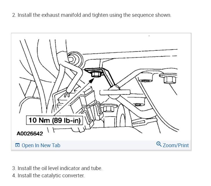

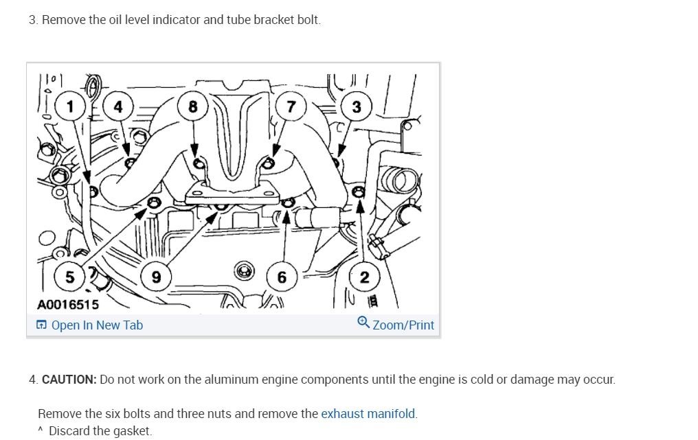

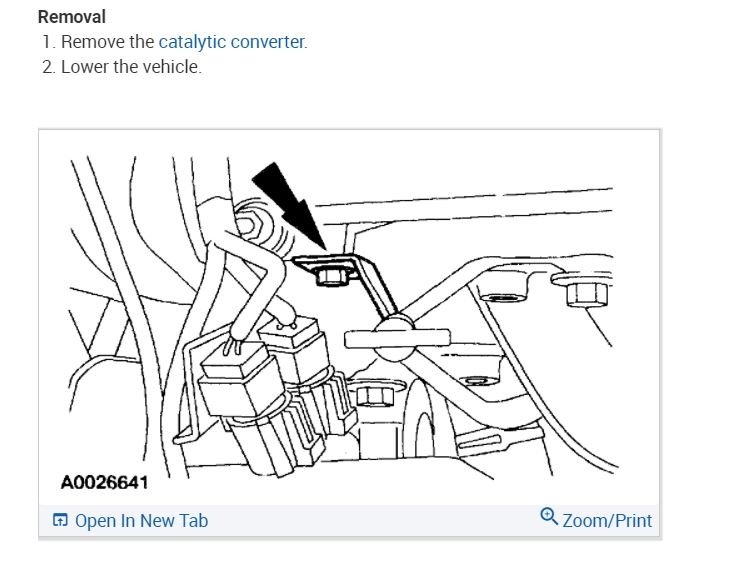

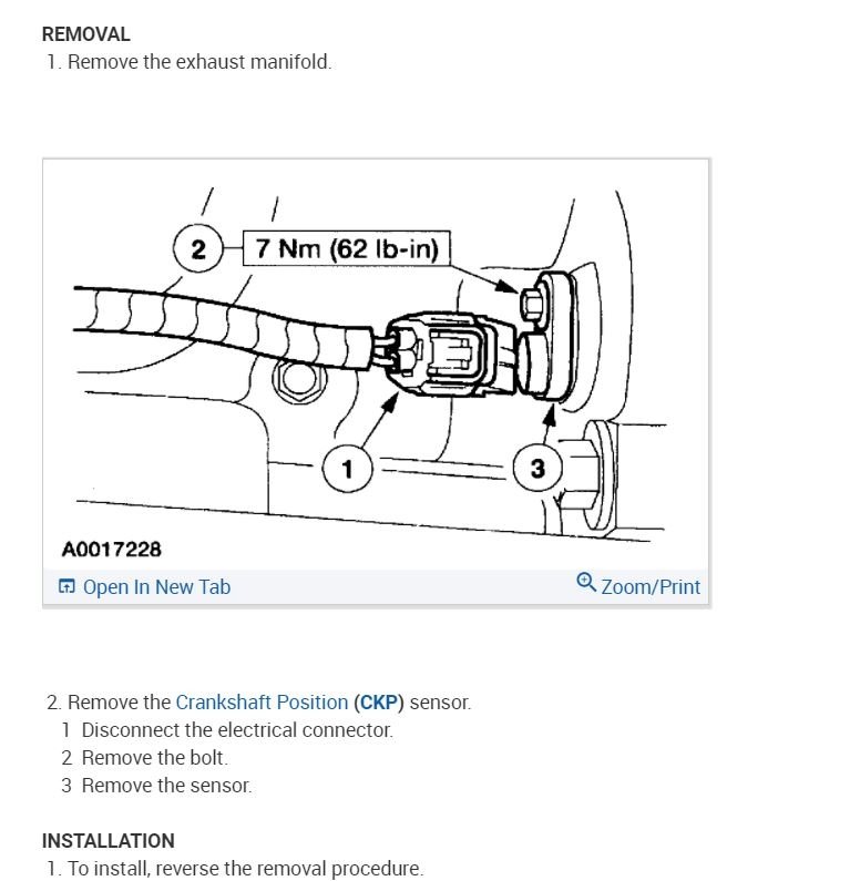

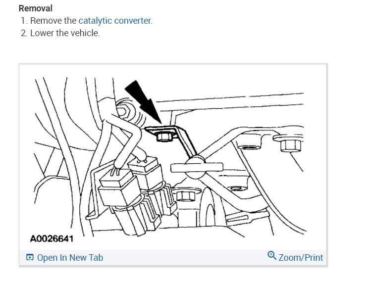

If you have no RPM signal, then your crank sensor is not sending a signal.
https://www.2carpros.com/articles/car-not-running-advanced
I would start with a crank sensor to be sure.
I attached the procedure below for you of the repair.
Let us know if you have any other questions.

I should have mentioned that I have replaced both crank and cam sensors and both are getting power as well as the injectors. What other sensors can i check that would keep the coil pack from firing? Have a new coil and get power to it. And have replaced PCM.

Just to jump in on this could be a harness issue.
However, I would suggest we start by finding out what the voltage readings are at the coil when you are cranking the engine.
Basically, if you have replaced the PCM and coil we can assume there is something preventing the coil from firing, but it may not be the PCM.
Here is a guide that will help with checking the voltage:
I am specifically interested in the red wire coming from the relays. Basically, this wire is fed by the fuel pump relay which feeds the PCM power relay.
If we don't have power on this wire, then one of these relays could be the issue or one of the fuses feeding these relays.
Let us know what you have on each of these wires, and we can go from there. Thanks

Hey Ken, so I get 12 volts to the coil on the middle wire, but no spark. now I was getting a crank signal because the check engine light was turning off when I crank it, but since I did some testing the other day and took the wires at the crank sensor off to test a crank sensor which I get 1.5 volts whenever it's turned over. now the check engine light goes out for about 3 seconds then comes back on while I'm cranking it and I still get no RPM signal and it test the crank signal at the two wires that come off the crank sensor that go into the harness, but on the other side to the PCM. i don't get anything in the strangest thing is I have continuity on both wires all the way to the PCM. I'm leaning more towards a wiring harness but it's going to be hard to find one because this is not only the 2.0 zetec engine, it's also a manual transmission which is very rare. What I'm wondering is would a Mazda Tribute harness or a Ford Focus harness that was manual transmission on either one of those would that work also on a Ford escape with that zetec engine? I've checked every junkyard around here and Salvage yard in Houston and nobody has one nobody even has a manual transmission 2.0 zetec so either I'm going to have to get another engine and use that wiring harness from it from a Ford Focus or Mazda Tribute.
Feb 17, 2022 at 8:50 PM
Okay. One more follow up just to be sure but I think you are confirming this.
You have 12 volts going to the coil on pin 2. What do you have on pin 3 the light green wire? The other wire is what interrupts the low voltage to create the high voltage spike. However, the PCM controls the coil on the light green wire. So, you can put your meter across pin 2 and 3 and it should be 12 volts.
If it does then I agree it sounds like a harness issue and I totally understand the issue of finding one.
