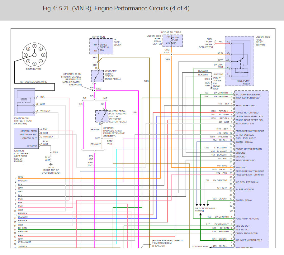

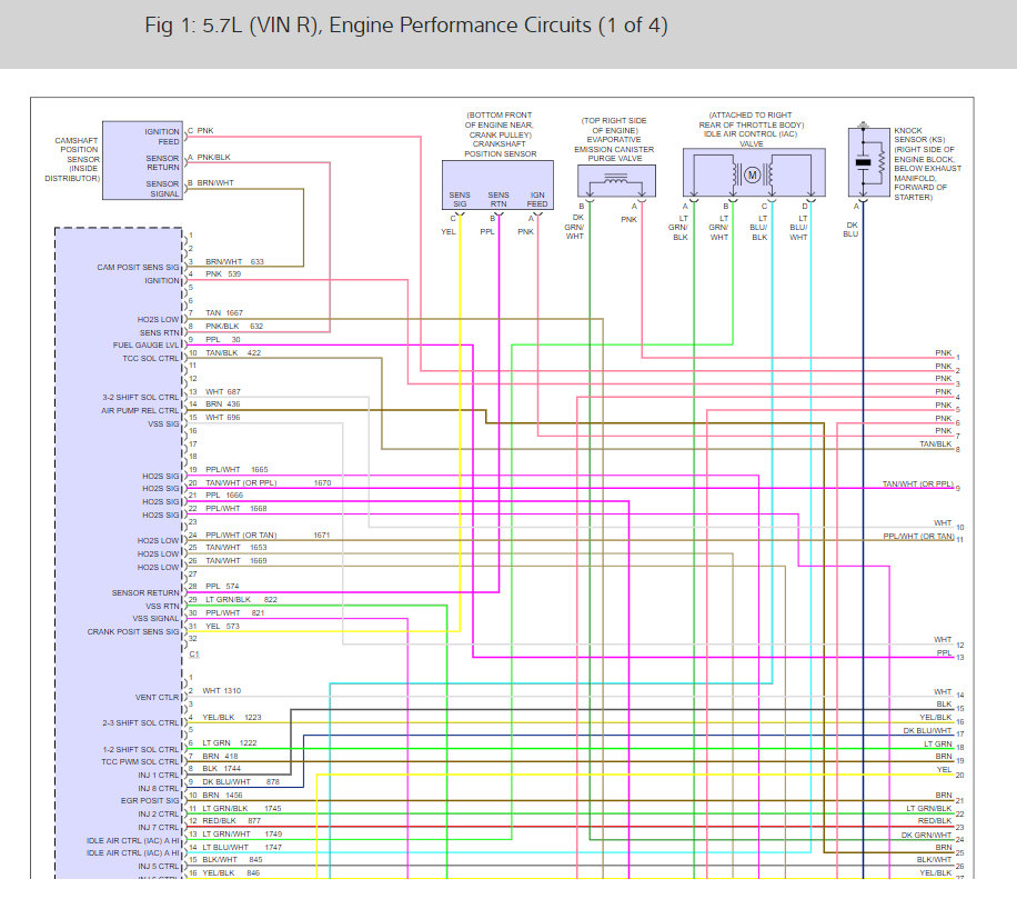

Really could use some help with this one. My C2500 5.7 Vortec. 340,000 miles, I was driving home from work truck running perfect. Without notice the engine shuts down, I drift off the road and tried to restart.. No go.
I cycled the key and did hear the fuel pump prime up, The pump is one year old. So the engine cranks but no start.
Well still no spark, compression is good. Replaced crank,hall(distributor),coil, and ignition module, rotor and cap. I replaced the ECM, on the L/S engine compartment. Pulled number One plug, rotated engine until mark lined up on timing cover with mark on Harmonic balancer. Pulled Dist. cap and saw rotor is pointing to #1. I have 12 volts going to each sensor, and a good ground, I could not find the 5 volts at the sensors when key is in the "run" position. There are and were no "CEL" at anytime during the drive when it cut off and still there are none. I used a "GM Tech 2" scanner and no codes where present. I am thinking a jumped timing chain, thinking that would misaligned the crank sensor and the wheel, never sensing the timing spot on to firing the cylinders. I am lost with this one. Can anyone help out. Thanks in advance.

Thanks for that information, but I have done all of that. Starting fluid, no go. Fuel pressure is 60+ fuel pump is ac delco.. no spark from anywhere. I am getting 12 volts to all components but no spark. As stated I have replaced all modules and sensors, cap rotor, distributor, with new sensor, and the computer

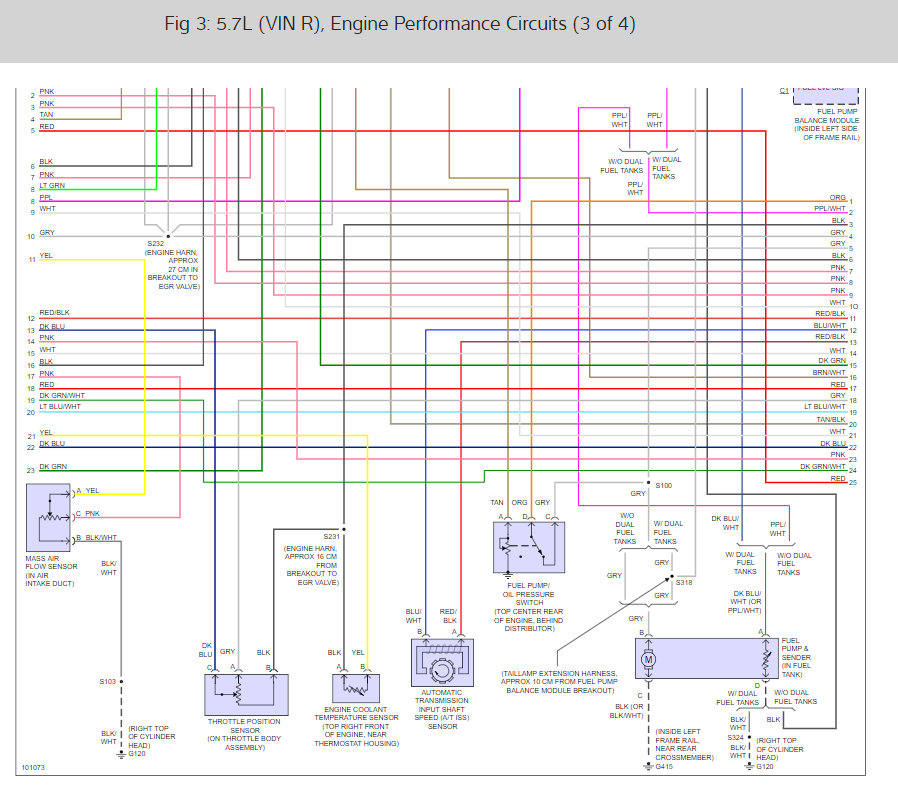

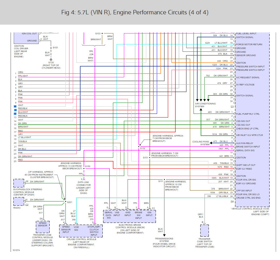

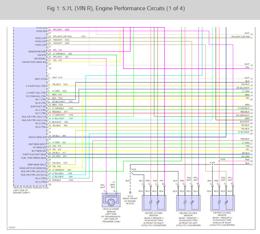

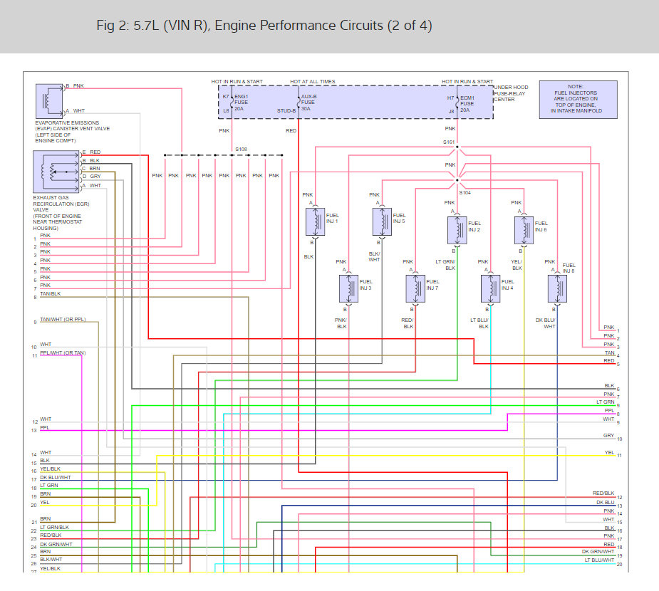

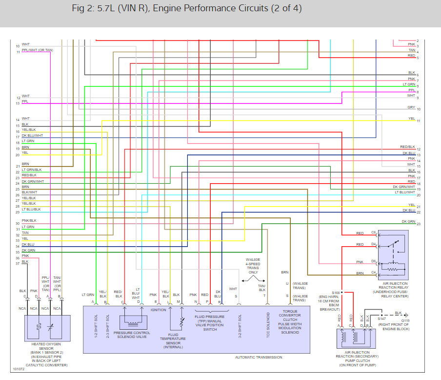

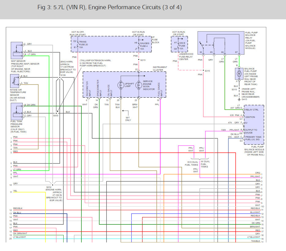

You check for spark coming out of the coil right not the plug wire? It sounds like you have a wiring issue. but to be sure here is a guide and the engine wiring diagrams to help us get started:
Make sure you have power at the ENG1 and ECM1 fuses.

I honestly do not know what to say. I purchased a new distributor, aluminum not plastic, and reinstalled the same new components that I had previously used. WTH.... it fired right up... SMDH. Scanned the truck ecm, and set timing, and reset some fuel injection specs. Running smoother than before. Again I have no idea why replacing the distributor with they aluminum instead of plastic made a difference but that’s what it was. Thanks to everyone that has helped and given me and input doing this problem.
