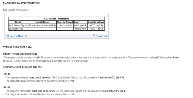

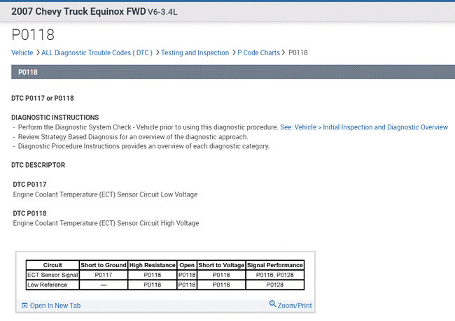

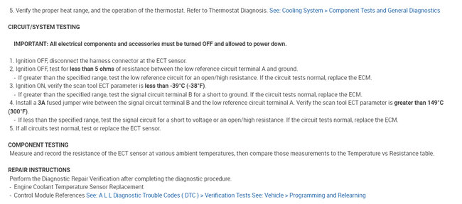

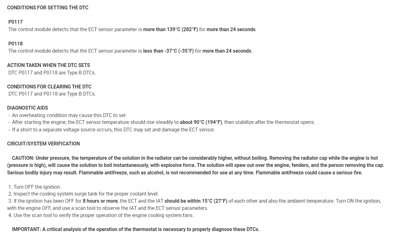

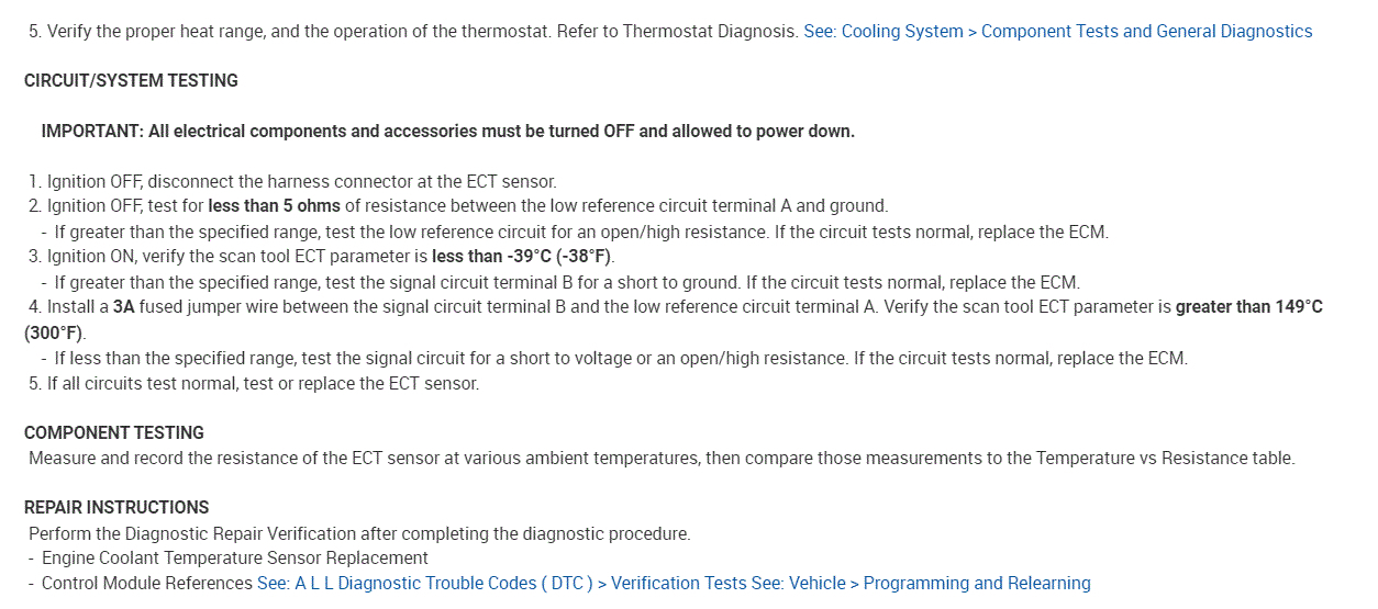

I have a feeling the best thing to try is flushing the radiator and the block. I attached the diagnostics below for the P0118. Take a look through them and let me know if you have questions.
See pic below.
