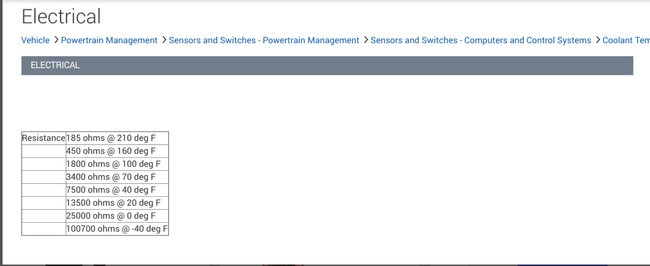

In the diagrams down below I have included a list of expected Ohm's of resistance that your ECT should have at varying coolant temperatures. This is another way to check to see if your vehicle's ECT is working or not. Please put your Digital Multi-meter[DMM] in Ohms Mode. It's the setting with the Omega symbol on it.
