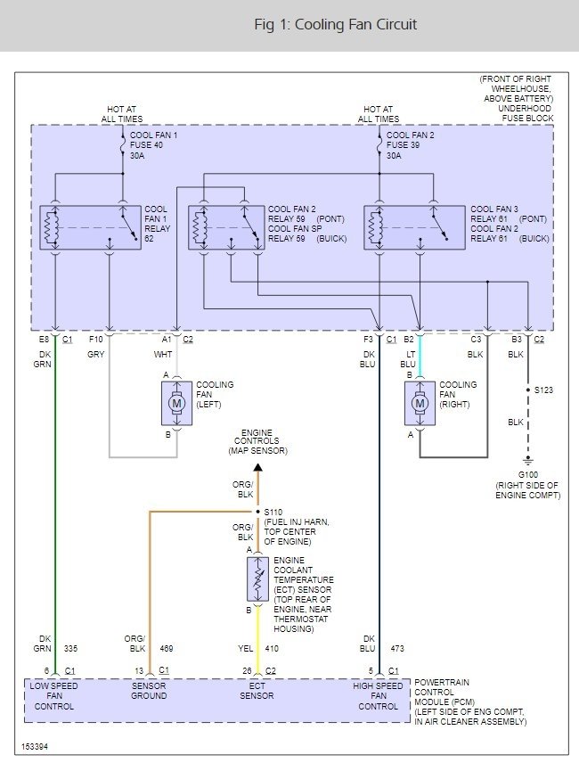

1) my high speed cooling fan does not turn on when driving or when I shut off the car and it starts to overheat.
2) I also looking for the location of the thermostat.
Friday, November 30th, 2018 AT 11:29 AM (Merged)
DOCFIXIT
  • 18,828 POSTS
With AC and if coolant rises above 220 deg. If AC is Auto maybe AC conroler telling PCM AC is on.
-1
KHLOW2008
  • 41,814 POSTS
Hi jolmo,
Thank you for the donation.
Are the fans operating at low speed conditions?
Have you checked the cooling Fan relay # 2 and # 3?

Here is a schematic of the cooling system. Check the fan relays 2 and 3.
https://www.2carpros.com/forum/automotive_pictures/192750_CoolingFan03RendezvousFig10a_1.jpg
https://www.2carpros.com/forum/automotive_pictures/192750_CoolingFan03RendezvousFig10b_1.jpg
+8

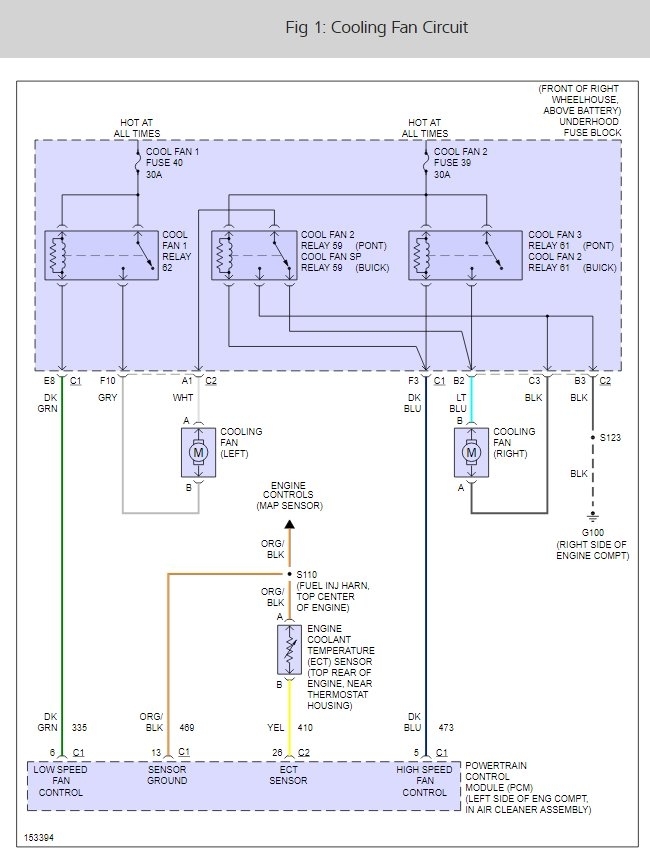

The fans not coming on I think its a common ground I have ground to the left side fan but not to the drivers side fan and no ground to drivers side window as well I have no wiring diagram any clues?
Friday, November 30th, 2018 AT 11:30 AM (Merged)
KEN L
  • MASTER CERTIFIED MECHANIC
  • 48,571 POSTS
I have found this cooling fan wiring diagram (below) for you and a guide to help you get the problem fixed.
and
Please run some tests and get back to us so we can continue helping you.

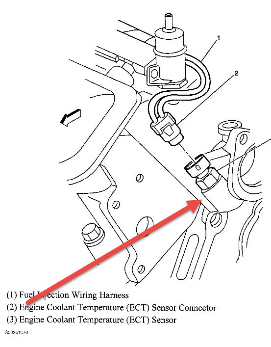

At idle engine temperature hits just above half way fans do not come on at all. Wired direct runs normal temperature. I was needing to know if and where the fan control sensor is located? Oh, it has new head gaskets water pump thermostat and radiator, before anyone asks. Lol.
HMAC300
  • 48,601 POSTS
The engine coolant temperature sensor tells PCM when to put fans on check fuse and relay in under hood fuse box. But you did not put engine size so we cannot tell you where it is.
JAMES GILLIS
I am sorry it is a 3.4 liter V6.
HMAC300
  • 48,601 POSTS
It is by the thermostat housing on drivers side rear of engine. See picture.
