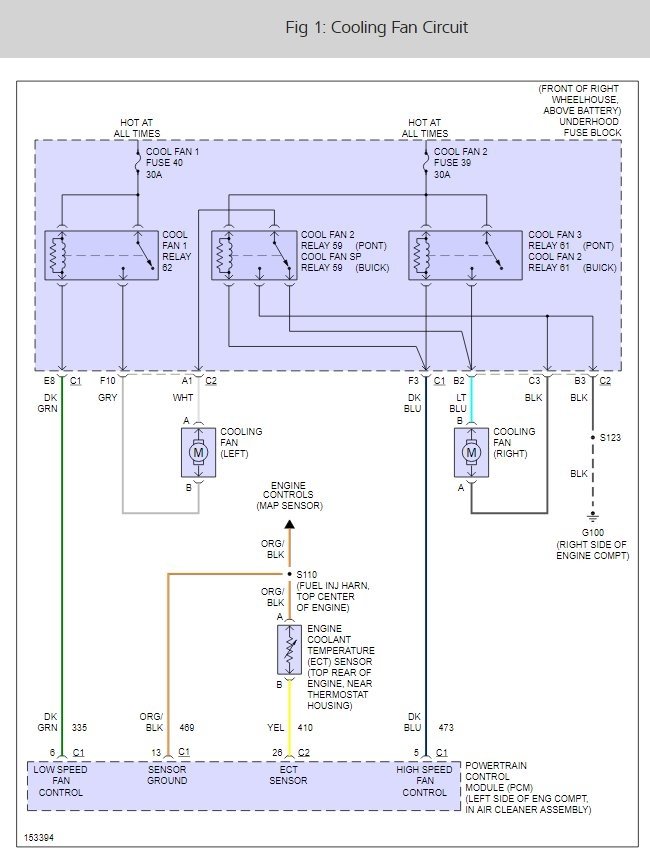

It sounds like the PCM is not triggering the high speed relay can you use a test light to see if a trigger signal is being sent when the engine is hot? Use the wiring diagram above and this guide.
Please run this test and get back to us so we can continue helping you.

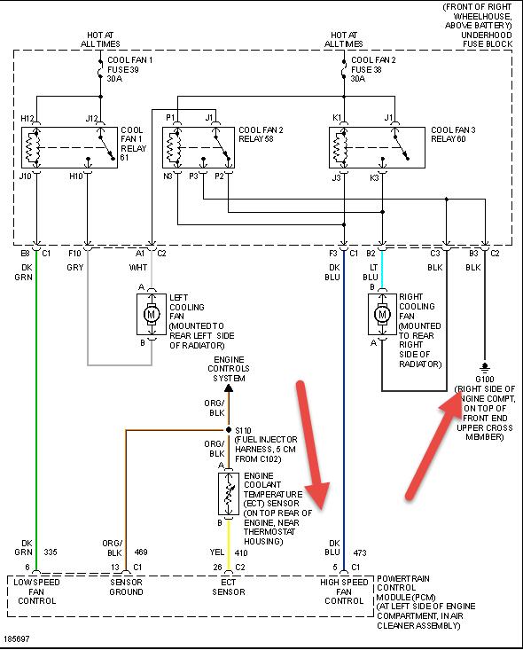

CANDACE NICHOLS
I have ground running to passenger side fan but no ground to drivers side fan or window. thinking it is a common ground or PCM is not grounding any clues? Also, I have no wiring diagrams to help. I believe the engine was swapped.
Nov 30, 2018 at 3:29 AM (Merged)
HMAC300
  • 48,601 POSTS
the main ground is on a stud at back of engine to transmission easy to spot. because of size I had to show diagram in two pictures. check all fuses, and relays ground is in center of engine. Also, check coolant temperature switch for resistance it may be bad. also is partial ECT sensor resistance, but you should get the idea on temperature etc.

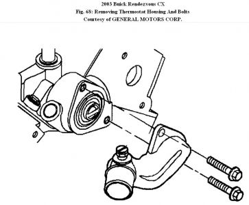

JOLMO
1) my high speed cooling fan does not turn on when driving or when I shut off the car and it starts to overheat.
2) I also looking for the location of the thermostat.
DOCFIXIT
  • 18,828 POSTS
With AC and if coolant rises above 220 deg. If AC is Auto maybe AC conroler telling PCM AC is on.
KHLOW2008
  • 41,814 POSTS
Hi jolmo, Thank you for the donation. Are the fans operating at low speed conditions? Have you checked the cooling Fan relay # 2 and # 3? Thermostat is located behind the housing of the outlet hose. WATER OUTLET HOUSING REPLACEMENT 1. Remove the air cleaner and duct assembly. 2. Drain the coolant until the coolant level is below the thermostat. 3. Remove the crossover exhaust pipe. 4. Remove the radiator hose from the thermostat housing. 5. Remove the thermostat housing bolts and clean any sealer from the bolt threads. 6. Remove the thermostat housing and gasket.
https://images.2carpros.com/forum/automotive_pictures/192750_Thermostat03RendezvousFig68_1.jpg
7. Remove the thermostat. 8. Clean the mating surfaces.

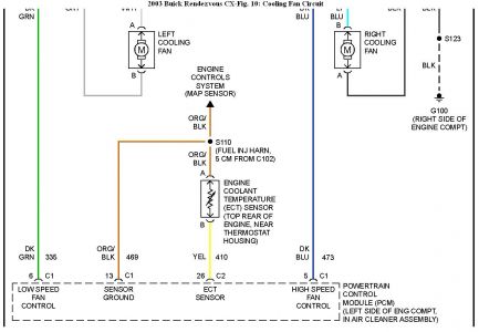

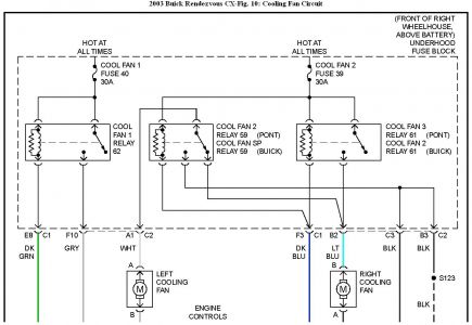

KHLOW2008
  • 41,814 POSTS

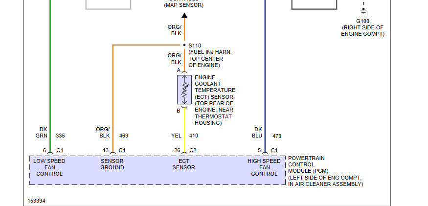

Here is a schematic of the cooling system. Check the fan relays 2 and 3.
https://images.2carpros.com/forum/automotive_pictures/192750_CoolingFan03RendezvousFig10a_1.jpg
https://images.2carpros.com/forum/automotive_pictures/192750_CoolingFan03RendezvousFig10b_1.jpg

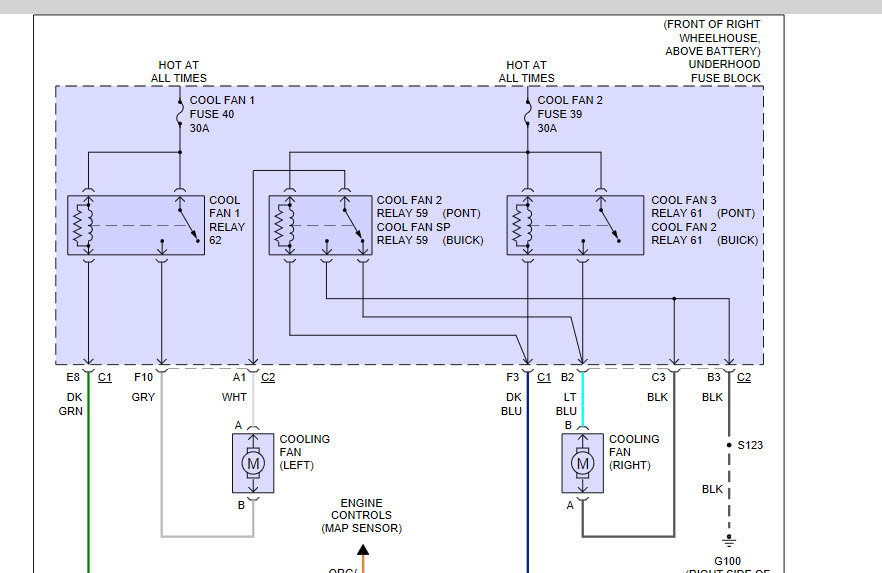

Nov 30, 2018 at 3:30 AM (Merged)
  • 55,399 POSTS
I have found this cooling fan wiring diagram (below) for you and a guide to help you get the problem fixed.
and
Please run some tests and get back to us so we can continue helping you.

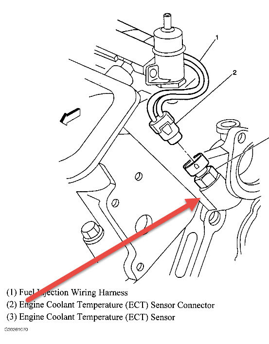

JAMES GILLIS
At idle engine temperature hits just above half way fans do not come on at all. wired direct runs normal temperature. I was needing to know if and where the fan control sensor is located? Oh, it has new head gaskets water pump thermostat and radiator, before anyone asks. lol.
HMAC300
  • 48,601 POSTS
the engine coolant temperature sensor tells PCM when to put fans on check fuse and relay in under hood fuse box. but you did not put engine size so we cannot tell you where it is.
JAMES GILLIS
I am sorry it is a 3.4 liter V6.
HMAC300
  • 48,601 POSTS
it is by the thermostat housing on drivers side rear of engine. see picture.
