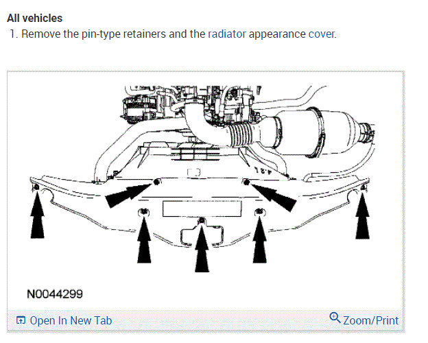

The fan speed is controlled by the powertrain control module via a fan speed sensor. Based on engine coolant temperature, transmission temp, and if the A/C is being used, the PCM opens a valve in the fan clutch causing the fan to speed up or slow down.
I have to be honest. If you are hearing a loud roaring, jet-like sound and the temp is high, it could be normal. If you are hearing that type of noise when the engine and outside temps are cool, the clutch likely needs replaced.
Take a look through this link and see it seems to mirror what you experience:
https://www.2carpros.com/articles/fan-clutch-symptoms

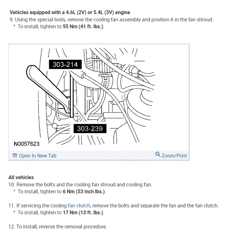

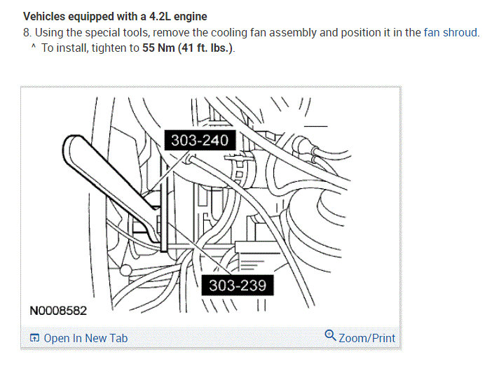

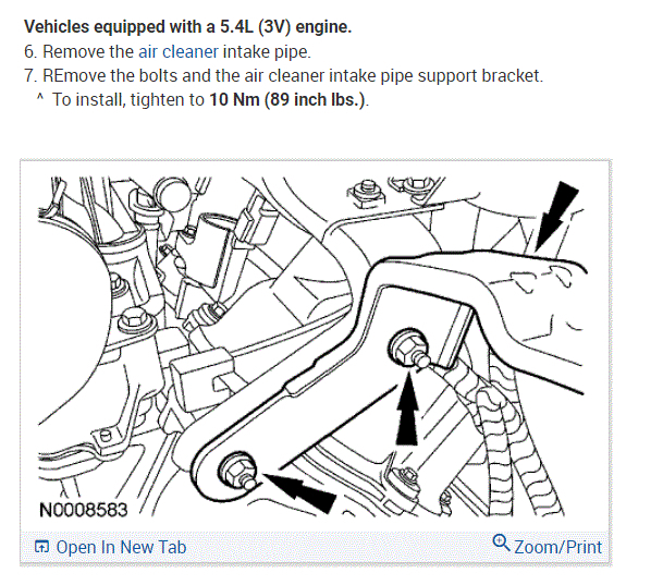

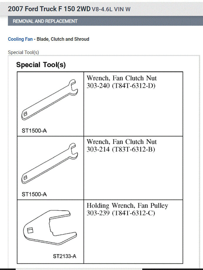

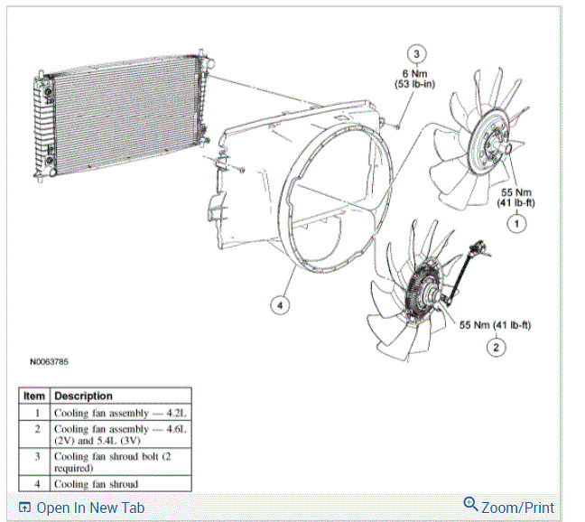

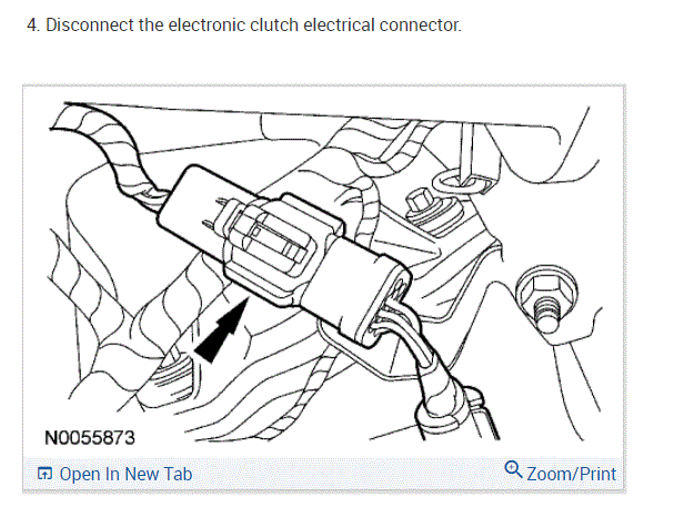

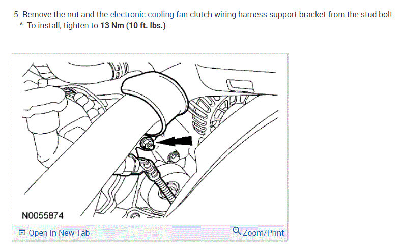

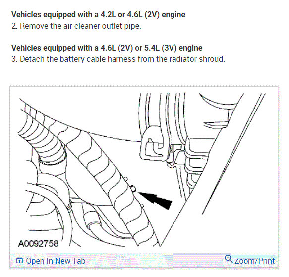

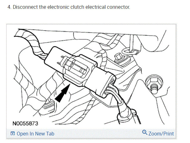

If you determine the fan is bad, here is a link to get you started with the replacement:
https://www.2carpros.com/articles/fan-clutch-removal
If you look at the pics below, they include directions specific to this vehicle.
Note: There are special tools required to perform the procedure. However, most parts stores will lend them to you.
I hope this helps. Let me know if you have other questions and how things turn out for you.
