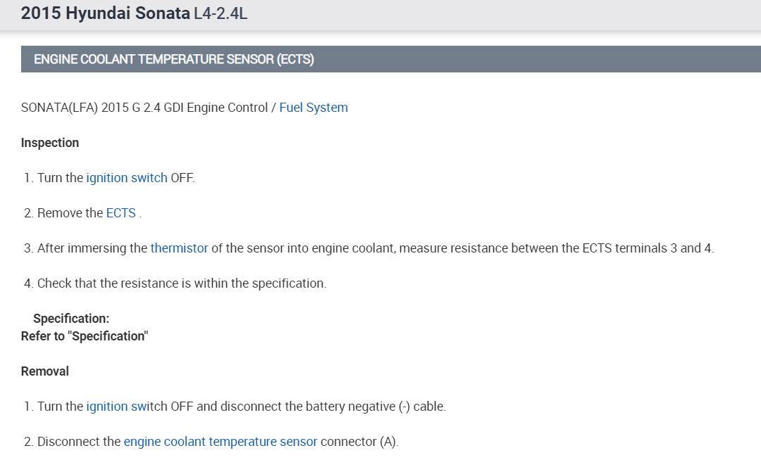

Hi, my check engine light is on and I’m getting a P0128 error code. Coolant level is fine. My temperature gauge is reading normally. Starting cold and then heating up in 5-7 minutes of driving to sit in the middle of the gauge. No rapid fluctuations or signs of overheating. A/C and Heat are working normally. Does my thermostat need to be replaced or could it be something else? Thank you!
Sep 26, 2022 at 11:53 AM
  • CAR REPAIR CONTRIBUTOR
  • 54,354 POSTS

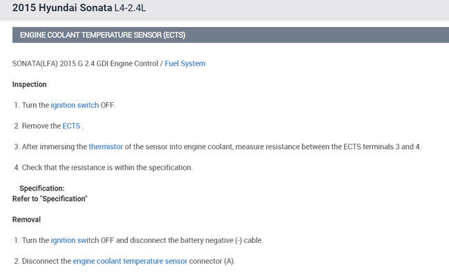

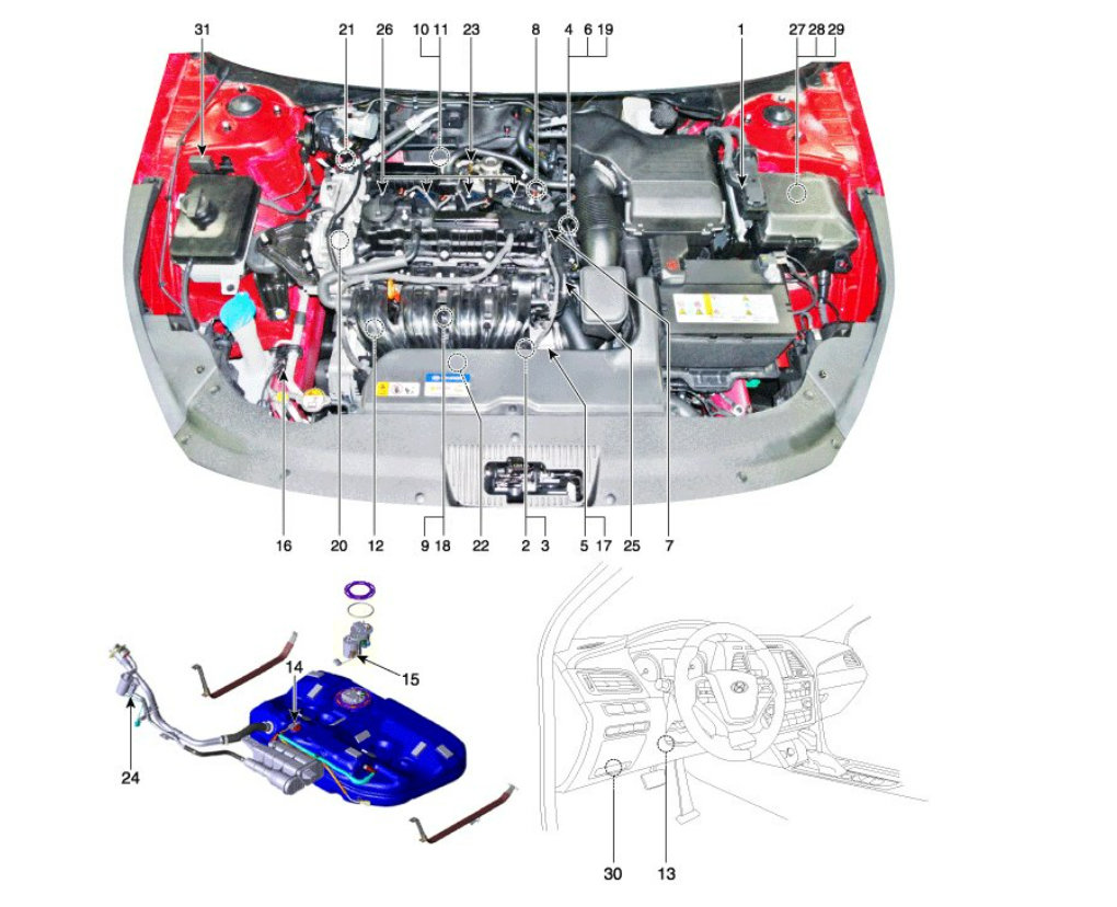

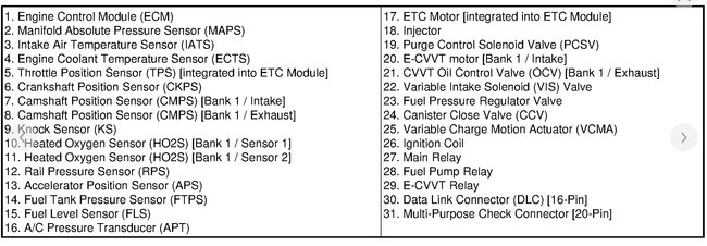

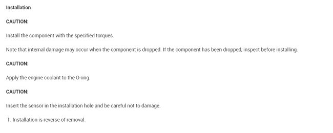

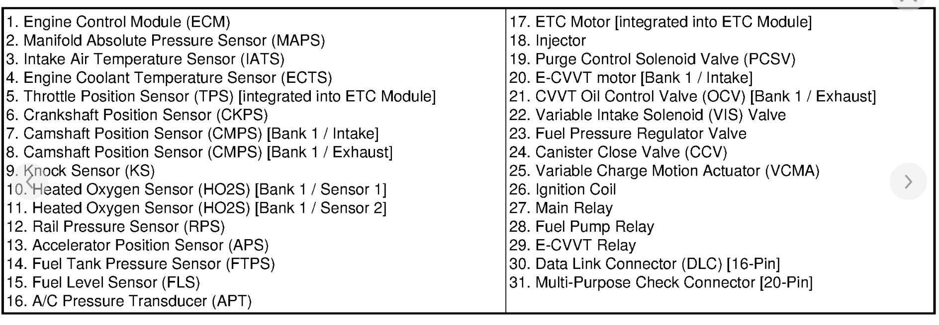

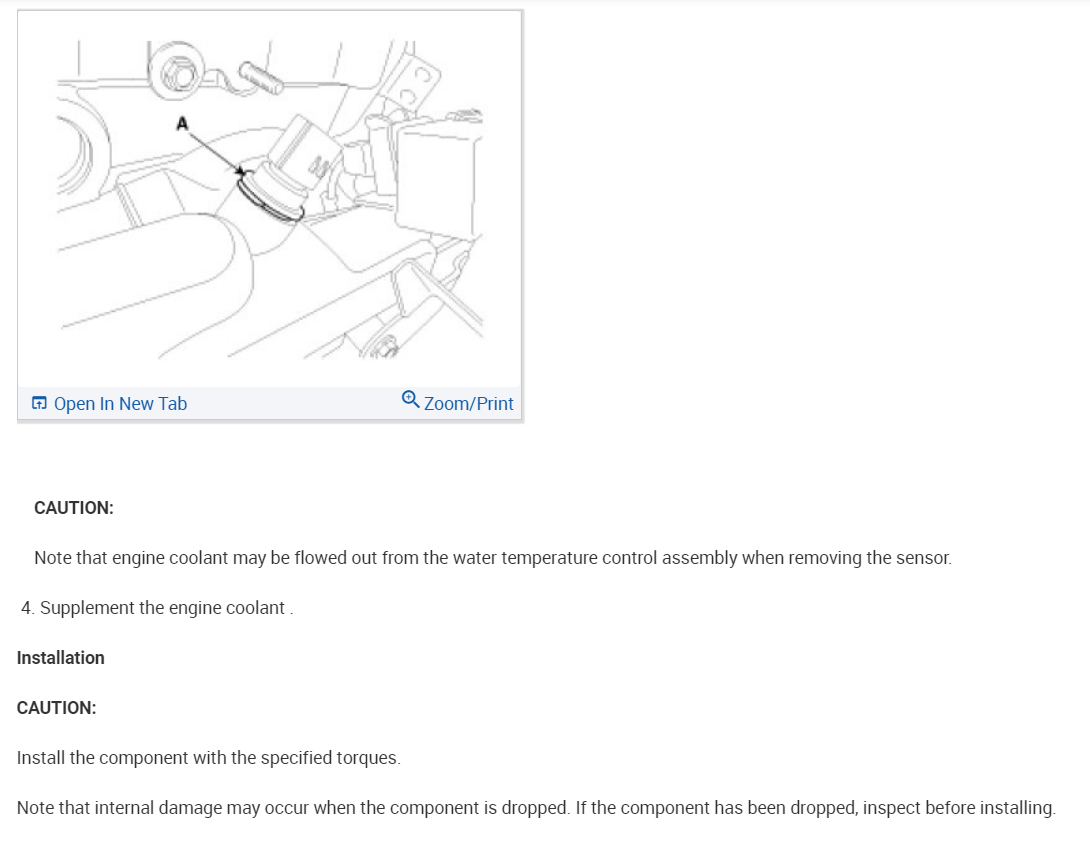

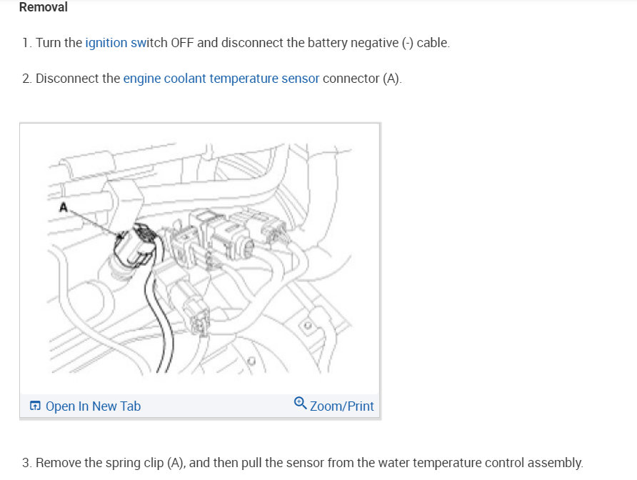

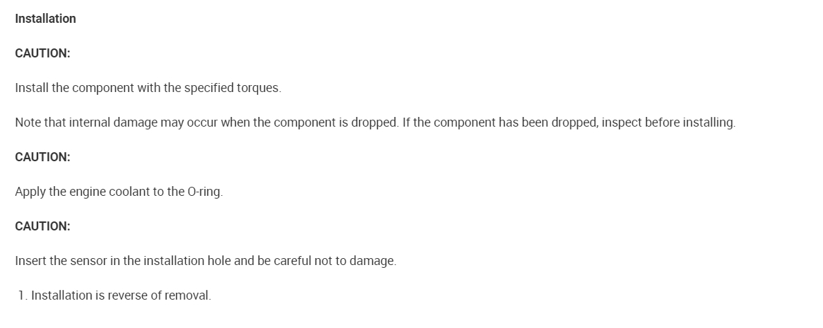

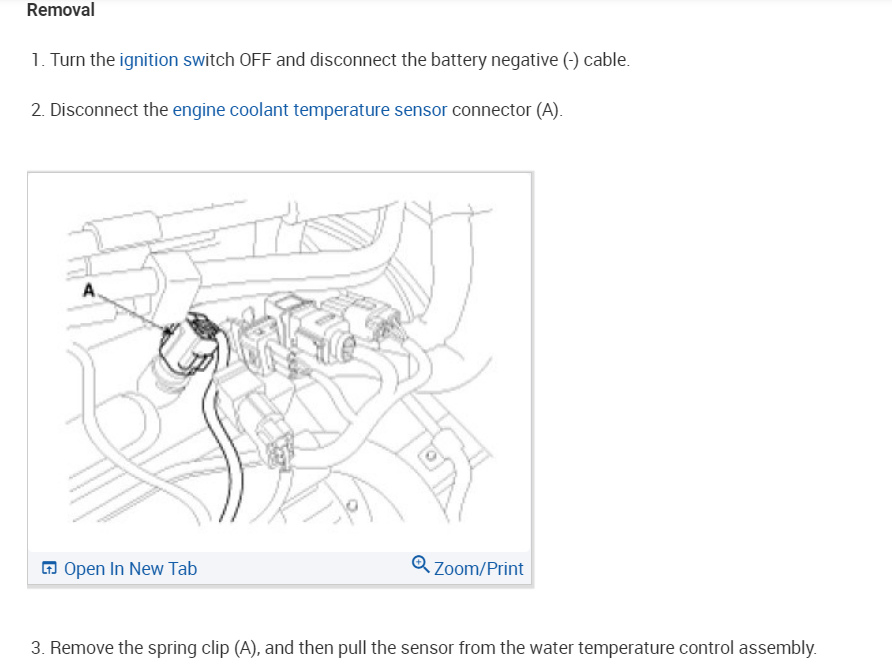

Since the engine is heating up quickly, I would say the engine coolant temperature sensor needs to be replaced. Start by draining the coolant, here is a guide to help you through the steps and the instructions and location of the sensor and the images below.
https://www.2carpros.com/articles/coolant-temperature-sensor-cts-replacement
Check out the images (below). Please let us know what happens. Clear the codes once the job is complete.
