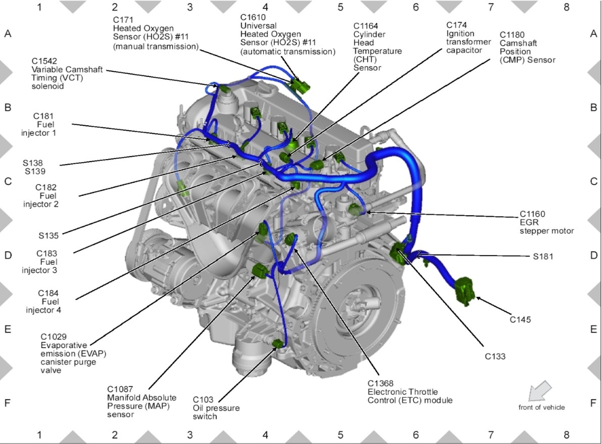

The engine also seems to be running a little rough. Other than that, everything seems normal. I should note that about two weeks ago when I had my oil changed the tech put a filter on without the gasket and blew oil all over the bottom of the motor. I'm wondering if this affected the ECT sensor. Also, there is no check engine light.

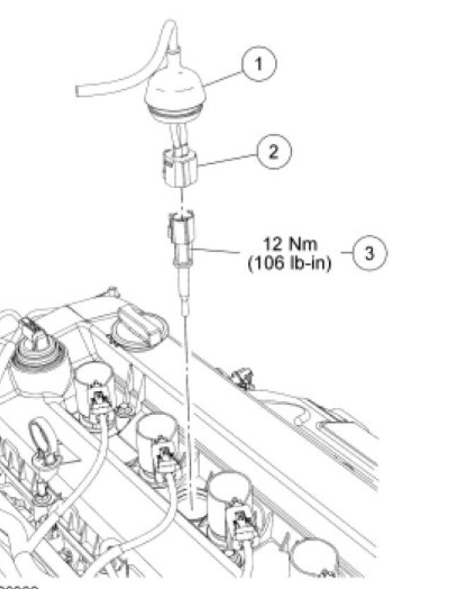

Not likely an issue caused by the oil as the cooling system sensor is on top of the engine between the cams and between cylinders 2 and 3. It could be a bad valve cover gasket letting oil into that area or the sensor is damaged by corrosion which is somewhat common. Replacement is simple, pop the cover off, unplug the connector and unscrew the sensor. Screw in the new one and connect it and put the cover back in place. If you find corrosion you will want to get a replacement pigtail and wire it in as cleaning usually isn't enough.

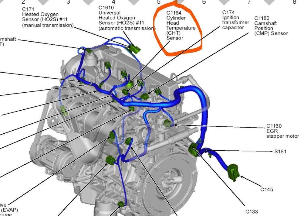

Hi Steve, thanks for the reply. Does this engine have 2 sensors? While researching the problem I’ve been getting conflicting information. Some say it’s on top and others say it’s the one under the air intake in front of the first cylinder by the oil filter. Do you also know if different engines were put in these cars? None of the videos or information I could find were about this engine. Thanks again!
Nov 25, 2022 at 8:47 PM
STEVE W.
  • 15,351 POSTS

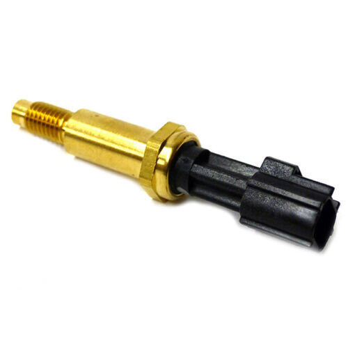

Single sensor up on top of the engine. Part #8S4Z6G004A Ford used both types on some applications when they used a different control for the cooling fans and gauges, then they went to the single CHT on others.

I appreciate the response. I just picked one up and will give it a try. Thank you.

I'm not a big fan of them simply due to the way they read, the thermal mass of the head or block can throw the sensor off. On the ones with both sensors, it's common to dee a 10–15-degree difference between the coolant temperature and the head temperature. However, they can be handy, I've used them on air cooled engines to monitor the head temperatures.
One thing I forgot to mention, check the bore it goes in for corrosion as well. Aluminum oxide is a good insulator so if the bore gets corroded it can change the readings.
