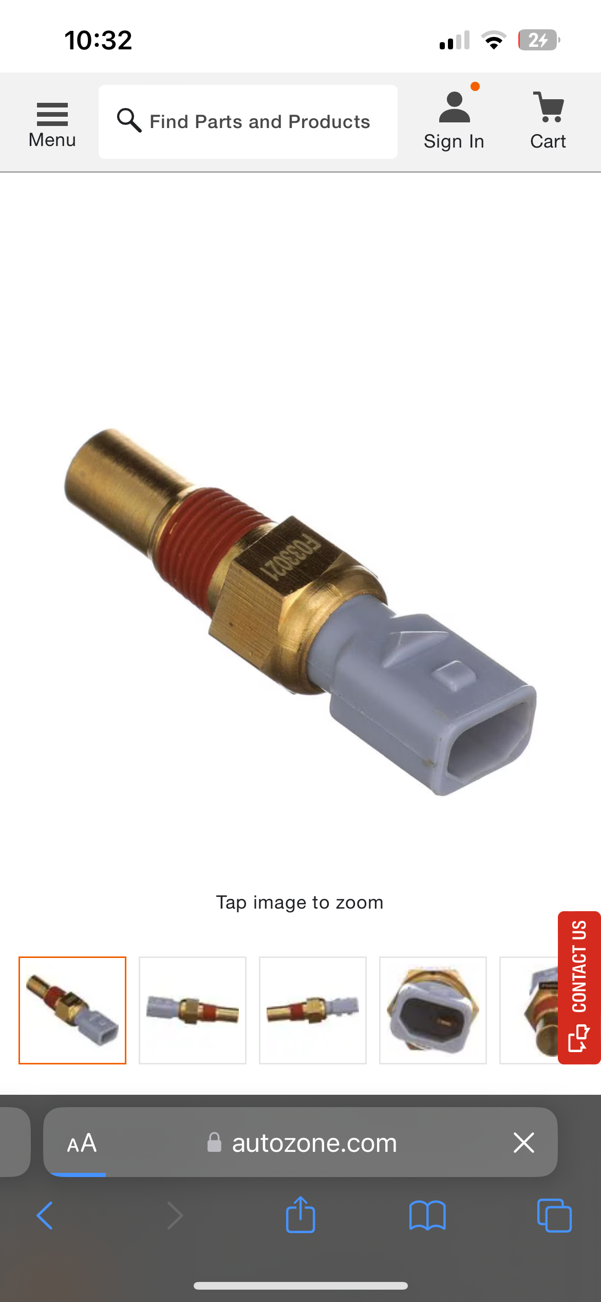

I’m trying to pass inspection I went to AutoZone and there was only one code which is the coolant temperature sensor for the engine light.
I want to know the location to install the coolant temperature sensor. I looked online but it’s an older model. There’s no pictures or videos to expand my knowledge. I love my truck listed above 1500, my first truck!!!! However, I’m seeking experienced mentors to teach me. I believe I can be the mechanic upcoming.

What was the actual code? It wasn't P0128 by chance? Asking because I'd hate to see you swap parts that are not the correct items. The P0128 for instance is 99.999% a bad thermostat. That temperature sensor, however, is hiding behind the alternator in the intake manifold. Remove the air cleaner and look behind the alternator, unplug the connector, then prep the new sensor. Now remove the old sensor, just before you remove it, push down a bit and squeeze the upper radiator hose. Now let the hose go, pull the old sensor and insert the new one fast. You should be able to do it and only leak a tablespoon of coolant. Gently tighten the sensor to 60 Inch pounds. Be careful as it's possible to damage the manifold and cause leaks.
