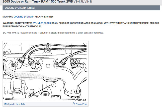

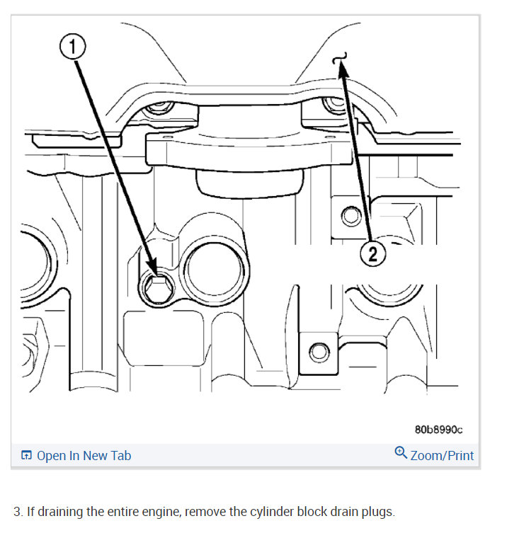

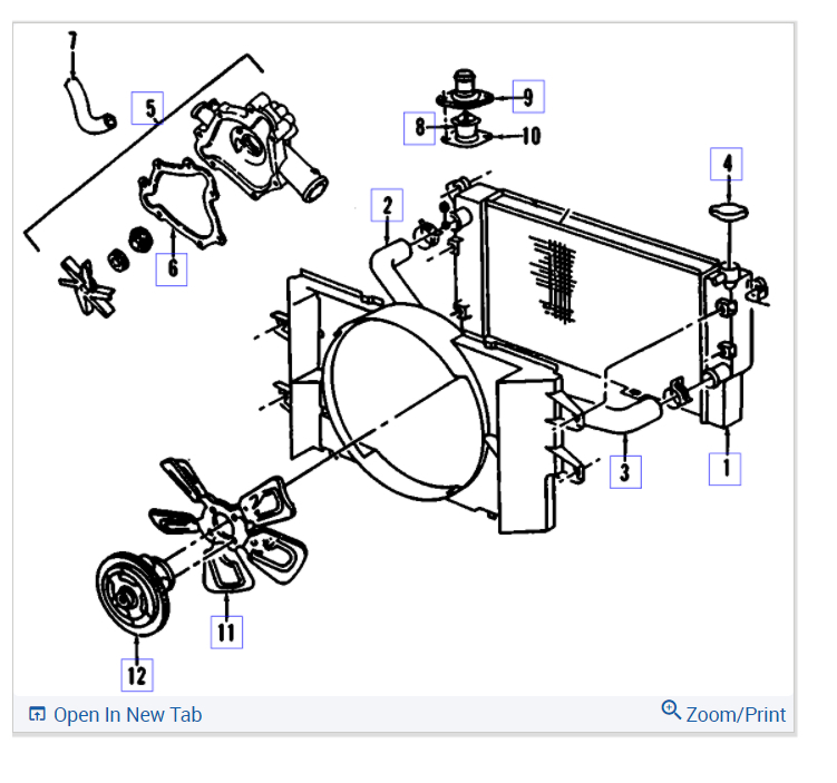

I am flushing the radiator can you help me please?
Nov 7, 2010 at 8:51 AM
BLUELIGHTNIN6
Experienced Mechanic
16,542 POSTS
Here is a guide to help you step by step with instructions in the diagrams below to show you how on your car.
https://www.2carpros.com/articles/coolant-flush-and-refill-all-cars
This video shows the job being done on a similar car but the process is the same.
https://youtu.be/HjIg9FGCviw
Images (Click to enlarge)
Professional Diagram for 2CarPros Members
Click here to log in and view diagram.
Nov 7, 2010 at 3:52 PM
WILLMATHISTTF1
MEMBER
3 POSTS
I had the cap off and it still would not flow like it should. I took off the bottom hose going into the radiator, put the cap back on, started the truck to let it warm up and it barely flushed. I removed the plugs to remove the remaining fluid.
