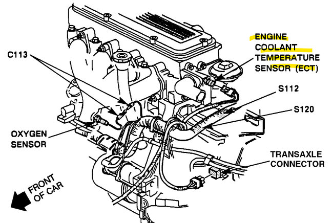

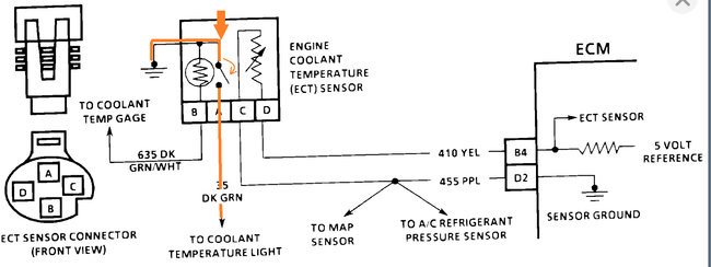

First, I noticed my temperature gauge is showing the wrong temperature and not working correctly.so, I changed my thermostat, and it still does the same thing. Then I’ve notice that my coolant temperature sensor is not working properly. So, I bought a replacement sensor, but the replacement sensors aren’t the same. The one in my car is a four prong and the one the part store has is a two prong. I can’t find the right part anywhere. I need to know what to do.
Sep 28, 2022 at 4:02 AM
AL514
  • 5,656 POSTS

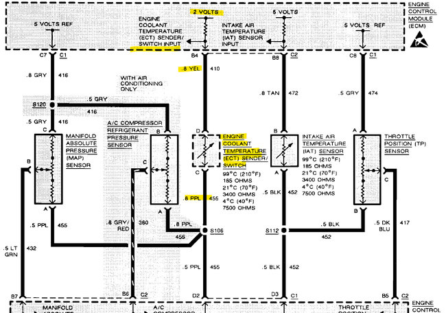

Hello, I see what you mean, going through the wiring diagrams I've found a 2-wire sensor and a 4-wire sensor. I think one is for the computer, and the other type seems to be for the computer and for the gauge with a switch in it as well as a thermistor (sensor). Can you tell me the wire colors for the sensor on your car? The four wire colors on the harness plug. Some will be a solid color with a stripe down the side. I'm trying to find the correct sensor for you. There is either two coolant sensors for different reasons or there are two different designs. You can check the wiring with a multimeter if you'd like. I can walk you through it just to verify the wiring from the computer is okay.

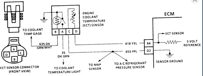

If these 4 wire sensors colors are correct, solid yellow, solid purple, green with white stripe, and solid Dark Green (2nd diagram). Let me know.

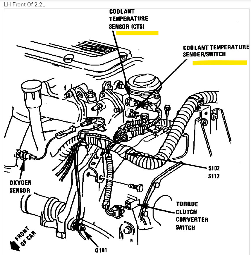

And the third diagram, is that the sensor you are trying to replace?

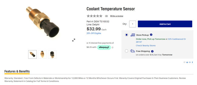

This is the OEM (Chevy) part number for the 4 wire Coolant Sensor/Switch (10137646). It might be something you could try calling a dealership and see if they carry this 4-wire sensor or if they know why there are different sensors listed. I will keep looking though.
This is a link to napa auto parts store. They have a 4-pin coolant sensor for $32.00. This looks like the correct sensor. This one has a switch for the coolant light, as well as a resistor for the gauge and another resistor for the engine computer input. Thats the difference between the 2 or 4 wire sensors. This could be a discrepancy due to where the car was built, the time of year it was built and possibly if the car is California emissions or not. But the link below will take you to the correct sensor, I don't know if you have a Napa near you, but you could order this online if needed.
https://www.napaonline.com/en/p/DEMTS10032?cid=paidsearch_shopping_dcoe_google&campaign=GSC-Fasteners-Hardware&campaign_id=10947735022&adgroup_id=107081865346&adtype=pla&gclid=CjwKCAjw4c-ZBhAEEiwAZ105RceXsb4vXwLsciPjh8TJC_zQezdM8GLpcEmZ-vL6uL6clr5lB3jzohoCuDMQAvD_BwE&gclsrc=aw.ds&

The 4 wire colors for the sensors plug are solid yellow, solid purple, solid dark green, and green with a white stripe. I also checked out the link for the sensor at Napa and it’s not the right sensor the plug is a different shape. The build date for my car is 12/92’.

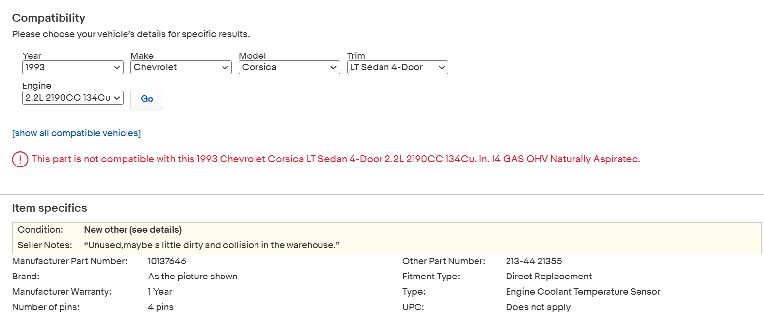

This is the link to the best online option. What do you think about this, if I’m not able to find it in a part store?

It is giving me a not compatible message for your car. I can understand why it would be discontinued. There' has been a lot of issues with getting parts for older vehicles as well as some newer ones. I'll search around a little bit more for you too. Check Rockauto com
Which part number did you find that was correct? And can you take a picture of the old sensor plug end? So, I know what the connector is going to look like.

This is the diagram from a 1992, do you have another sensor below like this picture?
Interestingly, this is the OEM part number for the 1992, 10137646- same number as the 93'. On the tag on the underside of the hood say 'California Emissions Standards?

No mine doesn’t have the second sensor below. Just has one.

If you have a multimeter that can check resistance, we can check the sensor
I would check the connector too, to see if there's any corrosion on the pins or in the connector.

The green stuff is not good, what does the inside of the connector look like? Look really close into the female pins with a flashlight. See if the corrosion got down into the wiring harness. That might be your whole problem. If there's green crusty on the sensor pins then 90% of the time there is down in the harness connector too.

Look in the back on the connector too, the green corrosion works its way down into the wiring under the insulation and keeps growing down the wire. You can't even see it most of the time. Thats why we do so many different types of wire testing..
Sep 28, 2022 at 7:57 AM
6CHARLIESIX
  • 35 POSTS
If it’s corrosion that’s causing it to fail, would I only need to replace the wiring harness?
Sep 28, 2022 at 7:58 AM
6CHARLIESIX
  • 35 POSTS
On the wiring harness only one of the female connectors is corroded. It’s the connector for the dark green wire.
Sep 28, 2022 at 8:13 AM
6CHARLIESIX
  • 35 POSTS
I cleaned the corrosion off the sensor and off the wiring harness to the best of my ability and letting it dry really well before i put it back together. Fingers crossed.
Sep 28, 2022 at 8:48 AM
6CHARLIESIX
  • 35 POSTS
I clean the corrosion off the sensor and off the wiring harness to the best of my ability and letting it dry real well before i put it back together. Fingers crossed
AL514
  • 5,656 POSTS
It depends on how far down inside the wiring insolation the corrosion goes. You can get terminal spray cleaner at an auto parts store and try that. But the Dark Green wire is only the ground wire for the Engine Temperature light. It will come on when the temperature gets too high to warn of overheating. I have that part of the sensor in orange below. The green/white wire is for the Gauge. As you can see it's a 2-part sensor. The other section goes to the engine computer to calculate the air/fuel mixture. With a multimeter you could test pin B to the housing of the sensor and see if there was any resistance reading on the Ohms setting. If the meter reads OL then the sensor has an open circuit inside. If there is a resistance reading, then there might be an issue with the wiring to the sensor going to the Instrument Cluster.
The corrosion causes high resistance in the circuit, and since this sensor works specifically on the resistance changing due to heat, this is why bad connections and corrosion cause big problems with this type of circuit.
