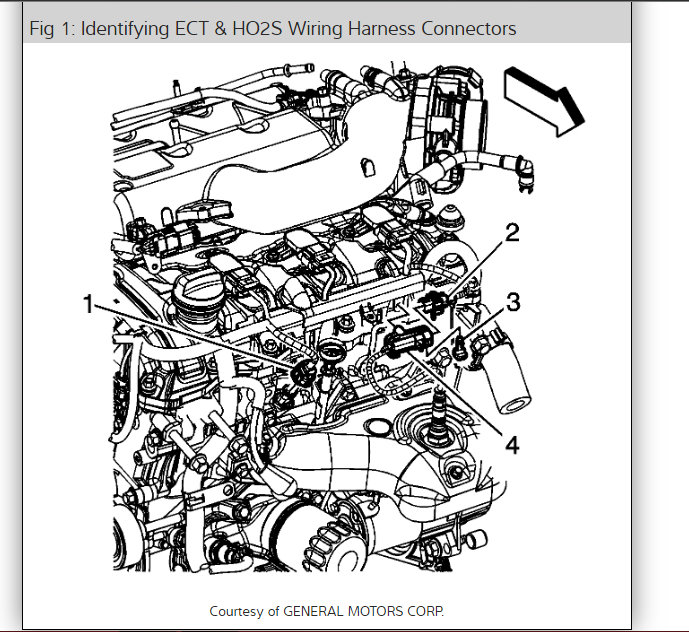

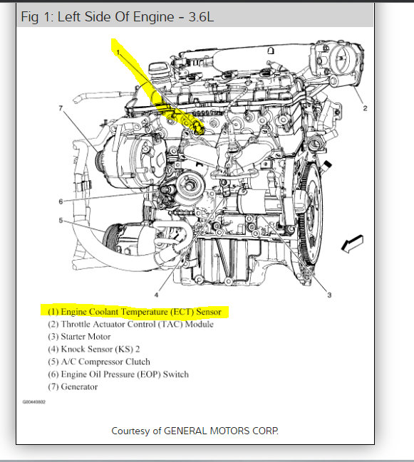

So I am currently working on this car, it is throwing a code for a engine coolant temperature sensor. I am wanting to replace it but want to make sure I have to right location. I have watched quite a few videos on it but I haven't seen any for this particular vehicle and year. I have a diagram I got through the AutoZone website but it doesn't specify where on the engine. I believe it is located on the "front" (looking from the front bumper to the back) just below the valve cover and just above the exhaust manifold. Is that correct? Or is it on the back near the firewall? Any help or tips would be extremely helpful Thanks.

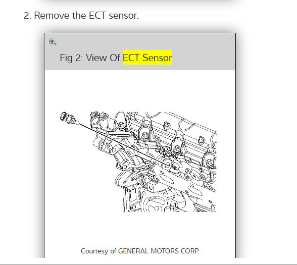

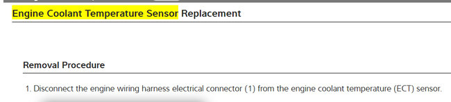

I have included the information that you have requested in the diagrams down below. The installation is the reverse of the removal. Please get back to us with how everything turns out.
Thanks,
Alex
