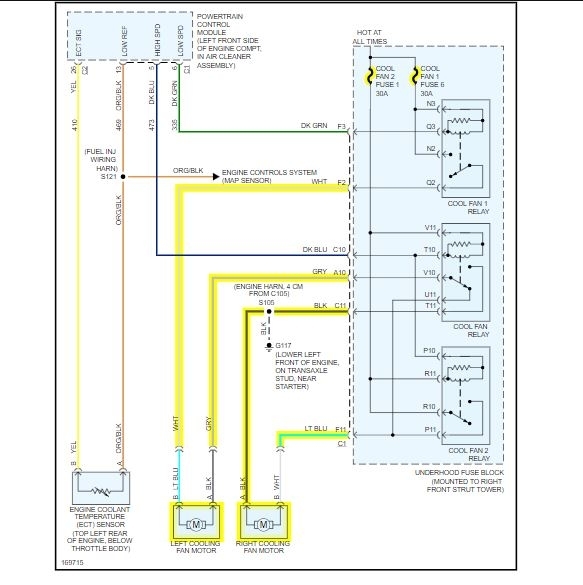

Half of the neck of my radiator broke off as I pulled in to yard and the temperature was at 230 which the max in red is 260. so I reattached it and put coolant in it and got into my garage. I changed the radiator and bled the two air bleeds and the car warmed to normal 195 but then as it got to 215 the fans would not come on! I let it warm to 230 and they never came on and it was creeping up so I turned on A/C switch and the fans came on temperature stayed normal at 195! I turned off A/C fans would turn off and temperature would creep up again so I then changed, the black fan relay and some thing happened! I then changed the coolant sensor and same thing happen, they would not come on until I turned A/C on! The book said only thing left was ECM so we got a nice one and changed it and the car was idling very nice, and we drove around and the temperature stayed normal at 195 we pulled into yard and the fans came on like the should at about 210-215!! We were excited problem solved. Next day 4/7/2020, I drove to bank and PO and the car ran really good but the check engine light came on but the temperature held good at 195 it was a cool day. I pulled in and popped hood and let it idle to make sure fans would operate properly and the darn fans would not come on. I turn it off and coded the ECM and the reading was PO135 02 sensor #1, so we changed it thinking that might have something to do with it but the fans still did not come on. Then I read a post by a tech on here said to turn car on, engine off and pull plug off coolant sensor and the fans should come on I did this and the fans did not come on, so is there a short in the wiring? Is that the reason fans did not operate when I did the unplug technique?? Because prior to doing that we were hearing a hiss or low crackling sound when we would turn off the car after having it idling! The wires off the sensor run under the air charger housing I think is what it is looks it is attached to the intake manifold or it is part of the intake manifold. Look like only way to get to the wires. Please advise!
Apr 8, 2020 at 5:09 PM
Good evening,
First, when the A/C is on, the fans should come on. That is normal.
What is not normal is the fans not working when you disconnect the coolant sensor.
https://www.2carpros.com/articles/how-an-electric-cooling-fan-works
One thing I would do is replace the thermostat as I never saw anything about it being replaced.

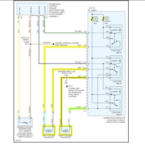

Beyond that, check the fuses in the diagram I attached for power on both sides to be sure they will send power to the fans.

That is why I posted the wiring diagram. You need to check the fuses for power on both sides .
There are 2 relays for the system. we need to start somewhere and that is where we start.

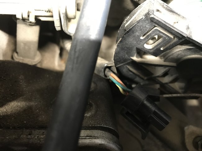

Here it is. I can send a picture of the connector if you want.
Apr 13, 2020 at 1:20 PM
6STEELRINGS
  • 29 POSTS
Here are the connector wires:
Apr 13, 2020 at 1:25 PM

Okay, that is the sensor that does both the temperature gauge and the signal for temperature.
I would change the thermostat as it may be opening late causing the temperature to go up. The position of the sensor makes a difference.

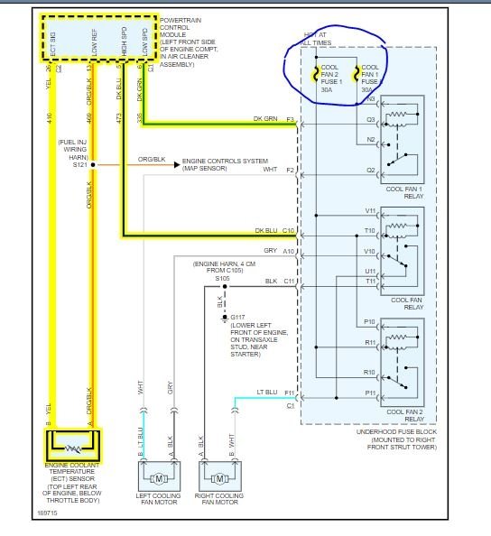

The ECM only grounds the relay for the fan to operate. It does this based on input from the coolant sensor on the engine. I highly doubt the ECM is the issue. I believe it is a mechanical issue.
I attached the wiring diagram for you to view. Check the fuses I circled for power.
if you remove the connector for the coolant sensor with the key on, the fans should come on.
