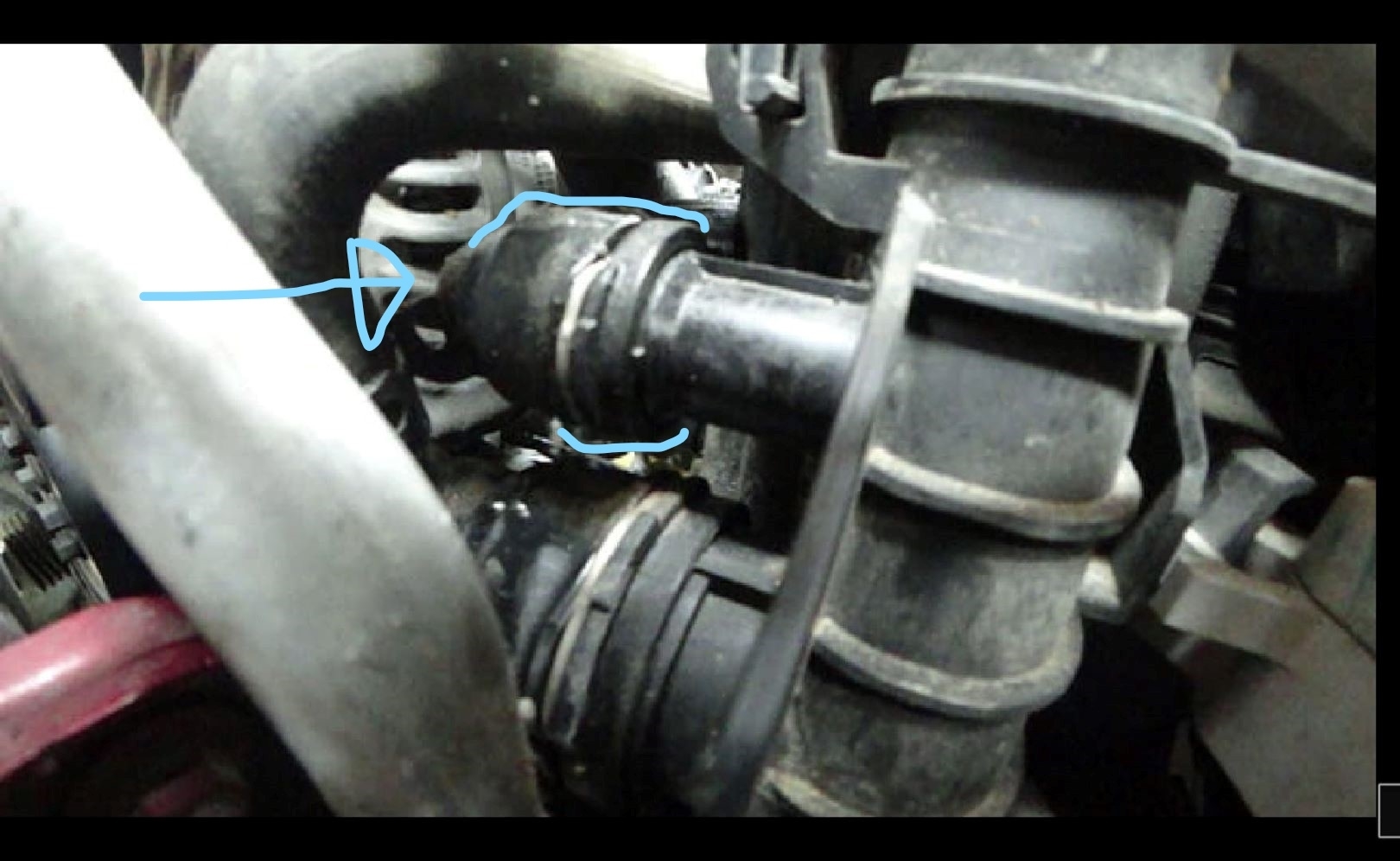

This connector leaks coolant, car remains on H engine overheat warning even if sitting overnight! I am hoping to find out what is the name of the part I need to replace. It is the top L shape connector in this image. Also, will this correct my high temperature warning or will I have to replace a sensor? If so what sensor? Thanks
When coolant is added it pretty much flows right out the back of that L shape connector. Goes to a smaller hose!

Here you go. It would not upload with the original post.

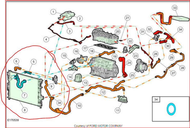

I have attached a picture and believe it is #5 or #6 and circled in red (hard to tell from your picture). I believe it is #5. They are called the "Transmission Fluid Cooler Coolant Control Valve Inlet Hoses". Hope this this helps and ask any other questions if needed. Thanks again for using 2CarPros.

Definitely in the place of #6. Thanks a lot!
