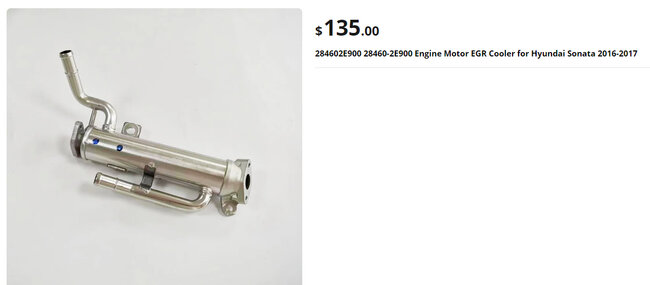

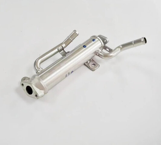

Yes, that is the part number I’ve been coming up with all over the place. I will verify with the dealer before I order one online. I see a lot of those EGR coolers come with the two new gaskets. But some don’t. Now correct me if I’m wrong. There shouldn’t be any coolant in there at all. Just the gases run through at roughly 800 degrees and the coolant runs through the outer jacket of the cooler to get the gases to like 200 degrees before the gases reenter the cylinders. So, I’m thinking the extreme change of temperature would eventually get the metal brittle enough to crack or at a weld because that would be the weakest points to the sides of welds. Anyway, where did you find that picture at? Website that’s see
Selling them? I’m going to order one hopefully this weekend plus the two gaskets and I’m most likely going to get a new cooler pipe on the side that’s leaking just in case it’s damaged in any way. But yes, I will let you know all the details on this to help future people that need help like I did.

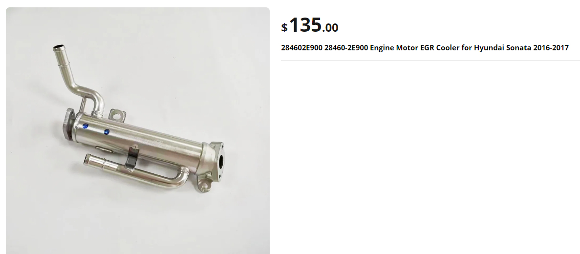

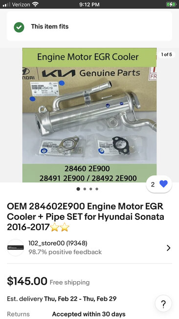

Yes, hello al514, just called my dealership and the part#28460-2E900 is the winner. They charge 635.66 before tax. I asked the parts guy what the difference would be if I bought one off eBay that’s made in Korea for 150.00 bucks. He said go for it theirs comes from Korea as well. On Sunday I’ll pull EGR tube off to see if anything comes out. I’m going to think something should come out. Shouldn’t the car be running to circulate the coolant?

That's a lot of money, it's just Al btw. The site I saw it on is a super cheap kind of knock off type site, I've purchased some electronic parts from them before (non-automotive related) microchips and such, so I'm not sure about their parts, I was more looking for a part number, it was just aliexpress com. I think it's stuff directly from other countries. You are correct on its operation, the exhaust gases simply run through the center pipe with a cooling jack on the outside, you can see the 2 cooling pipes that have rubber cooling hoses clamped onto it, that's where the coolant circulates threw and around the center pipe cooling the exhaust some. I have the same assumption, that it cracked need one of the welds at that top flange, or just plain failed somewhere, but either way. To be absolutely sure, I would pressure test the coolant system with the bolts for the cooler on both ends taken out. You could buy a cooling pressure kit at Harbor Freight, they sell a cheaper one. But you might find it leaks when you take off the bottom pipe to the manifold. It has to be leaking quite a bit to go through so much coolant. There is a gasket on the top and bottom, you will have to do an online search for those. I don't see any in stock either. You have everything correct though,

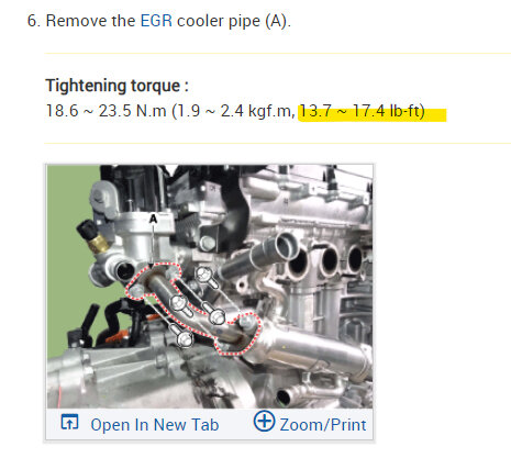

Hello Al, I’m going to try pull that cooler pipe off on Sunday. Tonight made exactly 2 gallons of loss. I’m probably going to order one on Sunday night or Monday once I get a visual on everything after taking air cleaner housing off and anything else in my way. Everyone I found is in Korea or South Korea but that is where the dealerships get theirs as well. My car was even made there so I guess it’ll be ok. I have to pay customs and duties tax as well. I’m not exactly sure when and where I will do that at, but I’ll call the post office in the morning, they should know at least what I got to do. I narrowed it down to these were way cheaper and free shipping, so I’ll go with one of these. Thanks

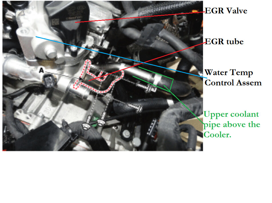

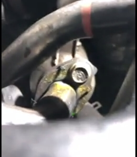

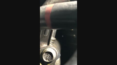

Hello Al, it’s been a while since I communicated with you on my car I didn’t fix it yet because I asked the dealer if they would cut me some type of break being they had my car like 4-5 times and didn’t fix it due to they misdiagnosed it and it got hit on their property 2 times already. Well, they wanted to see it. So, inspection due so I went down, and my check engine light finally came on dammit, so I couldn’t get that done. Well, I explained that you and I are pretty sure what and how it’s losing this much coolant. I wanted to be in the garage when they checked it out, but they didn’t let me. Anyway, now the mechanic says it’s a cracked intake manifold. He says my car doesn’t even have an EGR cooler. I demanded to talk with him, over the phone by their choice. That person argued with me about the EGR cooler. So, I asked him where do my heater core hoses attach to? He said the manifold. So, I said bull they go to the cooler. So, I asked where the EGR pipes connect to, he said the manifold. I told him no they connect to the ends of the cooler. He said again my car doesn’t have any cooler. I told him yes it does, but I told him okay, put the new intake on it since that’s under warranty. Where the heck do they find these guys at? I pulled it up on my phone and showed the service lady the EGR cooler picture of one for my model and year of the car. She said the mechanic said it doesn’t have one. I said read my phone I found an imaginary one for my exact car on a Hyundia parts site. She wouldn’t even glance at my phone. It’s going back when they get me a loaner. Then it’ll go back after that when it’s got a new manifold on it and still losing antifreeze.
Mar 26, 2024 at 12:54 PM
AL514
  • 5,654 POSTS

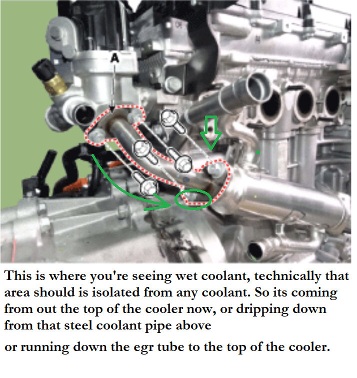

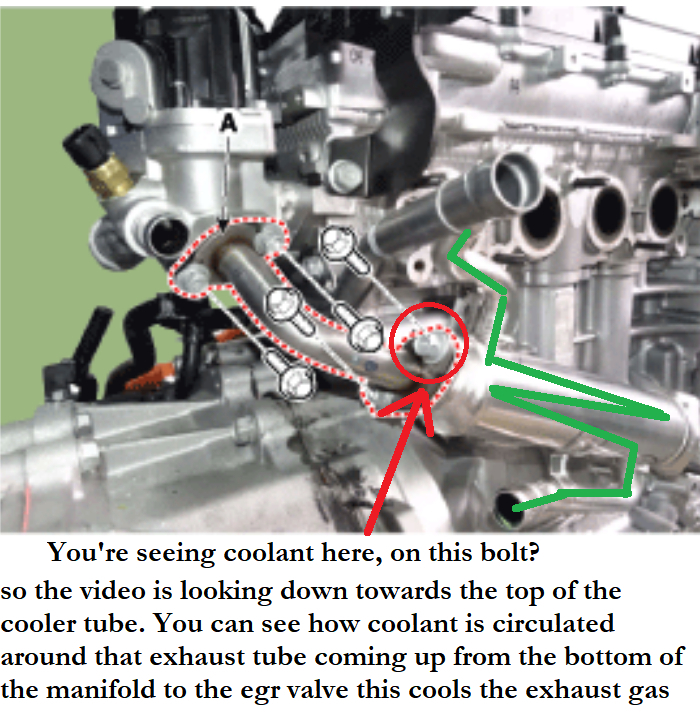

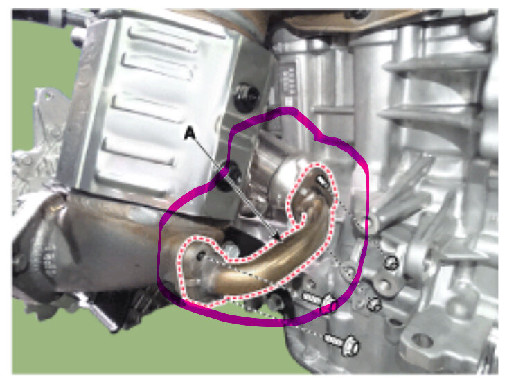

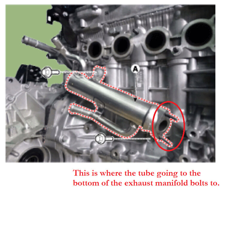

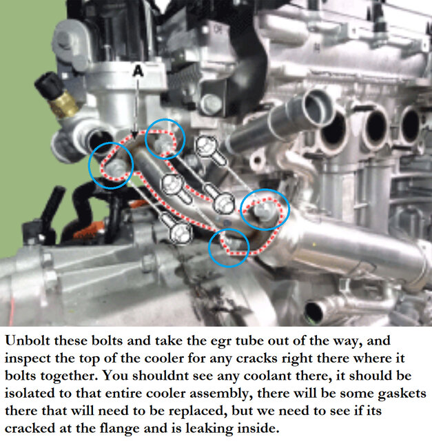

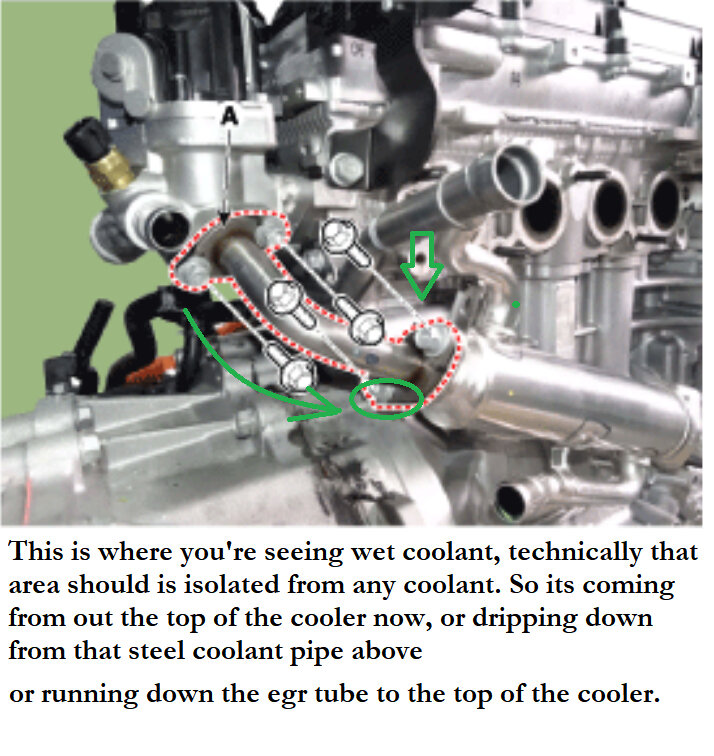

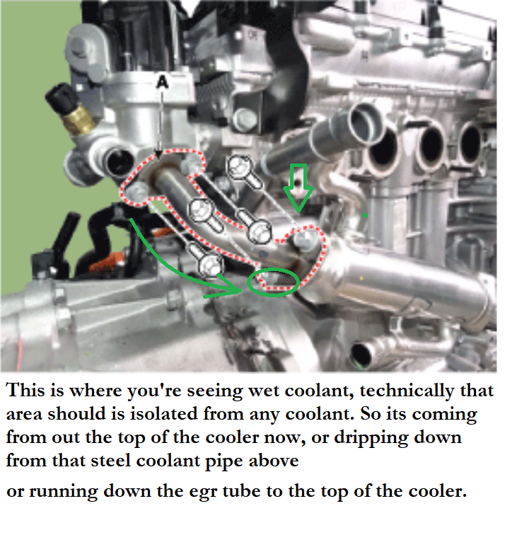

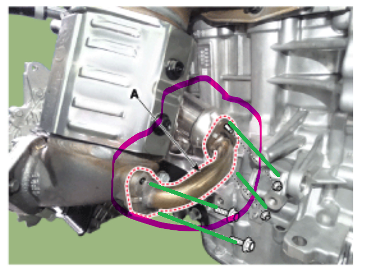

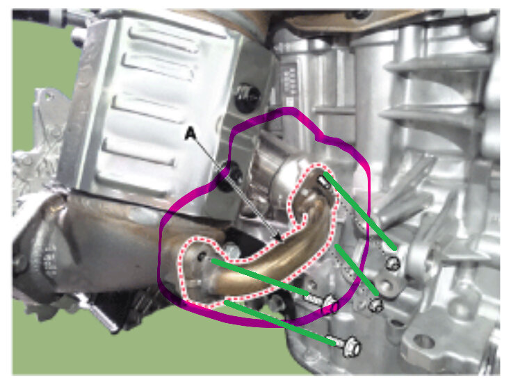

Wow. You can physically see the EGR cooler piping though, that was in the diagrams we were looking at, correct? It all looks the same as what is on your vehicle. I just want to be sure, it's sad when they bring up doubts like this. And I can't be at the vehicle to help you with this, that makes it even more difficult.
Mar 27, 2024 at 3:48 AM
GOODY1966
  • 58 POSTS
Yes, those pics and diagrams are spot on identical to my car. It might be he felt insulted because I said the EGR cooler is leaking . I’m not sure how he would of even seen a crack on the intake with everything in place, but yet couldn’t see the EGR cooler right there in the way. But if it would be the intake, that means they took it off and put it back on3 times without checking it. I know it’s the cooler. I think he seen the dried spots of antifreeze/dye on hoses and EGR pipe that goes to my EGR cooler that my car doesn’t have and he just assuming it’s the intake manifold. I’ll keep you filled in but I’m sure they are going to take their time.
Mar 28, 2024 at 7:56 AM
AL514
  • 5,654 POSTS
Maybe they don't know what it is, it's possible their techs are not up to date, I mean you and I found it by going through service info, but really, it's been there so many times, I don't know what the excuse is. I'm sorry it is taking so long to just get your vehicle back on the road running correctly. Let me know what eventually happens.

Okay, Al, how ya been buddy. Want to drop you my latest scoop on my Hyundai . Not sure if I told you I took it down because they needed to look at it for coolant leak and get inspected. When I took it down I told them there is this guy in the net and he been helping me diagnose the problem. I told them we both agreed that the only possible scenario is the egr cooler. Well they bring my car back that day after inspection and said they need to order a intake manifold for it because it’s cracked and the coolant is leaking in there. Well I demanded to speak with the mechanic. Got him over the phone I told him that you and I diagnosed it and it’s gotta be losing it in the egr cooler most likely coming from a internal crack from going hot cold hot cold all the time that son of a bitch said:get this- your car doesn’t have a egr cooler. I told him the heck it doesn’t . I told him if it doesn’t have one why does my heater core hoses run to it and back again as well as the egr pipes run off the ends of the cooler, he said again with attitude your car don’t have a egr cooler. Told him whatever you say. Put the new intake manifold on it and I’ll be back down again for same problem. Well took it in and I insisted someone better take that egr cooler of and I want it checked for cracks inside. Well went down to pick it up and the lady in service said to me. The mechanic took the egr cooler off and noticed it was leaking inside. By god I’ve been telling them for months about it. But she said they put a new EGR cooler and a new manifold on it. Manifold was warranty covered so that I knew. So I said what is the egr cooler and labor going to set me back? She said don’t worry about their gonna cover it. Wow, how cool is that!! Went to my car and popped the hood open looked down behind engine and seen a shiny new one. Looked at front of motor and guess what I didn’t see? I didn’t see a new intake, still my dirty old one. Checked the bill anp it said new manifold and gaskets and new egr cooler. Back in I went and asked why my manifold wasn’t changed and she said yes it was. Showed the picture and next thing you know we had managers and owner there and I was arguing because I do not want my paperwork stating falsified records on my car. I said scratch it off and sign it for all I care. I waited for it, it was in here for that and you didn’t do it. Owner was a ASS about everything. So now they still got my car so they can replace manifold. And they gave me a 100 dollar bll to pay for my 66 dollar inspection . I made out pretty good . Except they still got my car. Thanks for all your help on this. I appreciate everything you helped me with.

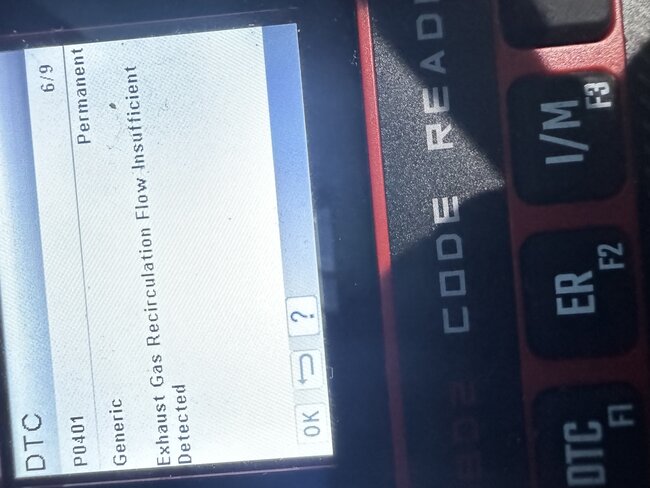

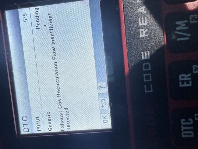

Al I’m not sure this nightmare is over. When I picked the car up the EGR cooler and intake manifold was new and installed. They informed me the check engine light came on when they drove it. Not sure what code they got but they put on a new EGR valve assembly free of charge. So I picked it up and check engine light was still on so i figured that he. Didn’t erase the code and it’ll go out eventually. Well I picked wife up after I picked car up and it didn’t go out. Put my scanner on it and got 2 codes now. PO401, PO139. I looked them up I think the po401 was insufficient air flow that’s what my scan tool said . The PO139 is a O2 sensor it’s coming up o2 sensor circuit slow response bank 1 sensor 2. It looks like the coolant level went down from high level line to the low level line. Maybe air working out, I’m not sure yet. This morning I was looking around and I seen a lot of liquid spots on ground under tailpipe when running so I’m not sure what’s going on yet till I monitor the level for a week or so. But the error codes I was thinking possibly a screwed up cat converter? It is just a guess on my part because of EGR insufficient flow and sensor 2 bank 1 slow response time. What’s a quick assumption you would have? Almost everything is new . I think it would be the converter or it’s in the wiring or pcm. Just your opinion be great. Thanks
Apr 27, 2024 at 11:24 AM
AL514
  • 5,654 POSTS

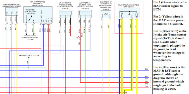

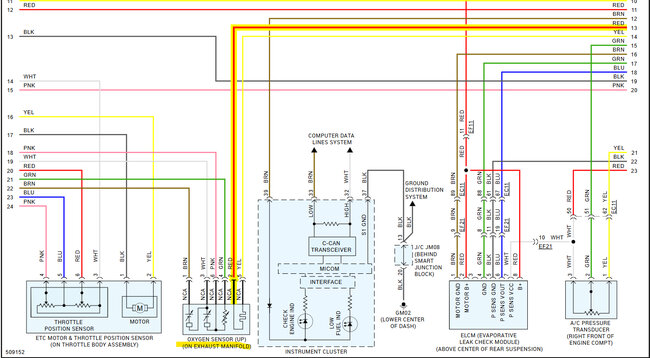

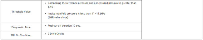

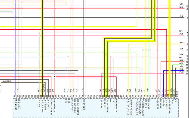

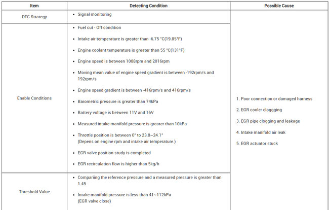

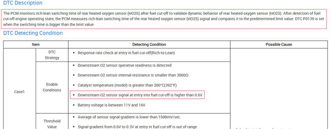

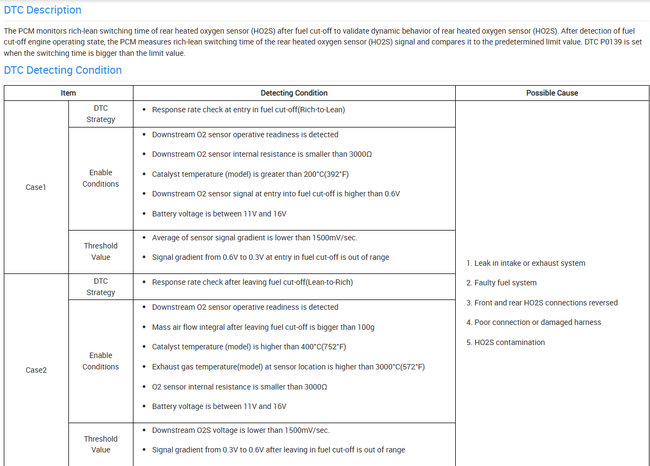

Okay, with the P0401 this can be more than just an EGR valve flow issue, I'll post the setting criteria and some possible causing for the code setting. The fact that it set after the repair, and wasn't setting before, tells me it was most likely something caused during their "repair". Such as moving the wiring harness around too much and stressing it, or not getting everything sealed back up completely like it should be. It's possible they didn't get the EGR tube completely sealed, or some other issue along those lines. Service info backs this up with possible "Poor or damaged harness connections" EGR pipe leaking" Intake manifold air leak" etc.
Diagrams 1,2 are for P0401 and 3,4 are for P0139, Id say the same thing for the P0139, those codes were not setting before. There should be some water dripping out the tail pipe under certain conditions, that's the Cat converting exhaust gases over to H20, although, with the amount of coolant you were losing, that is Cat contamination, I will dig into these codes some more later this evening. But I'd say once you get this thing fixed, you may want to think about getting rid of it, it's been nothing but headaches for you all the way here.

Okay, I appreciate that. The 401 light came on before I took it in for the manifold and I turned it off. So, the other code is new.

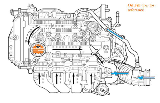

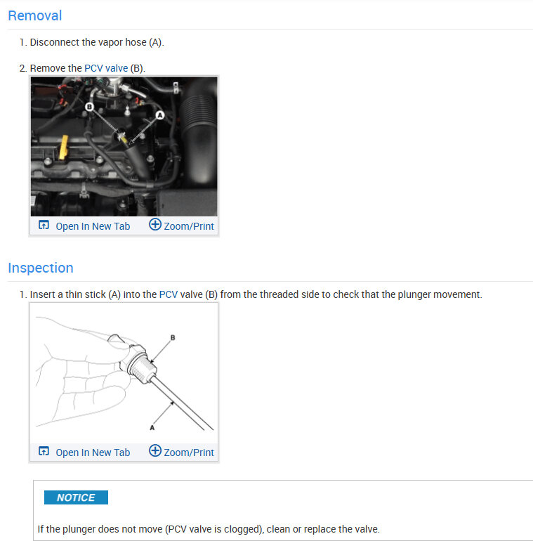

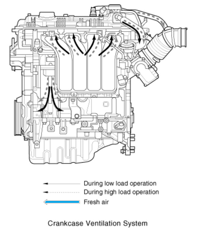

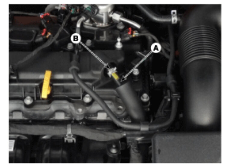

If its a hose coming out of the engine block, its most likely going to be some kind of PCV hoses. On newer vehicles they direct positive crankcase pressures to all kinds of places, but its important that its not blocked off and is routed to the correct intake position, that positive pressure needs some place to go, or it will start pushing out any seals in the lower end of the engine block, such as the front or rear main seals. Thats how those seals prematurely start leaking.
These are the PCV diagrams and really the only vacuum hose diagrams I see in Service info. Sounds like they might be a bit hacky when it comes to repairs at that location.
If you can pull up live engine data, and monitor the rear Oxygen sensor voltage, or graph its voltage is better, but get the vehicle up to speed, such as getting on the highway for a couple of minutes, so the engine gets up to temperature, before you exit, give it heavy throttle so youre not running on the electric motor, this way you should be pulling on the combustion engine, and when you let off the gas pedal suddenly, the fuel injectors should go to Fuel-Cut mode and actually shut off until you slow down enough where the engine needs to return to an idle, during de-acceleration fuel cut off, the rear Oxygen sensor voltage should go full lean, meaning almost 0volts. If you have the sensor data graphed you should see the rear 02 take a dive from its steady 600-700mv to less than 200mv (or 0.2v),
my truck goes all the way to 0volts on decel fuel cut off. Its a way to check the rear 02's operations, and its the way the ECM is doing it as well, but again you are correct about a possible Cat issue. (6th diagram shows some info about fuel cut off and that P0139).
For a Cat fault, you may notice the rear 02 fluctuating at a higher rate, (0.2v-0.8v-0.2v etc) when it should be at a more steady 0.6v-0.7v range. Of course noticing some of this will not be conventional with a hybrid, since youre not always going to be running on the gas engine. But under heavy throttle it should switch over to the gas engine for more power.
The hoses you mentioned may be part of the issue here though as well, without the vacuum hoses all sealed up and routed properly, that will throw off the ECM's self test results. It may cause the rear 02 to be below the 0.6v threshold that is called for in the code criteria. Looks like another thing they may need to correct, if it wasnt like before going in to them,
The p0401 looks like the ECM measuring a reference pressure(so some stored predetermined amount) to intake manifold pressure during EGR valve closed and the manifold pressure. This test is run during Fuel Cut off of more than 10sec as well, so thats interesting, these codes are being tested for and setting for this same period of fuel cut off.
But another issue is that the wiring harness on this vehicle has been connected and disconnected how many times now. Thats not at all a helpful thing. Who knows how much the harness connectors have been rough handled, pulled and pushed on. Theres so many factors here.

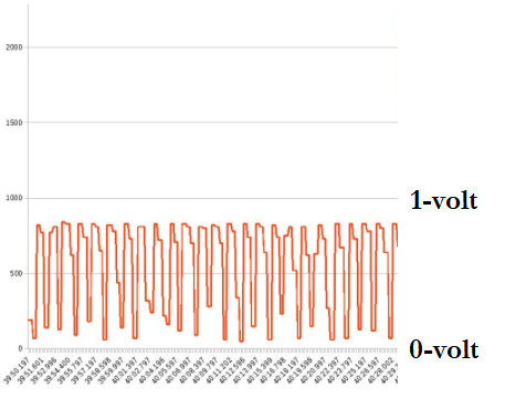

Another thing about monitoring the rear 02, is if voltage is fluctuating 0v to 1v roughly, when the frequency increases the ECM will eventually set a P0420, Catalyst low efficiency Bank 1. Which may need a certain number of drive cycles to set, thats when you'll know the cat is failing. Looking a little closer at the P0139 criteria, states the code is set "when the switching time is bigger than the limit value". Thats an increase in frequency of the rear 02 voltage fluctuating, so the P0139 might set before the P0420 Cat Efficiency code is set.
Thats something we would be looking for when diagnosing a cat failure, voltage swings such as the waveform below, or if its bad enough and causing drivability issues, a back pressure test to see if the cat has melted down and is restricting the exhaust.

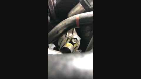

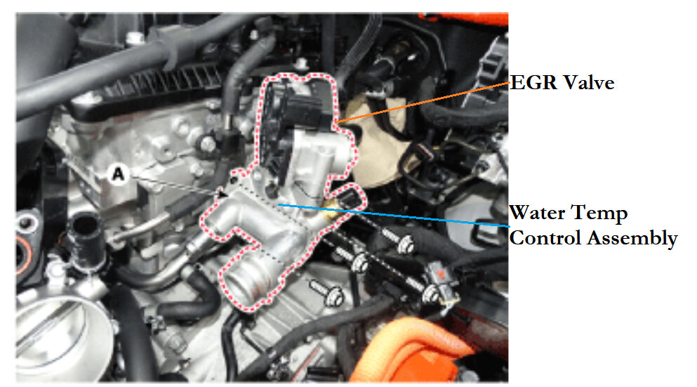

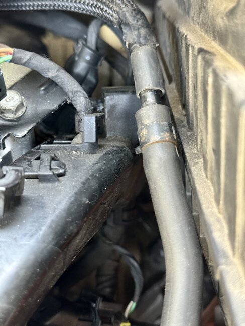

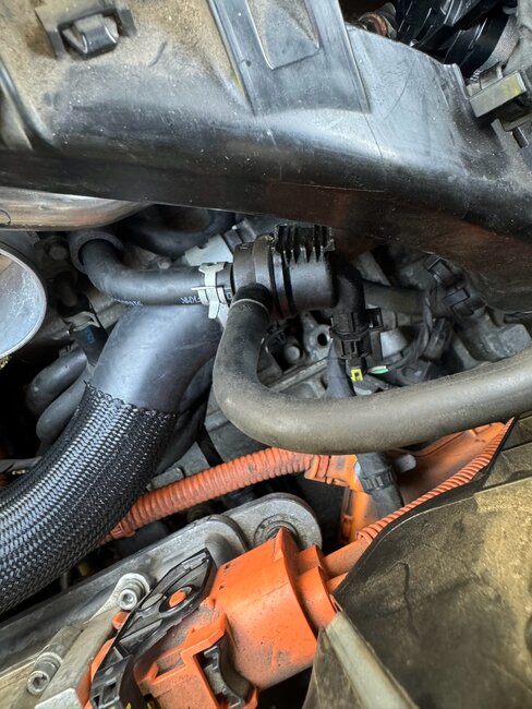

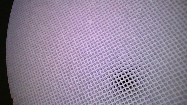

Pic 1’is the valve I think is clogged (PDFE) I think. Pic 2 is where it looks like something is missing. Pic 3 is the location of the valve which is aside throttle body above radiator hose near thermostat and EGR assembly under the air duct for filter.

I don't see any pressure differential sensor for the EGR valve in the wiring diagrams, but I do see a 4 wire MAP sensor which is what they are using for intake manifold pressure measurements, what are the wire colors on that sensor?
The EGR valve has a position sensor built into it as well, so it will have 5 wires.
May 1, 2024 at 5:57 AM
AL514
  • 5,654 POSTS

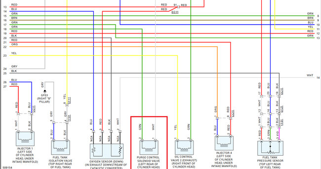

If the wires for that valve are green and white, and there's only 2, it's the Purge valve and should be closed when it's not active.
As for the 2nd picture, it depends on where those hoses go, it does look like something is missing there, at this point who knows what they have taken off or broken, but that valve you have off looks like the purge valve to me with those wire colors, the MAP sensor is 4 wires because it has a temperature sensor built into it as well. I'll post the wiring diagrams so you can check it.
May 1, 2024 at 6:00 AM
AL514
  • 5,654 POSTS
1st diagram is the Purge valve which pulls fuel vapor from the gas tank, should be closed when off. The 2nd diagram is the MAP/IAT sensor. with the 3rd the wiring going to the ECM. Hopefully they didn't remove anything, in the picture it almost looks like something is bypassed on that hose, but I can't really tell.

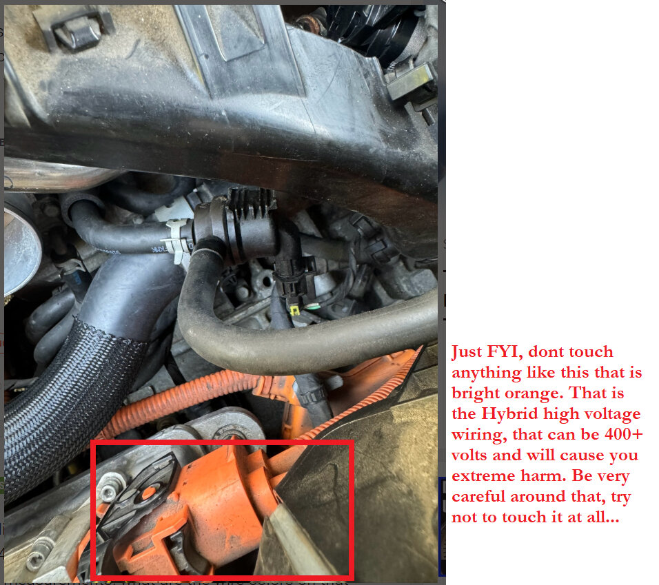

Don't touch this!!!

Thanks for the warning on orange, I’m way ahead of you. On that one. It’s usually the amps that cause most deaths. It only takes 1 amp to kill you. Back on track here. I’m not at the car now but I thought the map sensor was mounted right into the air box or duct between throttle body to air filter. I’ll double check that tomorrow. Ya I couldn’t find anything at all on it online. I’ll look some more it’s definitely carboned up inside, cleaned it a little the best I could but would much rather replace it.

PS. Schematics are my weak point. I don’t understand them nearly what I should. I get a little from them but not much. Oh, yes got my o2 sensor today., I thought cool. Not happy. I could not get that old one to budge. Easy to get at from the end. I even tried my electric impact gun on it that baby not budging. So, I’m even starting to believe the EGR restriction in the flow could possibly be the catalyst melted down on inside. Car feels very sluggish today.

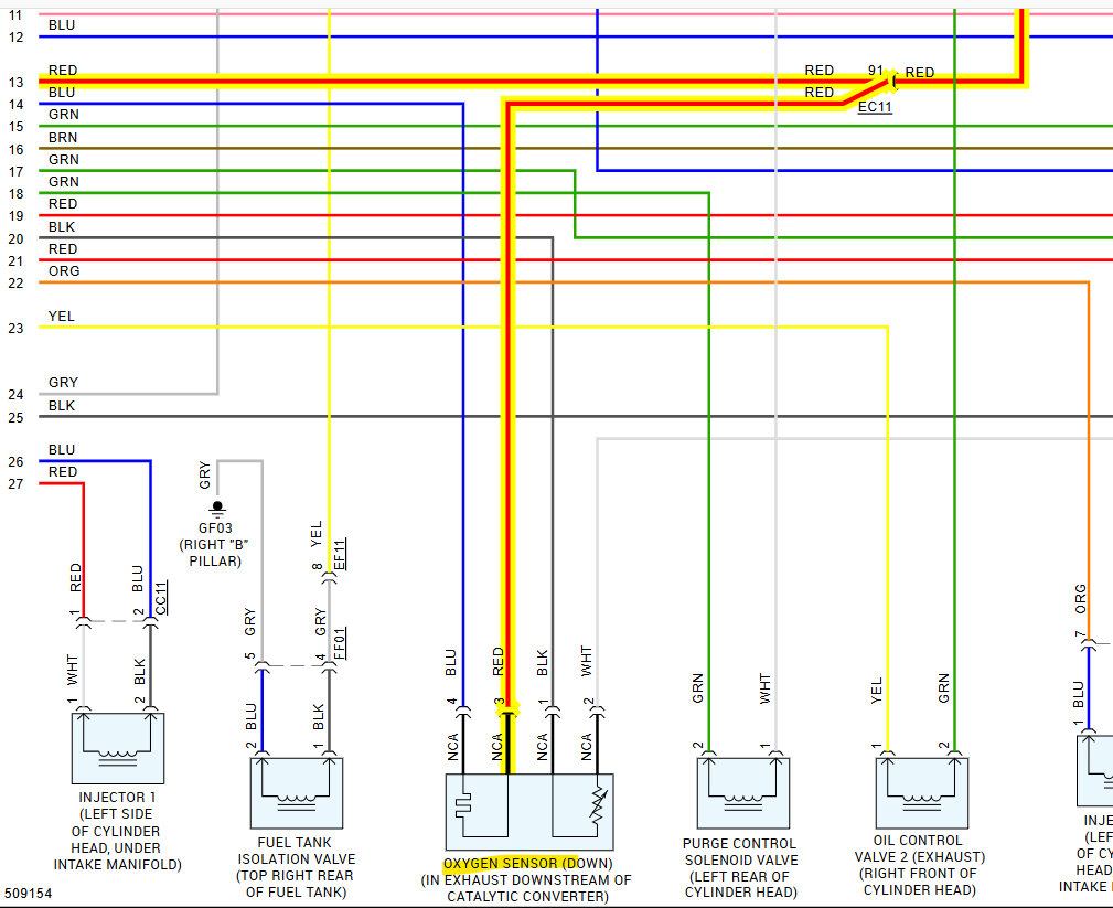

Yeah 02 sensors can be difficult to get out, I was surprised the impact gun didn't strip it out, Try getting it out when the exhaust is hot, just make sure to wear gloves so you don't get burned. They tend to come out easier when the pipe around them is hot and expanded some. The MAP sensor should be on the back of the intake manifold, the MAF (Mass Air Flow) sensor is the one that you would find on the air intake tube. It would be before the throttle plates, where a MAP sensor will be found after the throttle plates. (its Manifold Absolute Pressure) so it gives a reading of intake manifold pressure compared to atmospheric pressure. Hence the "Absolute" part.
So, there's actual carbon build up inside the Purge valve? When it comes to wiring diagrams, I post them mostly so people can compare the wire coloring to the component they are looking at. For the Purge valve I could see a 2-wire component with one green wire and one white wire. So, you can do the same for the MAP sensor, although the location I see is not the one in the picture, where something appears to be missing.

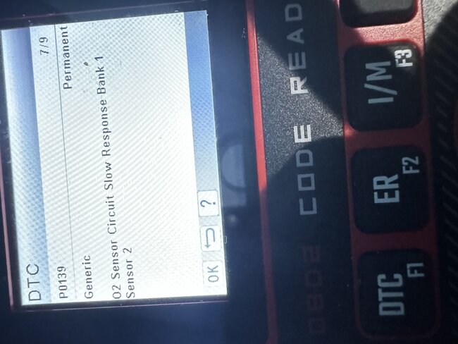

Took it out to check voltage on b1 sen2 not easy to read and drive with my readers on. The readings were between 0.040-0.805 anywhere in between. I’d get a high reading then let off and coast then go back on it and get a low voltage reading. If there is a certain way for me to perform this for voltage reading let me know.
May 2, 2024 at 11:28 AM
AL514
  • 5,654 POSTS
Is your scan tool able to record live engine data when driving? Thats the safer way to do things or have someone else drive so you can observe the live data. With a hybrid setup the difficult part is knowing if the gas engine or electric motor is doing the driving. So, diagnosis won't be the same as a normal combustion engine, I see there are some lamps to tell which mode the vehicle is in. EV mode for electric motor only and if that lamp is off, the engine is running.
But as for the rear oxygen sensor try to keep the throttle pretty steady when monitoring the voltage levels, remember when you let off the gas pedal the ECM will shut down the fuel injectors during fuel cut-off, its does that when de-accelerating because the engine doesn't need fuel at that short period of time, so the oxygen sensor is going to read lean during fuel cut-off. Such as coming off a highway and coasting to an idle, the injectors will be turned completely off at that point, it's to help with emissions.
I wouldn't mess with the throttle plates, some of them are not supposed to be moved by hand, it can damage the motor inside the throttle body. I would concentrate on the codes that are setting right now,
Do either of those codes come back right away if they are cleared out? I would suspect one of those settings during the EGR cooler leaking. And possibly not cleared out after the repair. Are they reading as "Current" codes or "History"? And intake manifold leak can cause the EGR code, if theres any hoses not properly sealed and manifold pressure is incorrect during the EGR test period its going to fail that test. I've been trying to find a decent picture of all the hose routing for the valve cover and intake, but many of them are drawing type diagrams, it's tough identifying that hose in your 2nd picture.

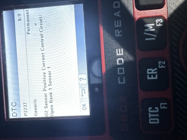

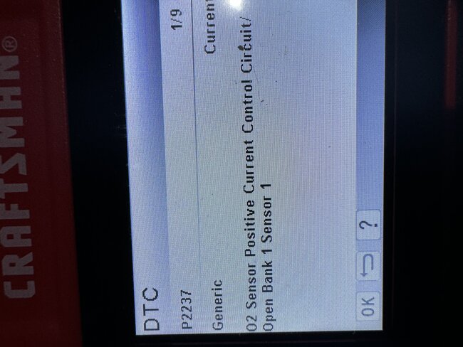

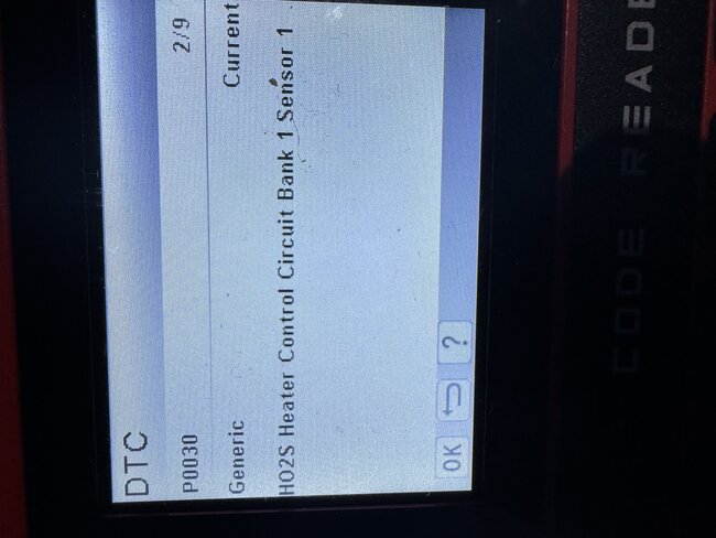

I’m really hoping you can prove me wrong but I’m going to assume the cat is bad and or the computer is malfunctioning. I do have other codes I’ve gotten previously before the last ones I sent there were 8 all together in that set of codes and the onboard monitoring had the VVT monitoring bank1 fail, EGR monitor fail, the evap monitor 0.020 failed the evap 0.090 passed and the b1 s2 had two tests fail and 2 tests passed, because rich to lean sensor time. This is the old sensor I replaced yesterday, I did not rerun the on-board monitoring with new sensor, just information that might be helpful to pinpoint my problem other than a dealership that once again gave me my car with more problems than it went in with. But it does appear the coolant loss through exhaust was solved.
May 5, 2024 at 12:24 AM
AL514
  • 5,654 POSTS

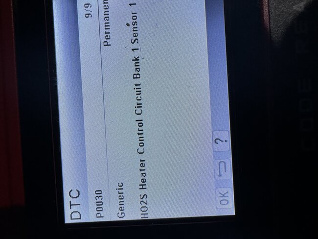

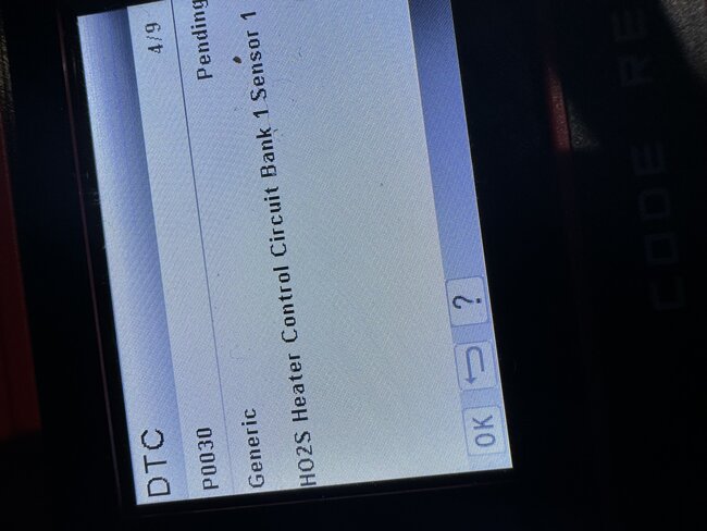

Oh goodness, for checking the Cat condition via the Oxygen sensor voltage you'll want to be monitoring the rear oxygen sensor, B1S2 for any voltage fluctuations,. Its the one that should remain pretty steady, the Front oxygen sensor (B1S1) is an A/F sensor (air/fuel ratio sensor). It is a much more advanced wide band type sensor. Thats why it has 6 wires, while the rear oxygen sensor only has 4.

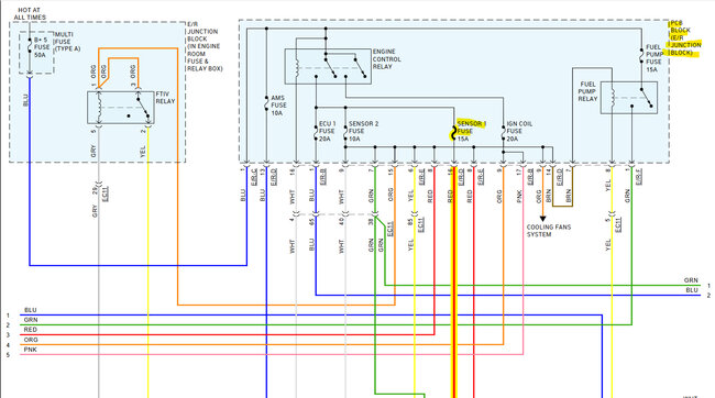

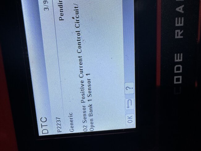

Since youre getting oxygen sensor heater circuit faults now, Im not sure why youre ending up with so many issues like this, but both B1S1 and B1S2 heaters are both fed by the same fuse. "SENSOR 1 Fuse 15amp". Both sensors are controlled by the PCM on the ground side of the heater circuit by pulsing the circuit on and off (PWM).
if the heaters are not working the sensors will not respond correctly and these codes will set. I wouldnt bother putting any more parts on this car until at least the oxygen sensors are not setting anymore codes.
But if the vehicle is leaving the shop with more issues than it went in with, they are responsible for those issues, you're running into too much here to diagnose in a logical manner. Especially with how many times electrical connectors have been apart. Every time theyre pulled apart and jammed backed together, now you have to worry about pin tension in each of those connectors, if you think about that, you could potentially be chasing a number of wiring issues. You're going to become overwhelmed by all this before you know it. It needs to go back and they need to figure out some kind of deal with you,
but check that fuse and see if it's blown.

Well, some codes are Pending some are Current or Permanent, so the PCM is seeing faults under different conditions. The PCM is monitoring intake manifold pressure when opening or closing the EGR valve, so its doesn't have to be an issue with the valve itself, there isn't that many components failing at once. Thats not possible. This is an electronic EGR valve, it does not have a control solenoid, it has an electronic motor and a position sensor that acts just like a throttle position sensor, The movement of the valve is 0v-5v.
The solenoid you pictured was the Purge valve, two wire green and white. You can't really mess up the oxygen sensor because the front one is 6 wire and the rear one (after the cat) is 4 wire. They are completely different types of sensors, the front is a wide band for more accurate air/fuel monitoring, the rear is a narrow band oxygen sensor.
I think you are dealing with a bunch of wiring problems, heat and vibration, driving time, etc. contribute to when and how much electrical connectors are heating up and cooling down, pins expanding and contracting, that's why codes are coming and going, the dealership has just been at this wiring harness too much, they replaced the engine over a coolant leak, that should tell you something.

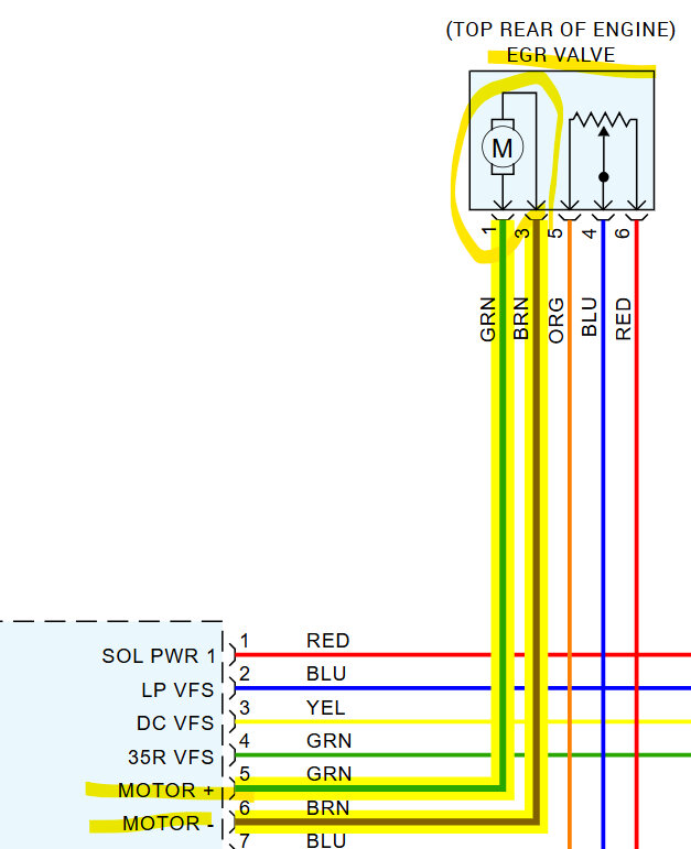

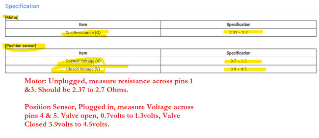

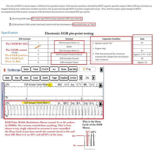

No, that is all incorrect. The oxygen sensors are strictly input devices, they do not control voltage to anything. The sensors only measure the amount or lack of oxygen in the exhaust, thats it. The EGR valve has no vacuum control at all, I showed you the diagram, it is an electric motor that opens and closed the valve. there is nothing to do with vacuum on modern vehicles. Dont replace anymore sensors until you find out if the oxygen sensor heaters are working. Neither sensor will function without their heaters. Ive posted service info on the operations of these systems, they do not function like older vacuum controlled designs. All that is gone. Dont spray any cleaner into the Purge valve, youre going to ruin the valve. You're disregarding all of the information I have posted so far, when a code sets it does not mean that component is the cause, its the result of incorrect operation of the component, therefore you need to follow service information on how to correctly test the component and its control system.
This is all that controls the EGR, two wires, thats it. You cant guess at how a circuit or component works, youre all over the map here, you cant fix something if you do not know how it works. Did you check the fuse for the oxygen sensor heaters with a test light yet?
Here is all the pin point testing for the EGR valve.

Yes that’s what is most likely going to happen. I did order an upstream 02 because I replaced the downstream and the sensor2 codes are gone. I seen somewhere that 02 senses the biggest issue is heavy oil consumption that’s burning off through exhaust and coolant from an internal leak ruins them too. I m going to replace that and the purge solenoid hopefully tomorrow if the come. Nobody had a 02 senses in stock on line I got sensor and purge solenoid cheaper then just the sensor in an auto store. I’m thinking the upstream is giving the PCM wrong readings so the pcm is adjusting fuel and air mixture incorrectly which also will affect the voltage and vacuum to open the valves correctly in the EGR valve assembly, I’m probably wrong, I usually am but I’ll let you know either way. If this doesn’t work it’ll go in shop somewhere, wording not my strong point and it might be there or the computer itself.

Don't put a cheap upstream sensor in (B1S1). Only use an oem,. These A/F ratio sensors are wide band sensors that are extremely accurate in their measurements. They work off of current flow instead of voltage like the rear 02 does. The EGR valve assembly does not work off of vacuum in any manner at all. Im not sure why you keep mentioning vacuum when it comes to the EGR valve. The EGR system only opens and closes a small electric motor to allow a small amount of exhaust gases into the intake manifold under heavier engine loads. The added exhaust gases are introduced to strictly lower combustion chamber temperatures and this prevents NOX gases from being produced. NOX is a harmful emissions gas which, by law, needs to be extremely low. Thats why the EGR tubing goes to the intake manifold. The code is most likely setting because there is a leak somewhere thats skewing the test results. If theres an intake manifold leak, and the PCM opens the EGR valve during its self test, the PCM will not see enough pressure change during the EGR opening because the intake leak has already lowered pressures too much, the PCM will then conclude there is insufficient flow, because the pressure is already too low to begin with.
Pull up your live engine data and look at the Long and Short Term Fuel Trims at idle and 2500rpm, but try to check this when the combustion engine is running, not the electric motor. If there is an issue with the front AF sensor giving incorrect data the Fuel Trims will be off. Fuel Trim is the air/fuel ratio compensation.
Fuel Trims will also be effected if there is an intake leak. This is probably the cause of the p0139 code as well, unless the oxygen sensor heaters are not working. If the heaters are not working, it doesnt matter how many times you change the sensors, if theres no power to the heater circuits the sensors will just sit there and do nothing. >>> Fuse blown?

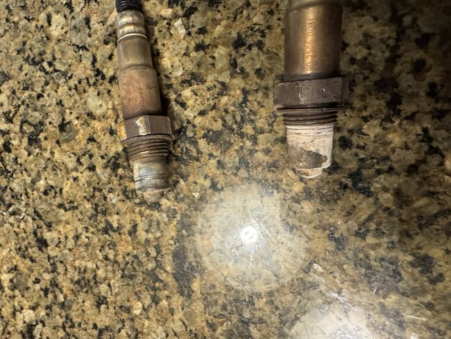

Hey Al, got parts today and put them on. I cleared the codes , sometimes when I clear them one or two might hang in there after I cleared them so I didn’t recheck it after I cleared them. Cleared them 8 all together. Took car out only. 4-5 miles so who knows what tomorrow will bring. It did feel a alot more responsive then it felt in a long time. Come home light still out. Gas milage went up to 39.8 mpg which I didn’t see in a long time, it’s been hanging around32-36 mpg. Reran the code scanner and I have as of now 1 code I can’t remember what one it was po138 or po139 just can’t remember. It’s definitely b1s2. I’ll know more tomorrow after work when I rescan it. I’ll attach a photo of the sensors . The upstream has a funny grey white coating on it I never seen before, perhaps you might recognize it, the solenoid I replaced I’m not sure on. The new one you can’t blow through but the old one you can blow right through, possibly cause warm? I haven’t a clue, i figured they worked off voltage. Anyway it’s a definite improvement on power and gas milage. Not sure either if that senor downstream has to cycle 1 or 2 times to not show on a scan, also when both o2 sensors die at same time I seen it’s usually caused by oil or coolant getting in there some how. If my EGR valve was clogged and both sensors went bad what are the odds of converter being clogged enough to throw downstream sensor voltage high? Thanks just curious on your input. Dealers way to expensive for converters.

That white carbon is due to that coolant leak. The Purge valve with the green and white (2 wires) should be normally closed when it's unplugged. So if you can blow through the old one, then its no good. Your scan tool data should list the EGR position in engine live data, and if you pull heavy throttle you should see the EGR position opening, Its used under heavy load/ heavy throttle because thats when NOX gases are produced. I thought they had replaced the EGR valve already?
