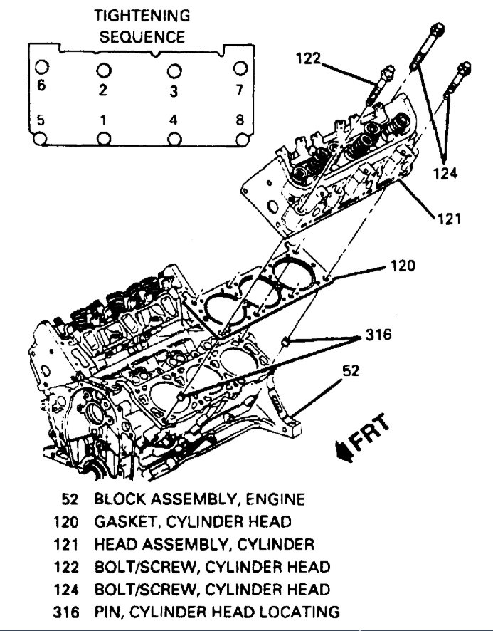

I started the car to leave work the other day and in the time it took to text my girlfriend to tell her I was off and about to head home I looked down and the car was starting to overheat. I topped the coolant off and drove home approximately 7 mile. It didn't overheat going home but almost shut off pulling into the parking lot. I shut it off and checked the oil and coolant and found coolant in the oil. Would a sealer work here or which road should I take? Any help is very appreciated. Thank you all

I have read both of those and watch the video before I posted my question. My coolant level after topping it off completely full after driving home from work was extremely low as well as chocolate milk foam 3/4 of the way up the dipstick.

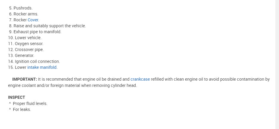

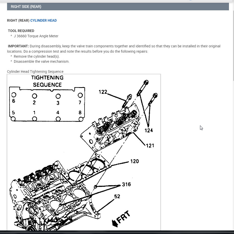

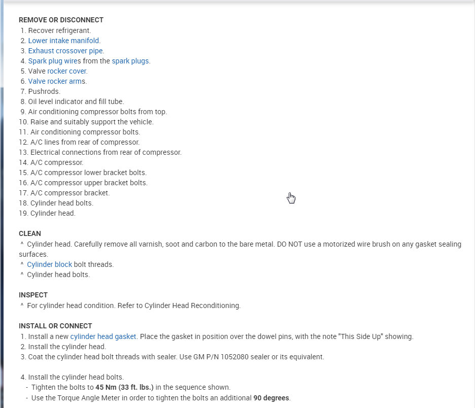

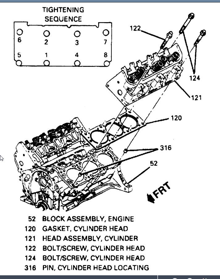

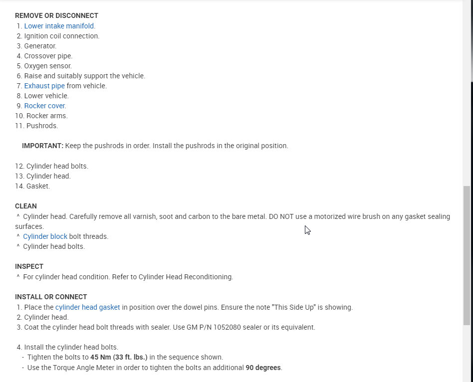

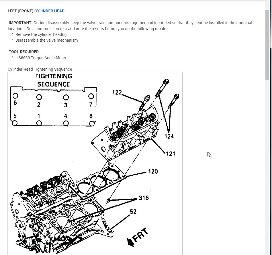

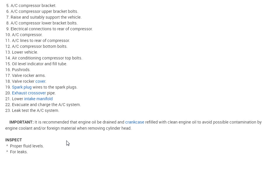

Okay. I think it is safe to say you have a head gasket issue. The issue you have at this point is which bank, front or rear? To find this we need to do a compression check or cylinder leakage test to identify which cylinders unless you want to do both banks. Clearly it is only necessary to do the one that is failed so I would highly suggest trying to narrow this down.
I included the process for both heads in case you choose to just do both sides.
Let me know what questions you have.
