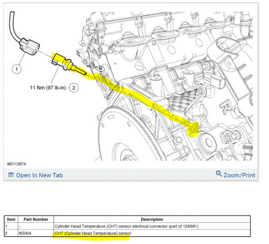

The coolant light came on and the a few miles more check engine light came on. Car drives fine. Took to dealership got coolant flushed and oil change. Lights still on. Car drives fine. Dealership says due to pandemic they are 3 weeks behind to do diagnostic. They say could be just the sensor gone bad. What could be the problem?

It was the CHT because I got a code 1299. I did get one, however I can’t locate where it goes. Do you know where it goes on a 2014 mustang got?

I assume this is a 5.0L. If it has the 5.8, let me know.
The CHT is located in the rear of the right-hand cylinder head. I attached a pic below which shows its location.
See pic below.
