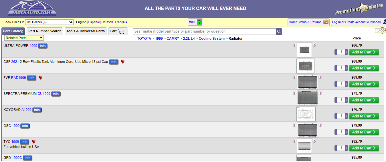

If you need to get a new radiator, they aren't too expensive. I attached a pic from Rockauto.com below so you can get an idea of the price. Plus, I can get you an additional 5% off if you need one. And just FYI, I am in no way affiliated with Rockauto.com. I just have purchased a lot from them over the years. The only issue I had with the purchase of a radiator is one was damaged in shipping. I have a feeling this is the issue based on your description. If you could upload a few pictures of the damage to the radiator, it may help me.
