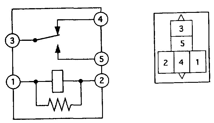

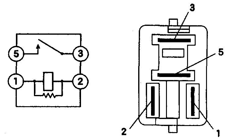

Here are the directions for testing the cooling fan relay specific to your vehicle. Note: you will need a multi meter. I will provide links that show how to use the tools needed at the end of this post. The first two pictures correlate with testing the relay. The relay can be found under the left side of the dash in the relay/fuse box.
INSPECTION
1. COOLING FAN RELAY
COOLING FAN RELAY NO. 3
a. Inspect the cooling fan relay continuity.
1) Using an ohmmeter, check that there is continuity between terminals 1 and 2.
If there is no continuity, replace the relay.
2) Check that there is no continuity between terminals 3 and 5.
If there is continuity, replace the relay.
3) Apply battery voltage across terminals 1 and 2.
4) Using an ohmmeter, check that there is continuity between terminals 3 and 5.
2. COOLING FAN RELAY NO. 2
2) Using an ohmmeter, check that there is continuity between terminals 3 and 4.
3) Check that there is no continuity between terminals 3 and 5.
4) Apply battery voltage across terminals 1 and 2.
5) Using an ohmmeter, check that there is continuity between terminals 3 and 5.

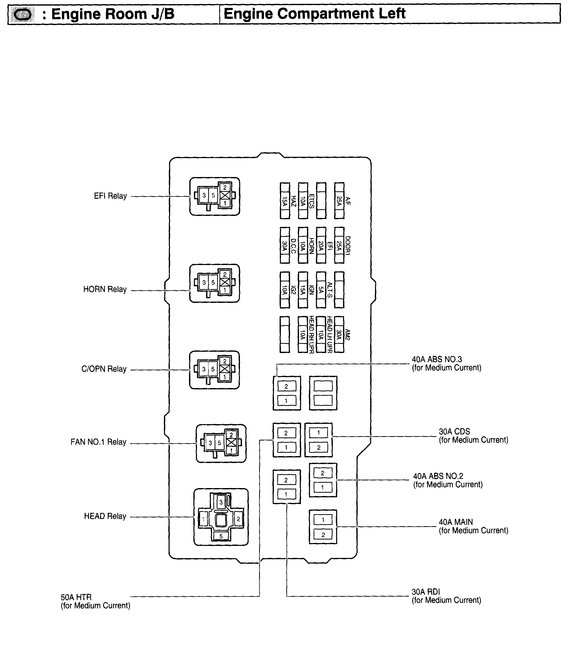

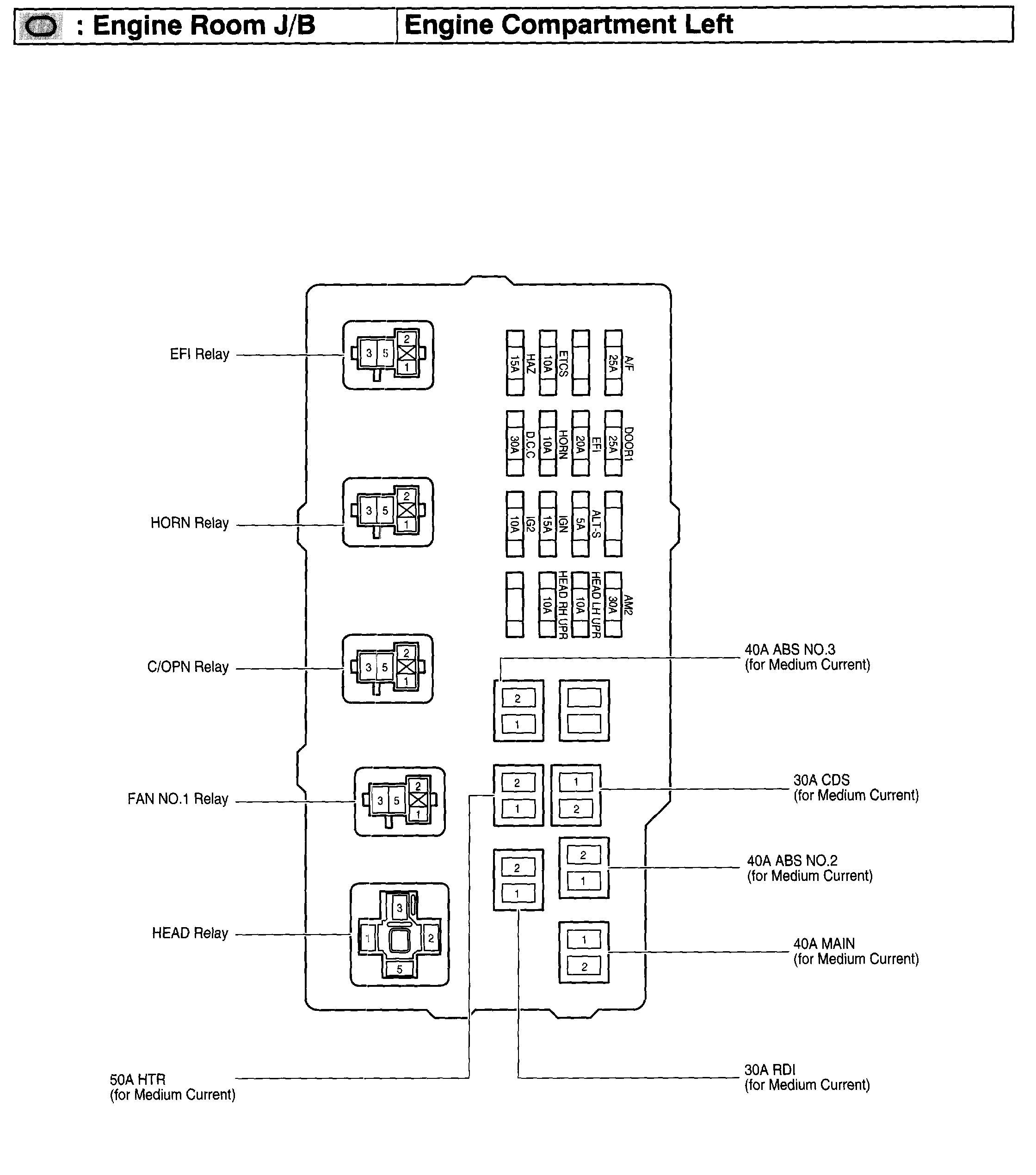

Picture 3 is the fuse / relay box located under the dash on the driver's side. It has the relays that need checked and also, check the 30 amp RDI fuses to make sure they aren't blown.
If the fuses and relays are good, the next thing to do is actually apply power directly to the fan motor connector to determine if it works. However, make sure to check the wiring and connectors to make sure they are in good condition and not corroded when you take the plugs apart.
