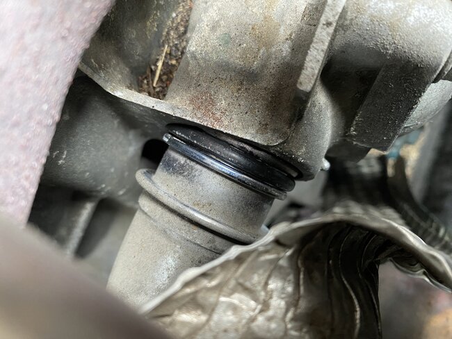

So, I had to fill my car with water after putting a new belt on to drive down the road and get coolant for my car and when I went to fill it was leaking behind the exhaust manifold to the left of the thermostat. I’m not sure what part this is to be able to fix it, but I’ll provide a video to show.

It’s the inlet suction hose right behind the exhaust manifold.

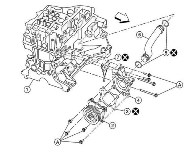

You mean #6 in the image? That has O-rings on the end, but if it's leaking in the middle, it possibly rusted through. Replacement is basically drain the coolant, remove the water pump housing itself and then you can get to the pipe. Remove it, be sure the seals are on the new one and reverse the process.

The old one is leaking because it’s not fully in the thermostat housing. I just changed the belt and took the water pump out to see what shape it was in. Now it’s really leaking. So, I’m not going to have to take off the manifold to reinsert it?

Did you remove only the pump or the pump housing that bolts to the block? The pump should only have 4 bolts (item 2) and comes out the front of the housing. In your case you will need to remove item 4 from the side of the engine. Then you can remove the pipe, check/replace the seals and re-install it with the pipe ends fully seated. It's a tight fit but can be done with the manifold on. Pull the alternator and you should be able to get to the 4 bolts.

The tube could be rusted through causing a leak or misalignment. Either way you need to remove the coolant tube to inspect or reinstall. Please use the image Steve has featured above.

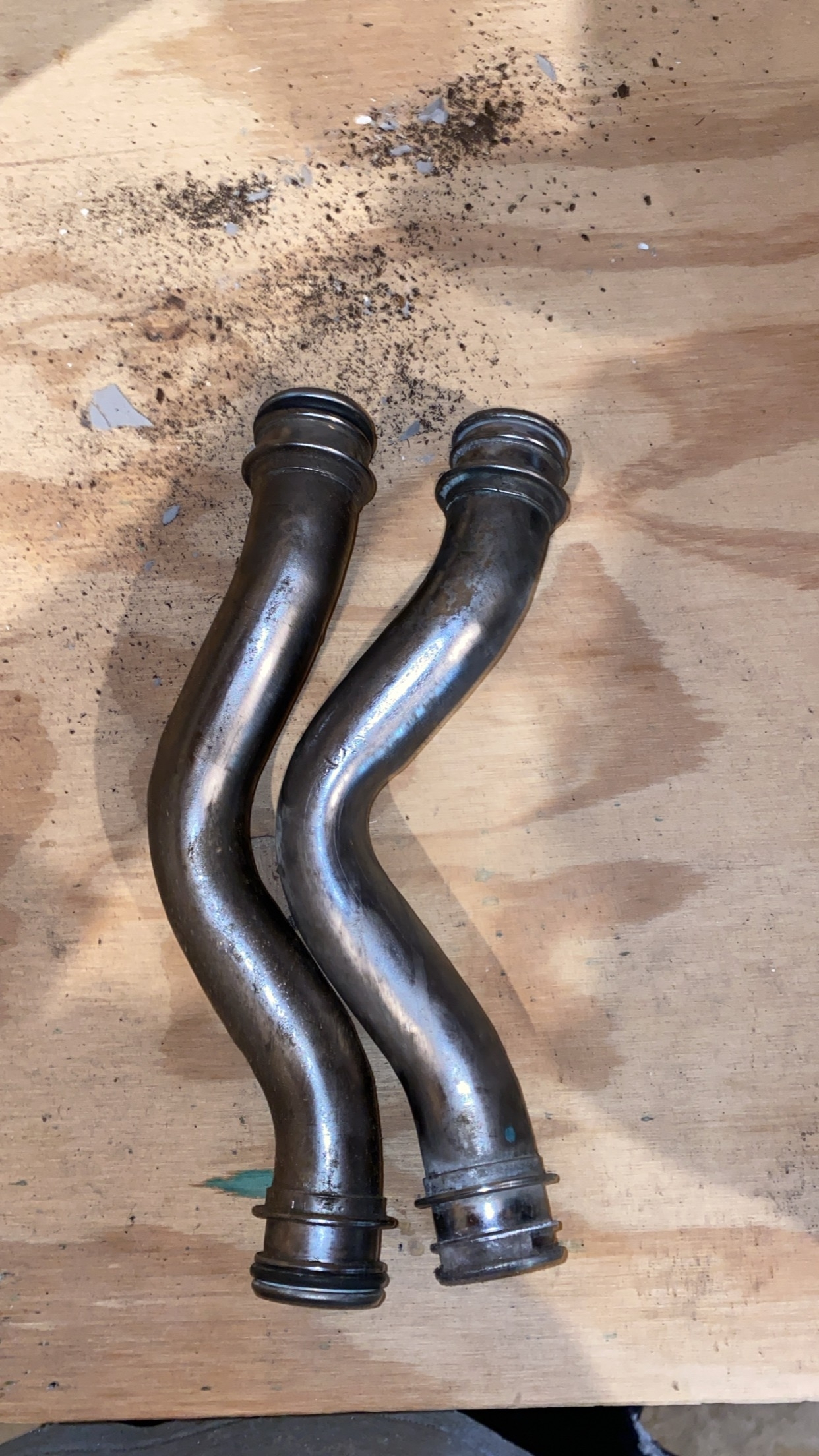

I got the tube off; it was horrendously bent. I don't know how but I am ordering a new one. Thank you guys!

Yeah, I’m not sure. Me and my buddy tried installing back on both ways and it was still not flush on either side to the pump.

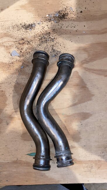

You guys can guess which is the new and old one.
Dec 19, 2023 at 8:23 AM
STEVE W.
  • 15,345 POSTS
That's got a bit of a curve... The new one should seal it a bit better.
