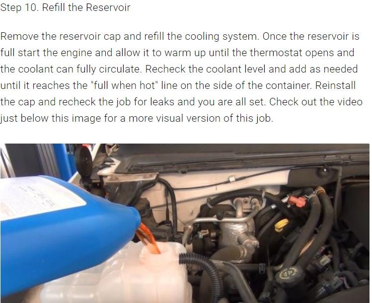

With that being said, I feel the shop needs to determine what was actually in the bottle. Please keep in mind, the overflow bottle should not be completely full once the vehicle cools. Are you sure it did not appear to have something in it when it could have been partially empty?
I do not know if this will help, but here is a link discussing how to replace a reservoir. As you page down to the refill section, it explains how to make sure it is full. Let me know if that may be what you saw.
https://www.2carpros.com/articles/coolant-reservoir-replacement
I hope this helps and does not make things more confusing. However, once water and coolant are mixed, they cannot separate. Therefore, either the bottle was partially empty or something other than water was put in.
