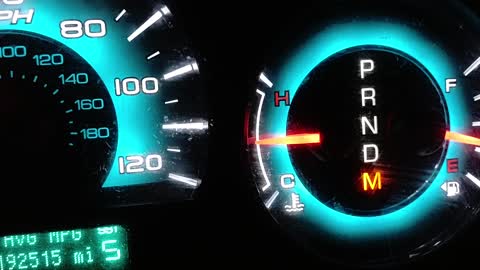

As I'm driving the car, if I'm under a heavier load the cars coolant temperature gauge will rise. If I stay in the throttle long enough it will rise to around 3/4 staying under the red, but not actually overheat. If I lift off the throttle it almost immediately returns to just under half on the gauge in less than 10 seconds. The coolant pipes aren't any extra hot. The heat stays warm. The fans are on high during the instance. It won't happen until the car has actually gotten to operating temperature. The gauge doesn't rise while it sits, and it doesn't rise quickly while warming up. There's white marker in engine bay says "hg 178642" The water pump and belt looks recently replaced. Thermostat has been replaced. It doesn't use any coolant or bubble when the gauge rises.

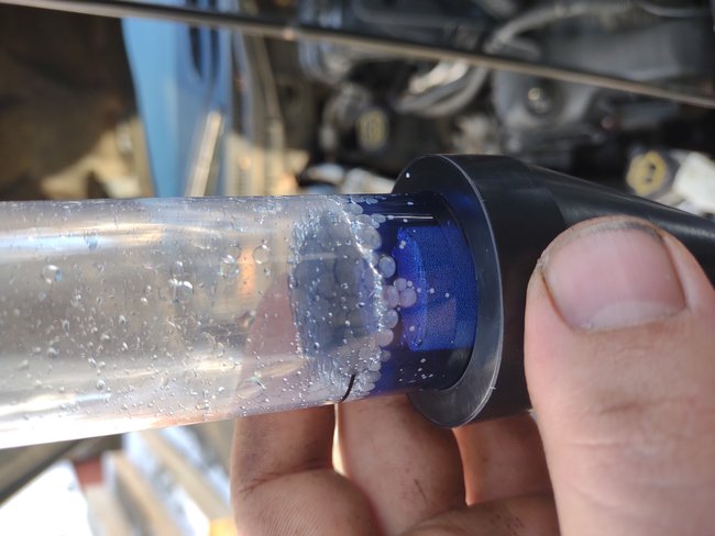

So, let's start with checking the head gasket just to be sure. So that means we need to start with using the chemical test that is shown in this guide:
I doubt you will find the other signs if this only causes an issue when you are accelerating so we need to get the engine hot and then rev the engine while using this blue chemical to see if you are getting any change in the color to show there are combustion chamber gases.

The coolant looks very clean, I've drained quite a bit doing the thermostat once and the gasket again a separate time. But a flush can't hurt. I bought the blue chemical and the block tester and tried that for a few minutes with the chemical staying blue. Then I had an idea to get the bubbles out. I used the big yellow spill free funnel and filled it about halfway with coolant and gave the car some revs with the heat all the way on. Some bubbles came out at first, but the coolant gauge still acts the same.

Can you get a recording of this gauge when this is happening? It should not be jumping. The gauge should be moving smooth and steady as the temperature is always being monitored and temperature changes don't jump. temperature changes gradually so your gauge should be moving smoothly so based on that, I think the sensor is the issue.

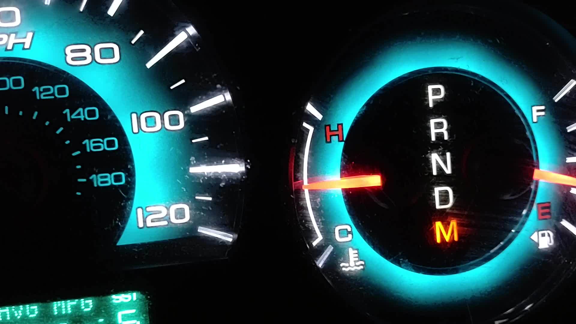

I started the video when I put my foot down. I kept it in fifth on the standard shift and went up a short hill. Roughly 5 seconds after I let off the gas pedal, you'll notice the quick downward movement of the needle. I guess it doesn't really jump around but just goes down rather quickly almost in 4 or 5 steps.
Dec 6, 2021 at 7:30 AM
That is a great video. Has it ever actually overheated? Doesn't look like it ever overheated so that is very strange operation which tells me it may just be a sensor issue.
Even when it is going up, it jumps in levels and is not a steady sweep up and down.
So, if there are no air pockets, no blown head gasket, doesn't overheat, then I have to think we have an issue with the sensor.

That's what I was leaning towards. You are correct saying it has never over heated. I can stay in the throttle say to be driving on the interstate and it'll stay high and never overheat.
Dec 7, 2021 at 7:35 AM
Yeah. That points to an air pocket most likely but could be a head gasket but the head gasket would normally cause the overheat.
However, it seems like you have eliminated those options all together so the last thing that makes sense is a sensor/gauge issue because it doesn't seem like it is actually getting that hot.
