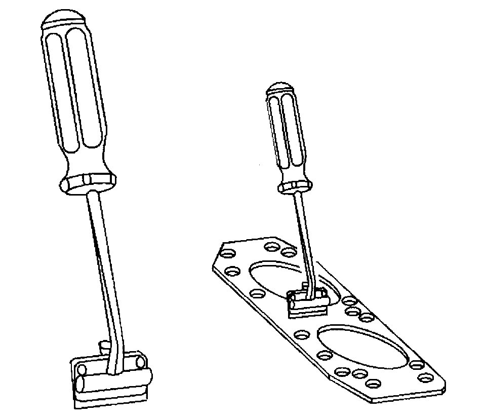

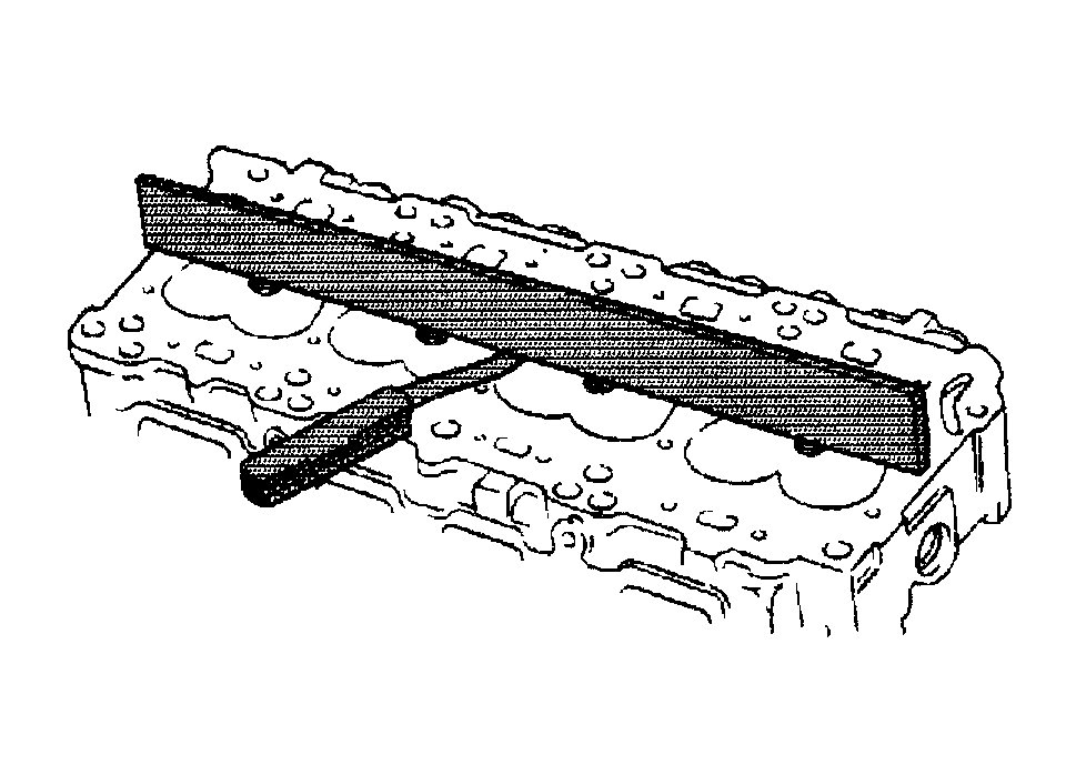

Honestly, I have a feeling you may be correct. First, lets check for a bad head gasket. Here is a link that shows how it is done:
Also, if the engine is cold, open the cooling system and start the engine. Does coolant shoot out? If so, you nailed it with the idea that compressed air is getting into the system from a head gasket.
If you find the gasket is bad, here are the directions for replacement. First will be the directions for cylinder head removal, then inspection, and finally instillation. All attached pictures will correlate with these directions.
I am only providing this in case you find the gasket is the issue.

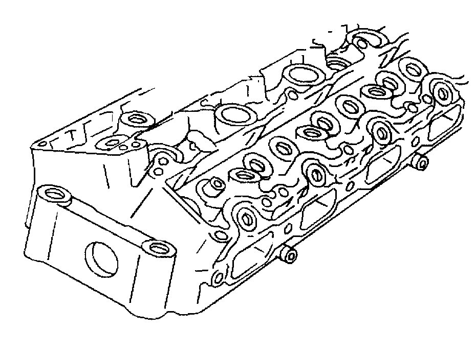

13. CYLINDER HEAD REMOVAL
^ Tools Required
- J 38188 Cylinder Head Broken Bolt Extractor Kit (if needed)
Pic 1
1. Remove the cylinder head to the block bolts. Follow the reverse of the tightening sequence.
2. Remove the cylinder head.
3. Remove the cylinder head gasket.
Notice: Engine damage may result if an abrasive paper, pad, or motorized wire brush is used to clean any engine gasket surfaces.

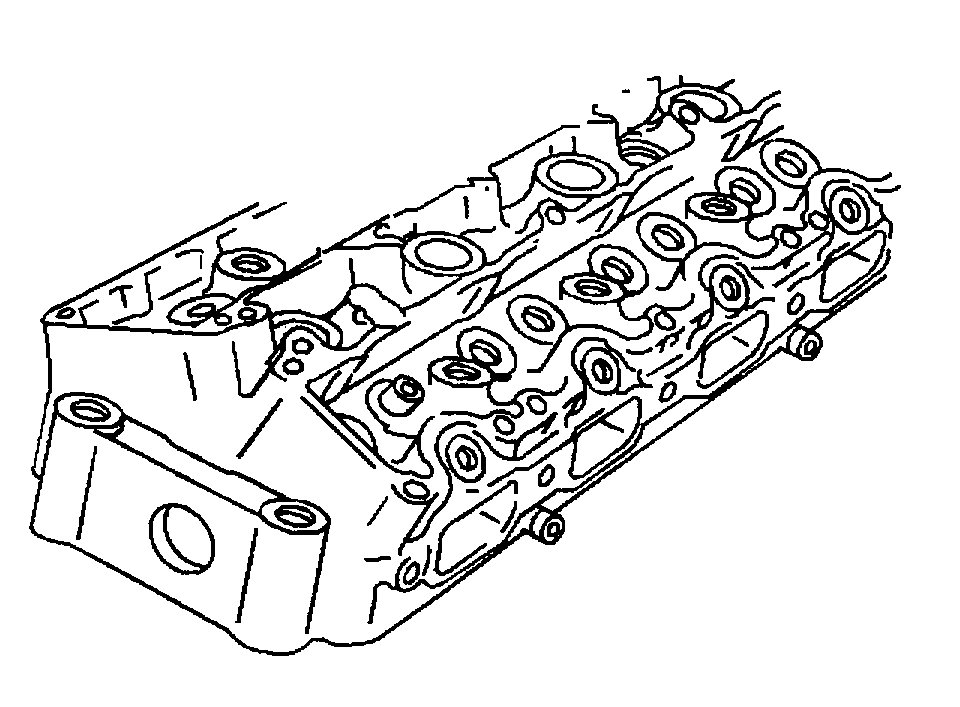

pic 2
4. Clean all of the gasket surfaces.
5. Use the following procedures when cleaning the cylinder head and cylinder block surfaces:
Important: Be careful not to gouge or scratch the gasket surfaces. Do not gouge or scrape the combustion chamber surfaces. The feel of the gasket surface is important, not the appearance. There will be indentations from the gasket left in the cylinder head after all to the gasket material is removed. These small indentations will be filled in by the new gasket.
^ Use a razor blade gasket scraper to clean the cylinder head and cylinder block gasket surfaces.
^ Use a razor blade gasket scraper to clean the cylinder head and cylinder block gasket surfaces. Do not scratch or gouge any surface.
Important: Do not use any other method or technique to clean these gasket surfaces.
^ Use a new razor blade for each cylinder head and cylinder block.
^ Hold the razor blade as parallel to the gasket surface as possible.
Important: Do not use a tap to clean the cylinder head bolt holes.
6. Clean the old sealer/lube and dirt from the bolt, the studs, and the bolt holes.
7. Clean the bolt holes using a nylon bristle brush.
Caution: Wear safety glasses to avoid injury when using compressed air or any cleaning solvent. Bodily injury may occur If fumes are inhaled or if skin is exposed to chemicals.
8. When cleaning the cylinder head bolt holes 1 - 8 use a suitable commercial spray liquid solvent and compressed air from an extended-tip blow gun to reach the bottom of the holes.
9. Remove any broken long cylinder head bolts using the J 38188.

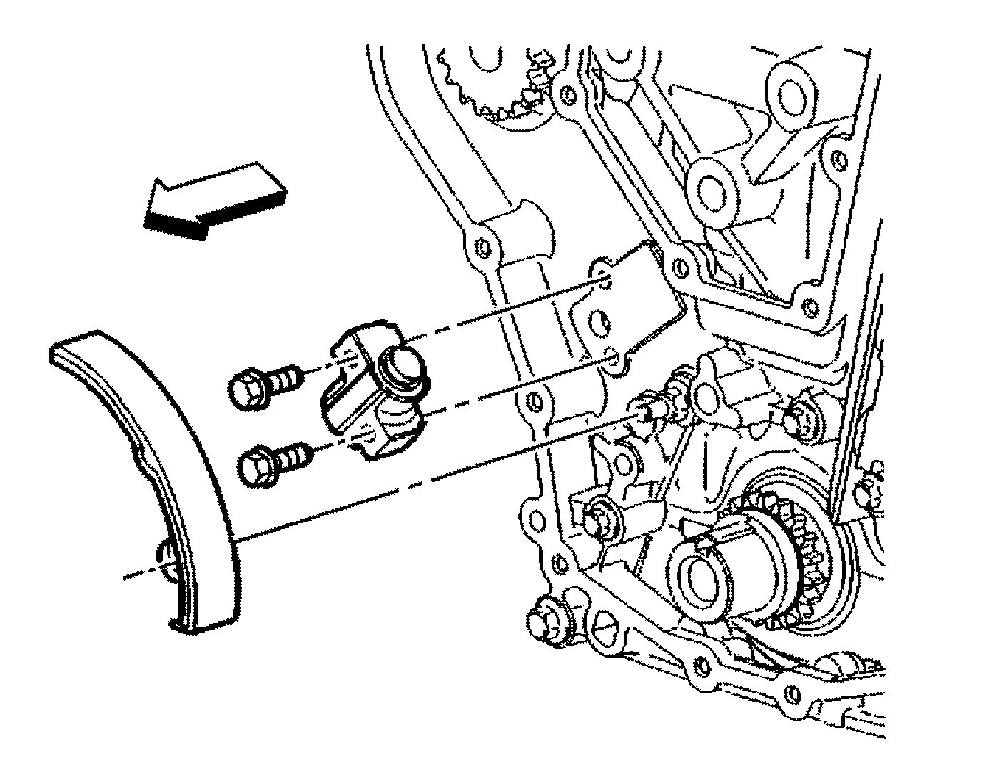

pic 3
1. Clean the valves of carbon, oil, and varnish. Carbon can be removed with a wire brush. Varnish can be removed by soaking the valves in Parts Immersion Solvent GM P/N 12345368 or an equivalent.
2. Clean the valve guides.
3. Inspect the valve stem for wear. The valve stem end may be reconditioned by grinding.
4. Follow the grinder manufacturer's instructions. Ensure that the new surface is perpendicular to the valve stem.
5. Inspect the valve keeper groove for chipping or wear. Replace the valve if chipped or worn.
6. Inspect the valve face for burning or cracking. If pieces are broken off, inspect the corresponding piston and cylinder head area for damage.
7. Inspect the valve stem for burrs and scratches. Burrs and minor scratches may be removed with an oil stone.
8. Inspect the valve stem for straightness and the valve head for bending or distortion. Use V blocks. Bent or distorted valves must be replaced.
9. Clean the deposits from the valve face. Inspect the valve face for grooving.
10. Replace the valve if the face is grooved. Valve faces cannot be machined. If worn or damaged, the valves must be replaced.
11. The valves may be lightly lapped to the valve seats.

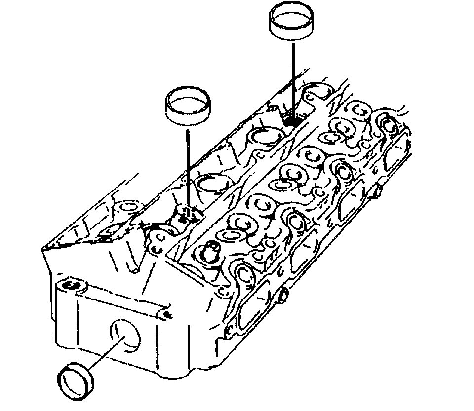

1. Use the following procedure to remove the cylinder head cup plugs:
1.1. Obtain a suitable self-threading screw.
1.2. Drill a hole in the plug.
1.3. Install the self-threading screw.
1.4. Pry out the plug and discard it.

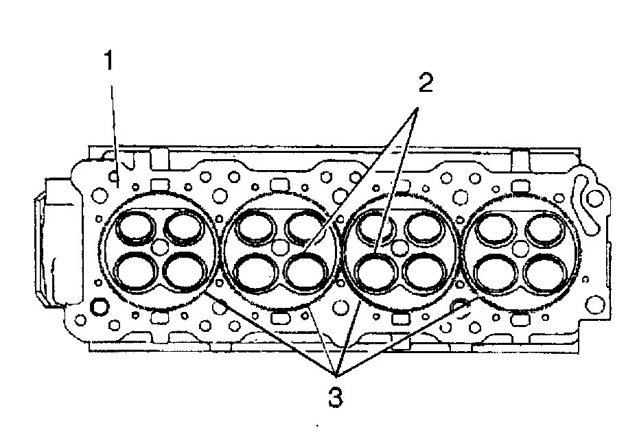

2. Inspect the cylinder head gasket and mating surfaces for leaks, corrosion and blow-by. If the gasket has failed, use the following faults to determine the cause:
^ Improper installation
^ Loose or warped cylinder head
^ Missing, off location or not fully seated dowel pins
^ Corrosion in the seal area around the coolant passages
^ Chips or debris in the cylinder head bolt holes
^ Bolt holes in the cylinder block not drilled or tapped deep enough
^ Other
pic 4
3. Inspect the cylinder head gasket surface.
^ The cylinder head may be reused if corrosion is found only outside a 4 mm (0.375 inch) band around each combustion chamber (1).
^ Replace the cylinder head if the area between the valve seats is cracked (2).
^ Replace the cylinder head if corrosion has been found inside a 4 mm (0.375 inch) band around each combustion chamber (3).

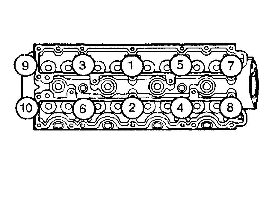

pic 5
12. Inspect the cylinder head deck, the intake, and exhaust manifold mating surfaces for flatness. These surfaces may be reconditioned by parallel grinding.
13. Use the following steps to determine the amount of reconditioning needed:
^ If the warpage is less than 0.076 mm (0.003 inch), reuse the cylinder head, but do not resurface.
^ If the warpage is between 0.076 mm (0.003 inch) and 0.25 mm (0.010 inch), resurface the cylinder head before reusing.
^ If the warpage is over 0.25 mm (0.010 inch), discard the cylinder head.
14. Inspect all the threaded holes for damage. The threads may be reconditioned with thread inserts.
15. Inspect the sealing surfaces.
16. Inspect the cylinder head cup plugs.

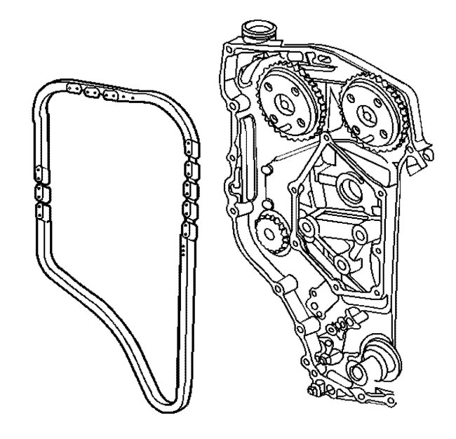

53. CYLINDER HEAD INSTALLATION
^ Tools Required
- J 36660-A Torque Angle Meter
pic 6
1. Install the cylinder head gasket to the block.
Important: Do not use any sealing material.
2. Install the cylinder head.
3. Lightly apply clean engine oil to the threads and the bottom side of the flange of the head bolt and allow the oil to drain before installing.
Notice: Refer to Fastener Notice in Service Precautions.
pic 7

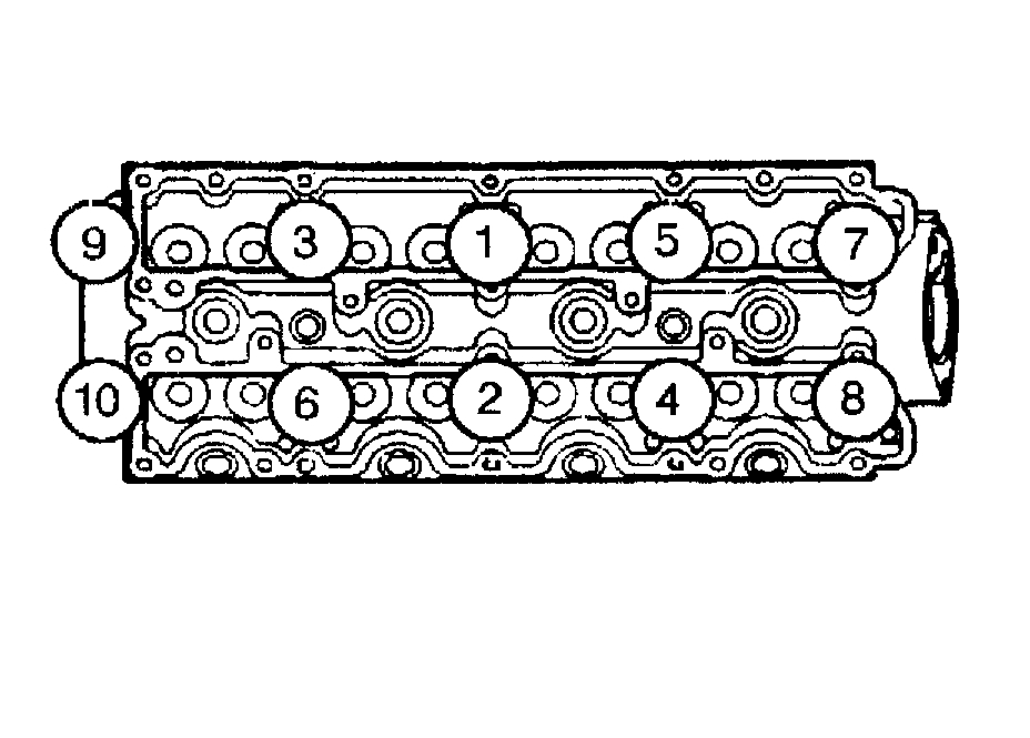

4. Install and tighten the cylinder head bolts in sequence.
^ Tighten bolts 1-8 to 65 Nm (40 ft. lbs.).
^ Tighten bolts 9-10 to 40 Nm (30 ft. lbs.).
^ Then turn all the bolts an additional 90 degrees in sequence, using the J 36660-A.

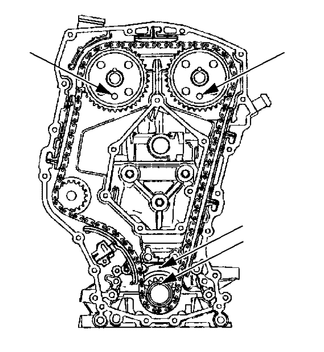

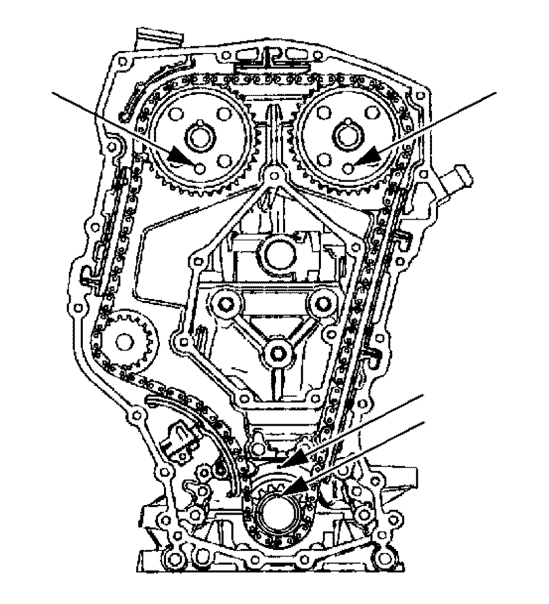

3. Rotate the crankshaft clockwise (as viewed from the front of the engine, normal rotation) until the camshaft sprocket timing dowel pin holes align with the holes in the timing chain housing.
pic 8
4. Set the crankshaft sprocket keyway pointing upwards. Align with the centerline of the cylinder bores. This is the timed position.

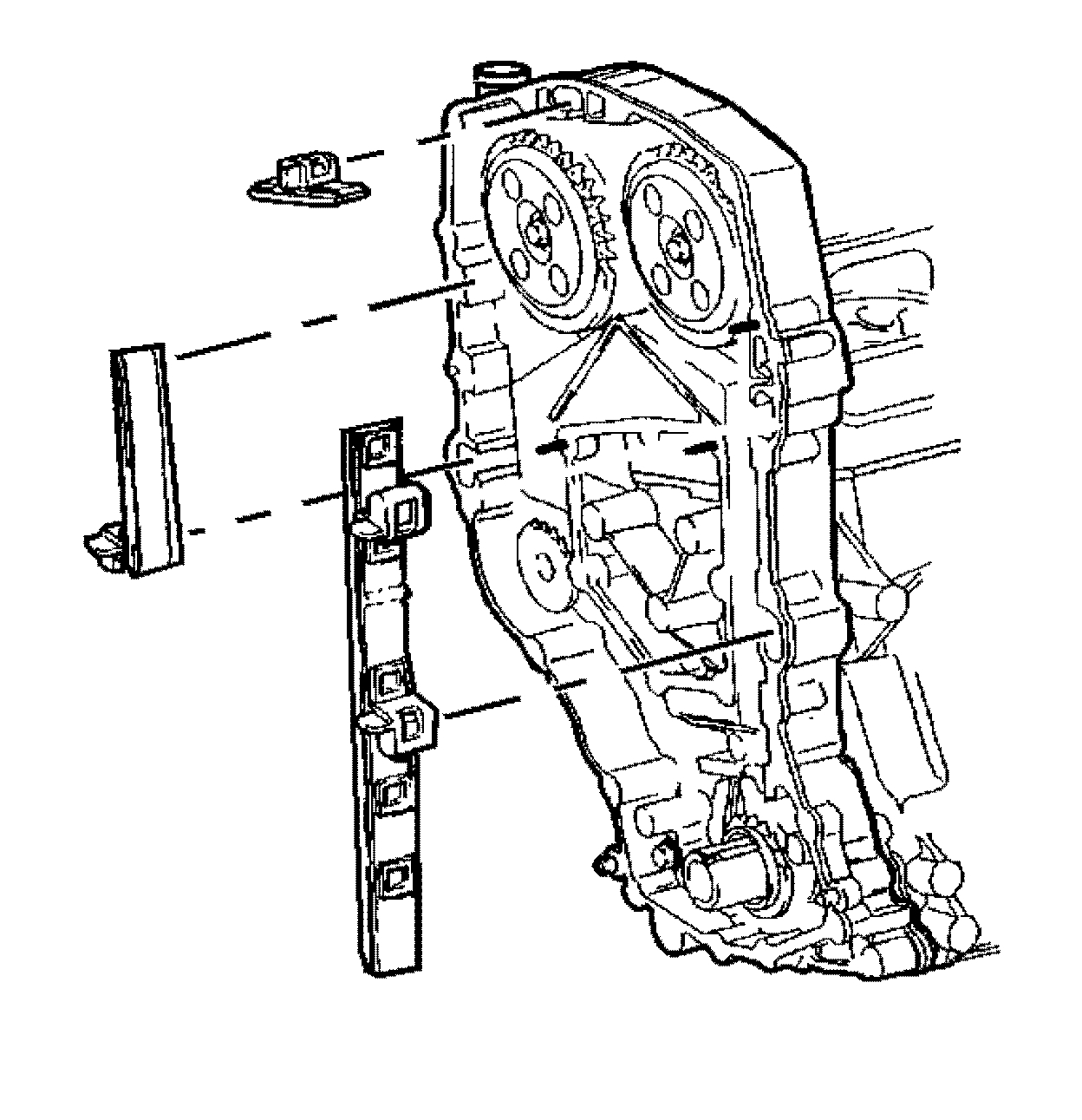

5. Remove the timing chain guides.

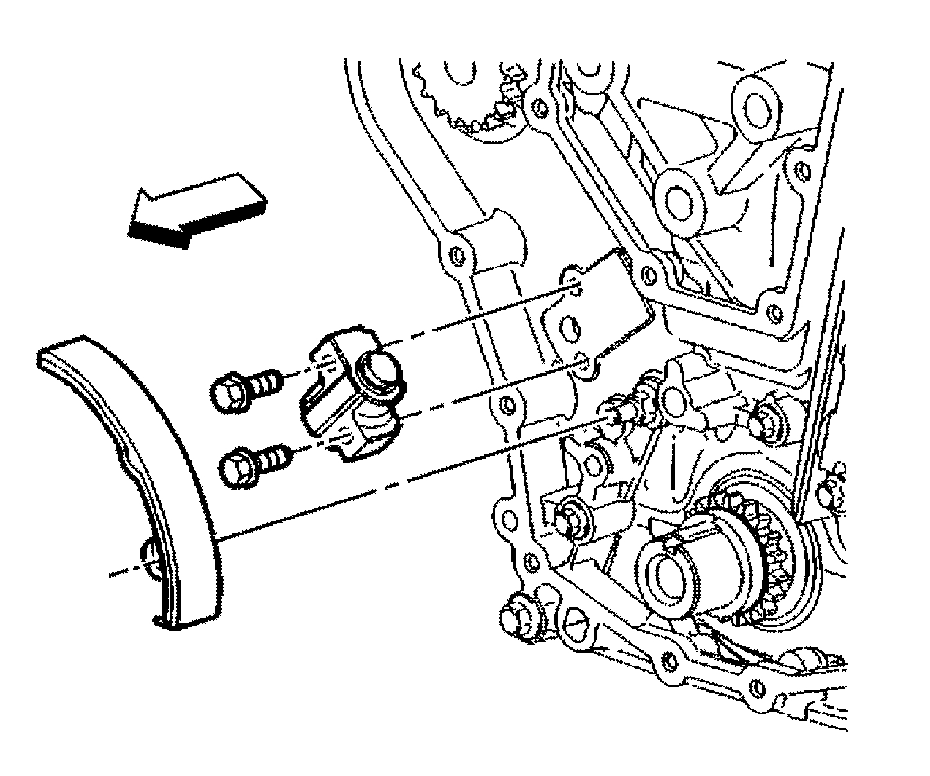

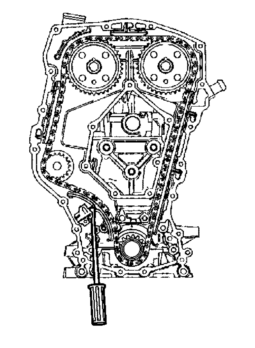

8. Remove the timing chain tensioner bolts and the tensioner.

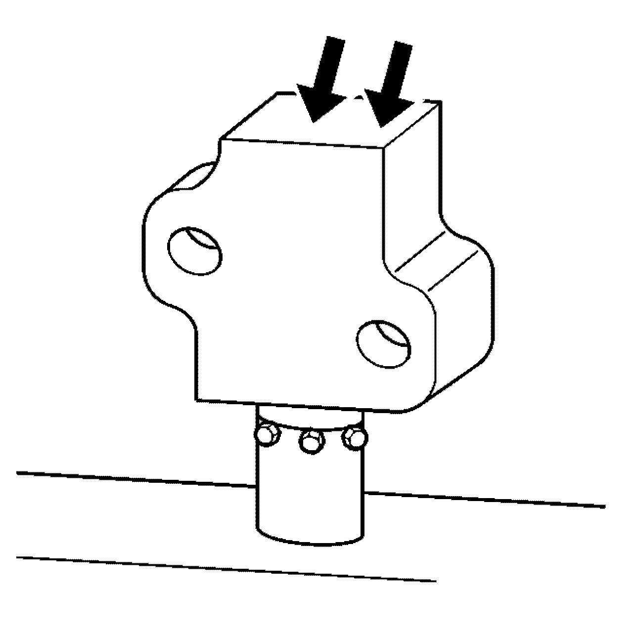

pic 9
9. Remove the tensioner shoe. Use a small locking ring plier in order to engage the hole in the locking tab and remove the shoe from the stud.

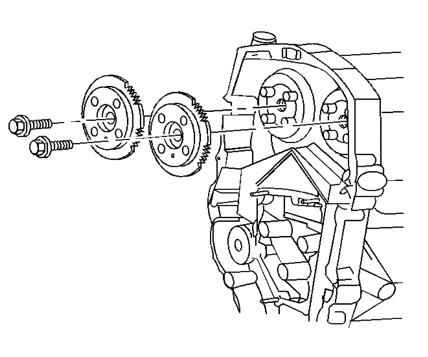

13. Holding the intake camshaft sprocket with J 39579 , remove the sprocket bolt and washer.
14. Remove the washer from the bolt and rethread the bolt back into the camshaft.
15. Using a 3-jaw puller and the relief holes in the sprocket, remove the intake camshaft sprocket.
16. Repeat this procedure for the exhaust camshaft sprocket.

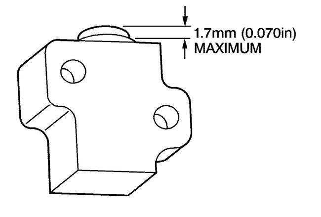

10. Check the plunger to make sure the plunger is out of the cylinder at the correct dimension. The correct dimension for the plunger to extend out of the cylinder is 1.7 mm (0.07 in.) maximum.

12. Install the timing chain tensioner shoe on the stud.
13. Apply hand pressure to the timing chain tensioner shoe until the locking tab seats in the groove in the stud.
14. Tighten the timing chain tensioner bolts. Do Not overtighten.
Tighten the bolts to 10 Nm (89 in. lbs.).
pic 17
Important: the timing chain tensioner is not released from the installation position, engine damage will occur when the engine is started.
15. Release the timing chain tensioner plunger.
15.1 Using a flat blade screwdriver, cotter pin remover, or similar tool, press firmly against the face of the timing chain tensioner plunger.
Important: If the timing chain tensioner cannot be depressed, the plunger is not properly reset and the procedure for resetting the timing chain tensioner should be repeated.
15.2 Depress the timing chain tensioner plunger until the plunger is bottomed out in the bore of the timing chain tensioner.
15.3 Release the tensioner plunger. the plunger should press firmly against the back of the timing chain tensioner shoe.
16. Remove J 36800 from the camshaft sprockets.
17. Rotate the crankshaft clockwise 2 full rotations. Align the crankshaft keyway with the mark on the cylinder block, and reinstall the alignment dowel pins. The pins should slide in easily if the engine is timed correctly.
pic 18
18. Install the timing chain guides.
19. Install the engine front cover. See: Timing Cover > Procedures > Engine Front Cover Replacement
20. Connect the negative battery cable.
Tighten the bolt to 16 Nm (12 ft. lbs.).
