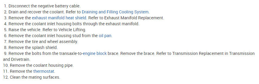

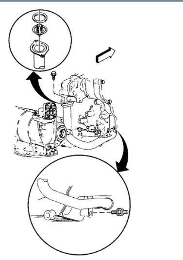

I have a 00 Olds Alero V6, My car takes a while to heat up in the mornings, when it finally warms just sitting idle on warmer days the hands goes beyond the normal, and driving it starts to go towards the Hot indicator. I only had this car about a year, I've had the water pump replaced, but I don't think my thermostat was changed out. No leaks, air is cold, heat is hot, coolant level is fine.

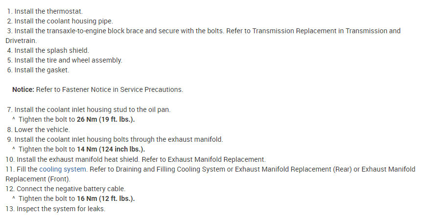

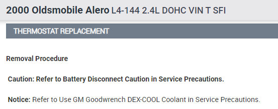

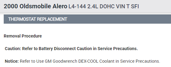

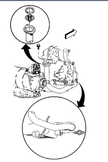

Here is the information you requested. It might be a good idea as a safety precaution to change the thermostat since you don't know exactly when it was replaced last or the age of it. Here are a few tutorials for you to view on how to drain and flush as well as changing a thermostat:
https://www.2carpros.com/articles/coolant-flush-and-refill-all-cars
I've attached picture steps below on how to replace the thermostat on your car. Hope this helps and thanks for using 2CarPros.
