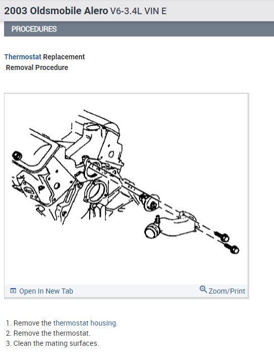

Where is thermostat located?
Jan 14, 2017 at 3:26 AM
SQM
  • 6,383 POSTS
The thermostat is located on the top of the engine.
If you follow the upper radiator hose (large diameter hose) to the engine, it is located inside that housing mounted with 2 bolts.
You might find these articles helpful:
https://www.2carpros.com/articles/how-an-engine-thermostat-works
The thermostat on your vehicle is rated at 195F.

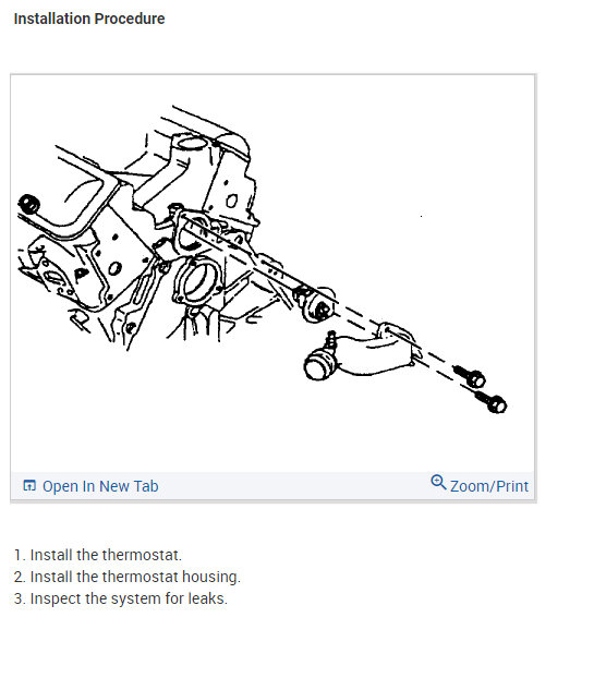

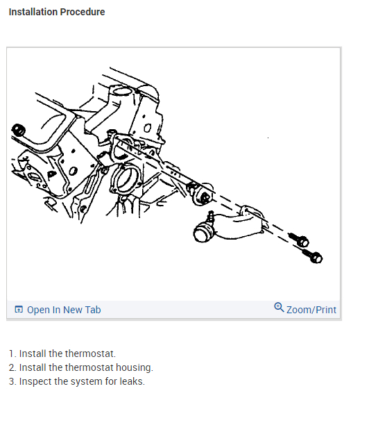

I have attached the thermostat replacement procedure for your vehicle.
