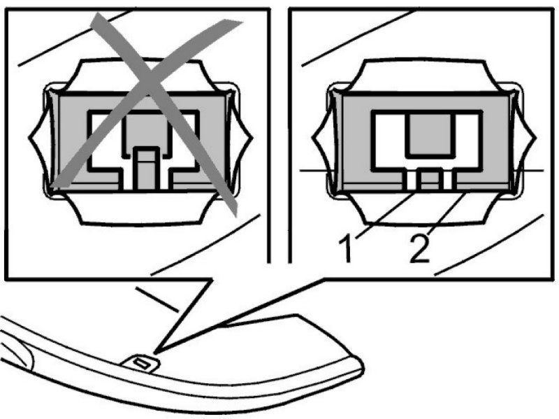

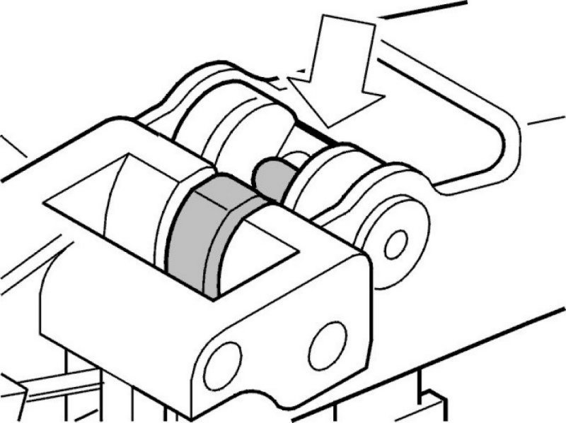

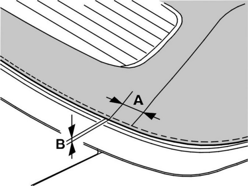

Top will not close all the way.
Apr 19, 2020 at 7:23 PM
  • 110,240 POSTS
Chances are a component called a potentiometer is bad. This device is what is responsible for determine distance and force. If it is bad, this is one thing that can happen.
However, if you want to try it, they can be reprogrammed, but it requires a scan too which can communicate with specific modules. Here is the relearn / re-calibrate directions. You will note that a scan tool is being used. The attached pics correlate with the directions.

- Lower the convertible top fully
- Save this position by pressing [YES] , press [NO] to move to the next or press [EXIT] to end the calibration.
pic 1
- Open the convertible top completely
- Close the front lock for the mechanical stop

- Adjust the rear latches so that they are exactly under the convertible cover.
pic 2
Adjusting the engagement position
- In the engagement position, the front edge of the lock catch and the edge of the tensioner rib lock side piece must be parallel
- Lower the tensioner rib
- Tension the convertible top by operating the rear latches.
pic 3
- Measure the distance between the fabric and the plastic strip at the lower edge of the rear of the convertible top
- The measurement points are 80 mm inside the longitudinal seam on both sides (A)
- To achieve a seal, there must be a gap of approximately 4 mm between the fabric and the plastic strip (B)
