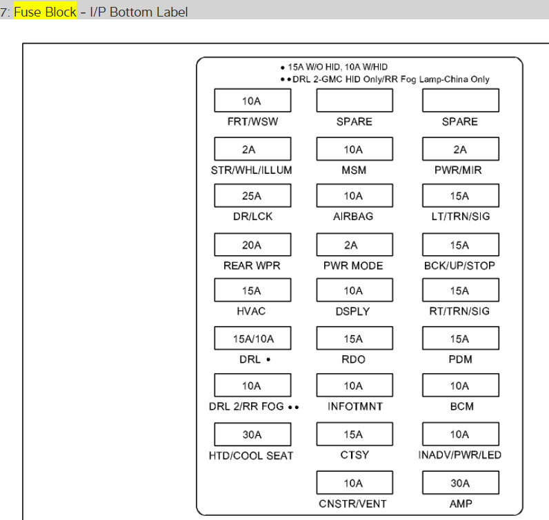

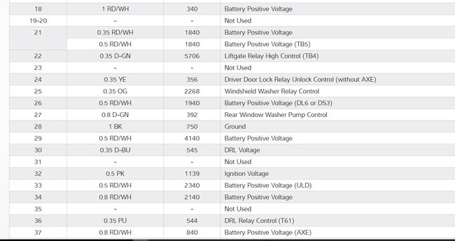

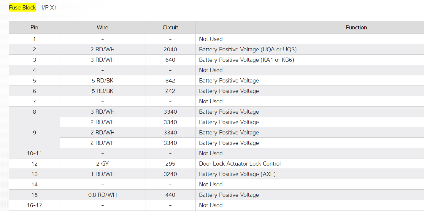

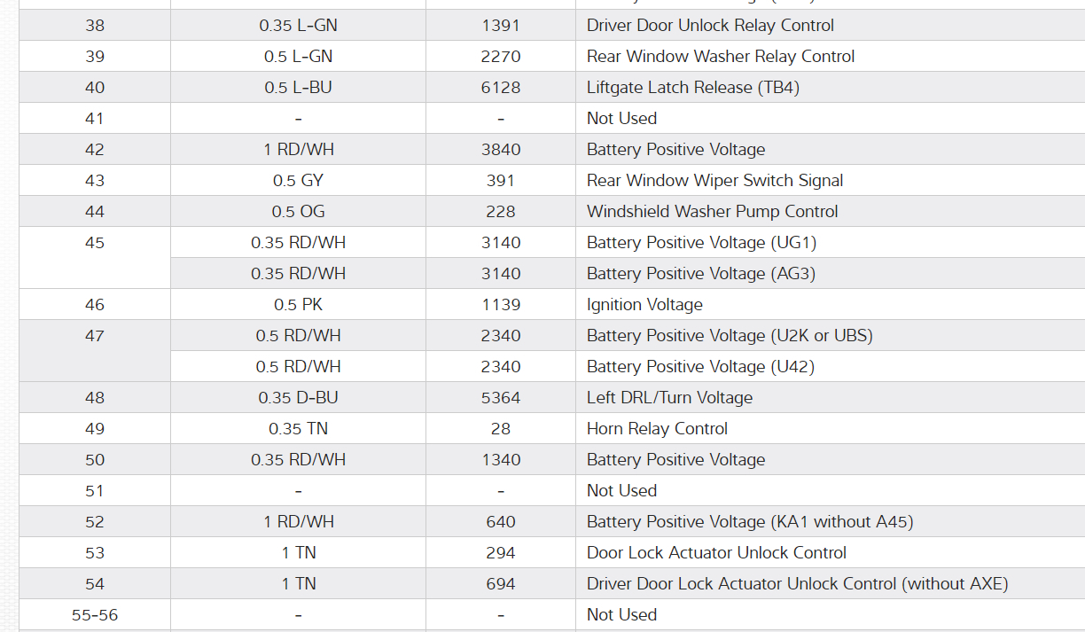

Starts and then turns off, giving the code U0073.
Mar 17, 2018 at 11:18 AM
  • 55,748 POSTS

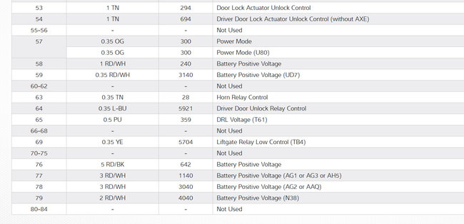

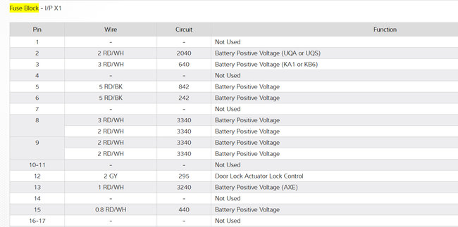

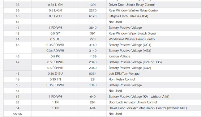

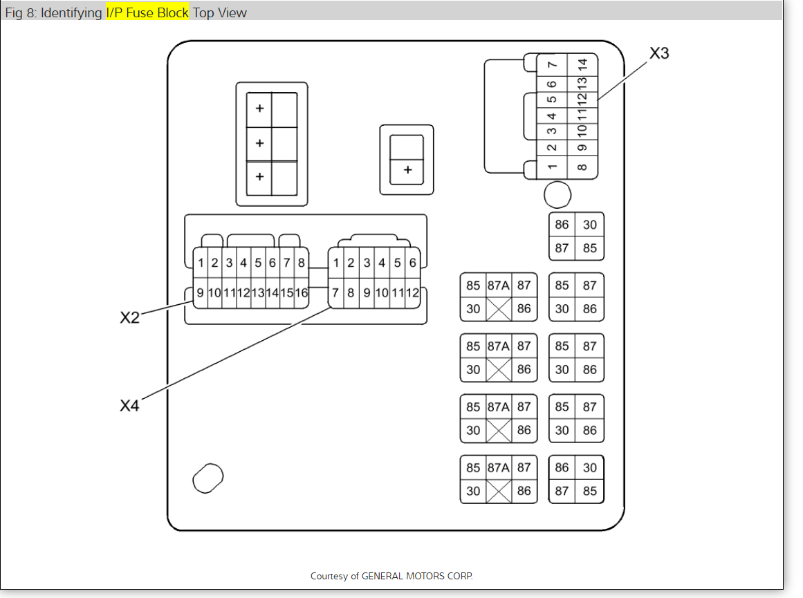

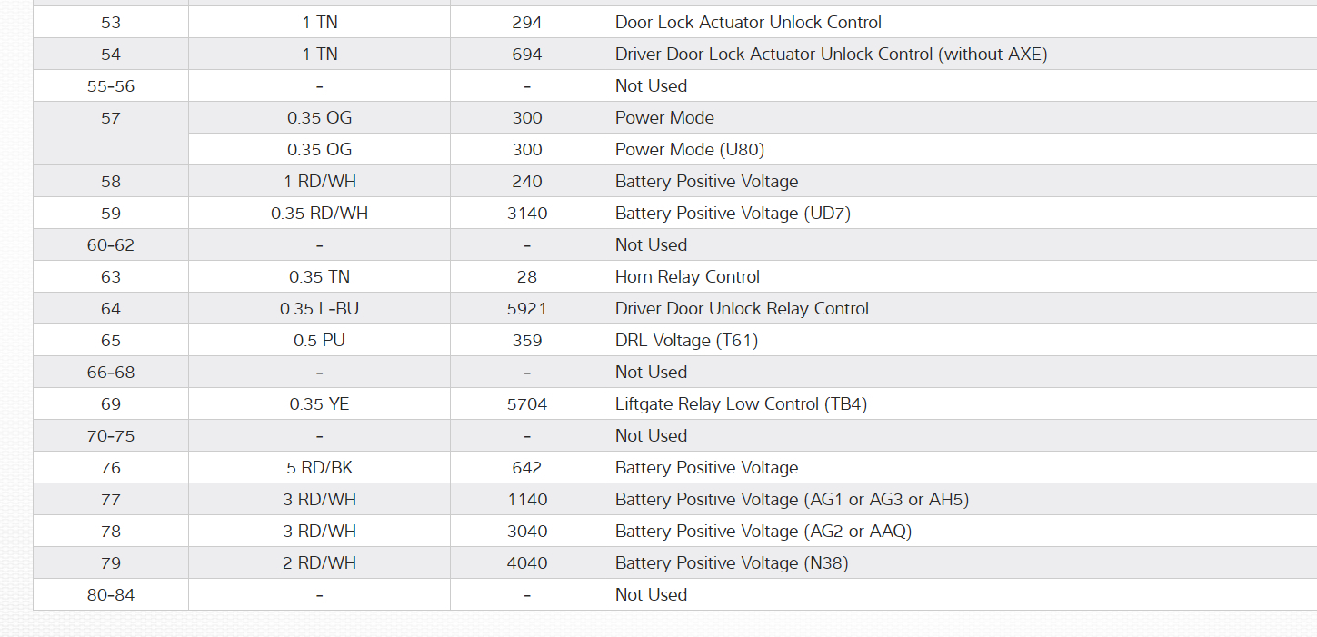

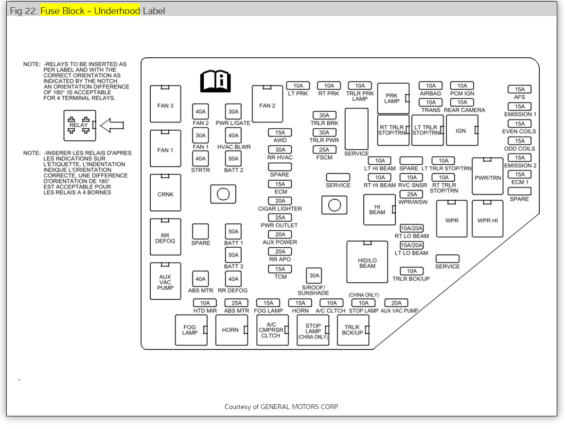

This codes mean bus A is not working which is the communication between computers is not working. This could be because a fuse let go or the PCM or BCM is out and needs to be replaced. Lets start by checking the fuses.
Here is a guide to help us get started:
