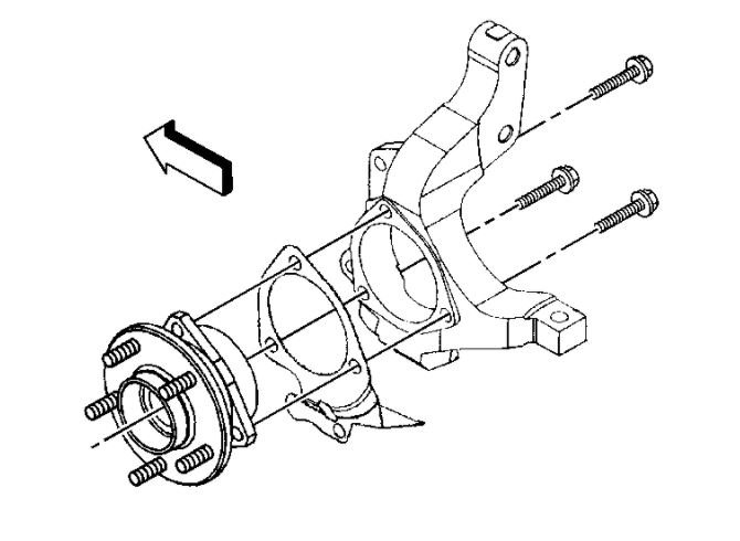

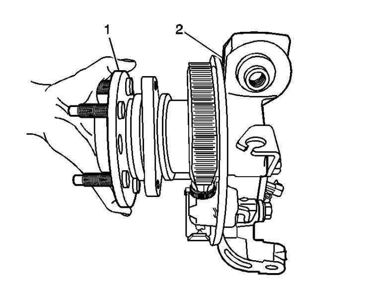

Feels like i'm sitting on it so front somewhere. sound increases upon acceleration and decreases when slowing down. Sound is constant at constant speed. Already changed 3 of four bearing hubs. could it be anything else besides bearings? all fluids full. not overheating. seems like a drag when driving. any help?
Oct 14, 2020 at 4:11 AM
Good afternoon,
Which bearings did you replace?
In most cases, it is a hub bearing. The fronts and rears are very common for failing. The brake dust gets into the bearings causing these issues.

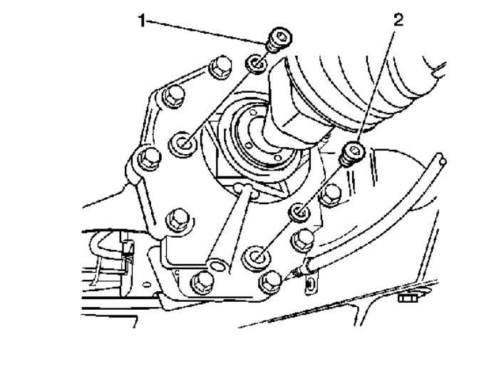

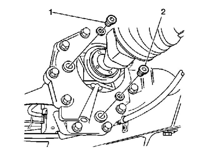

The other area that makes noise is the rear differential. If you have not changed the oil regularly in the differential, the bearings will fail and make a lot of noise.
https://www.2carpros.com/articles/how-a-differential-works
https://www.2carpros.com/articles/differential-gear-oil-fluid-check
Symptoms - Rear Differential Carrier
Strategy Based Diagnostics
Review the system operations in order to familiarize yourself with the system functions. Refer to Differential Carrier Assembly Disassembled Views and Differential Carrier Assembly Description and Locking Differential Description and Operation in Drive Axle Locking/Limited Slip and Transfer Case Description and Operation. All diagnosis on a vehicle should follow a logical process. Strategy based diagnostics is a uniform approach for repairing all systems. The diagnostic flow may always be used in order to resolve a system condition. The diagnostic flow is the place to start when repairs are necessary.

Lubricant Change
Draining Procedure
1. Raise and support the vehicle. Refer to Vehicle Lifting.
2. Clean any dirt from around the differential drain plug (2).
3. Position a drain pan under drain plug.
4. Remove the drain plug (2) and gasket from the differential and drain the oil.
Filling Procedure
1. Notice: Refer to Fastener Notice in Service Precautions.
Install the drain plug (2) and gasket to the differential.
Tighten the differential drain plug to 32 Nm (23 ft. lbs.).
2. Clean any dirt from around the differential fill plug (1).
3. Remove the fill plug from the differential.
4. Fill the differential with synthetic gear oil GM P/N United States 12378514 Canada P/N 88901045. Refer to Capacities - Approximate Fluid in Maintenance and Lubrication.
5. Inspect the gear oil level to ensure it is even with the bottom of the fill plug hole to no lower than 6 mm (0.25 in) below the opening.
6. Install the fill plug (1) and gasket to the differential.
Tighten the fill plug to 32 Nm (23 ft. lbs.).
7. Lower the vehicle.
8. Important: The vehicle must be driven in tight left and right circles after filling the differential in order to distribute the gear lubricant throughout the differential.
Operate the vehicle in tight right and left circles in order to engage the all-wheel-drive system.
9. Raise and support the vehicle. Refer to Vehicle Lifting.
10. Remove the fill plug from the differential.
11. Inspect the gear oil level to ensure it is even with the bottom of the fill plug hole to no lower than 6 mm (0.25 in) below the opening.
12. Install the fill plug and gasket to the differential.
13. Lower the vehicle.
