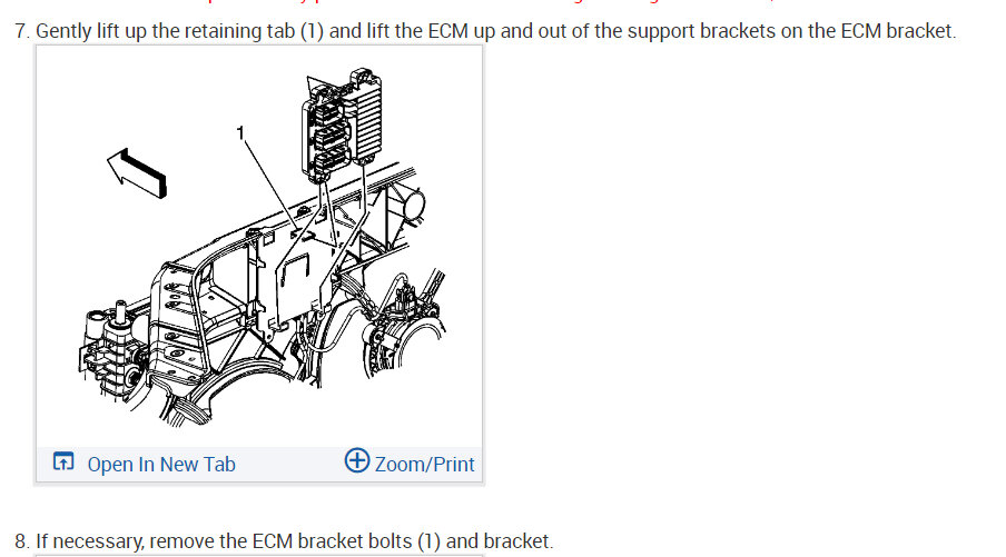

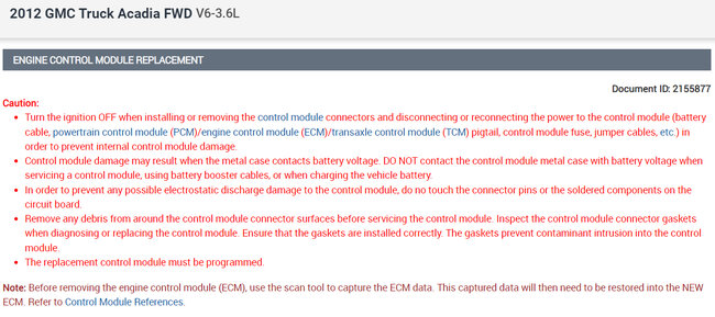

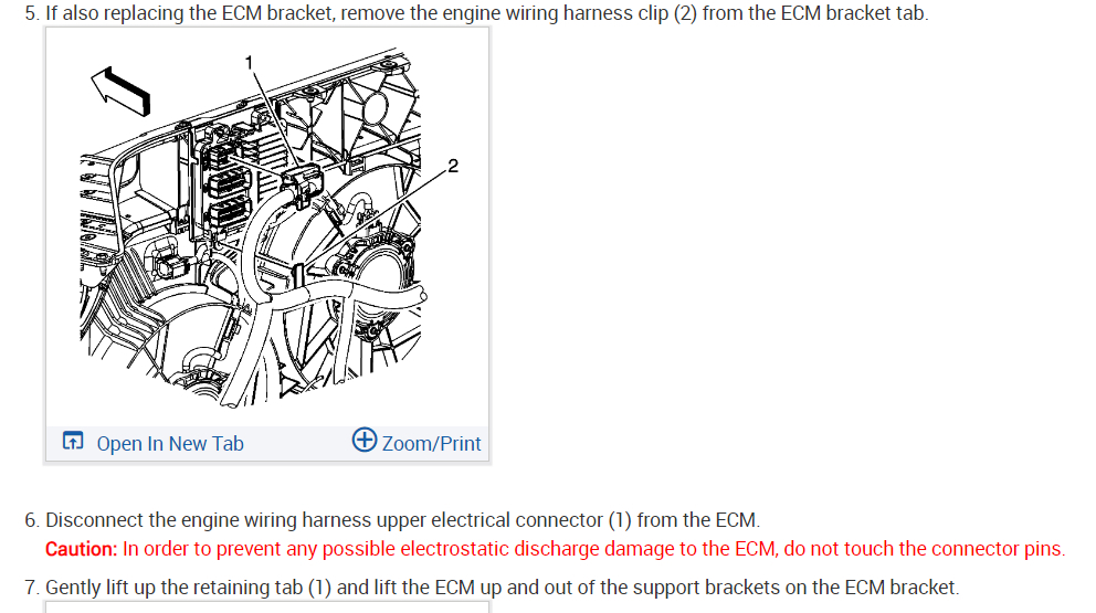

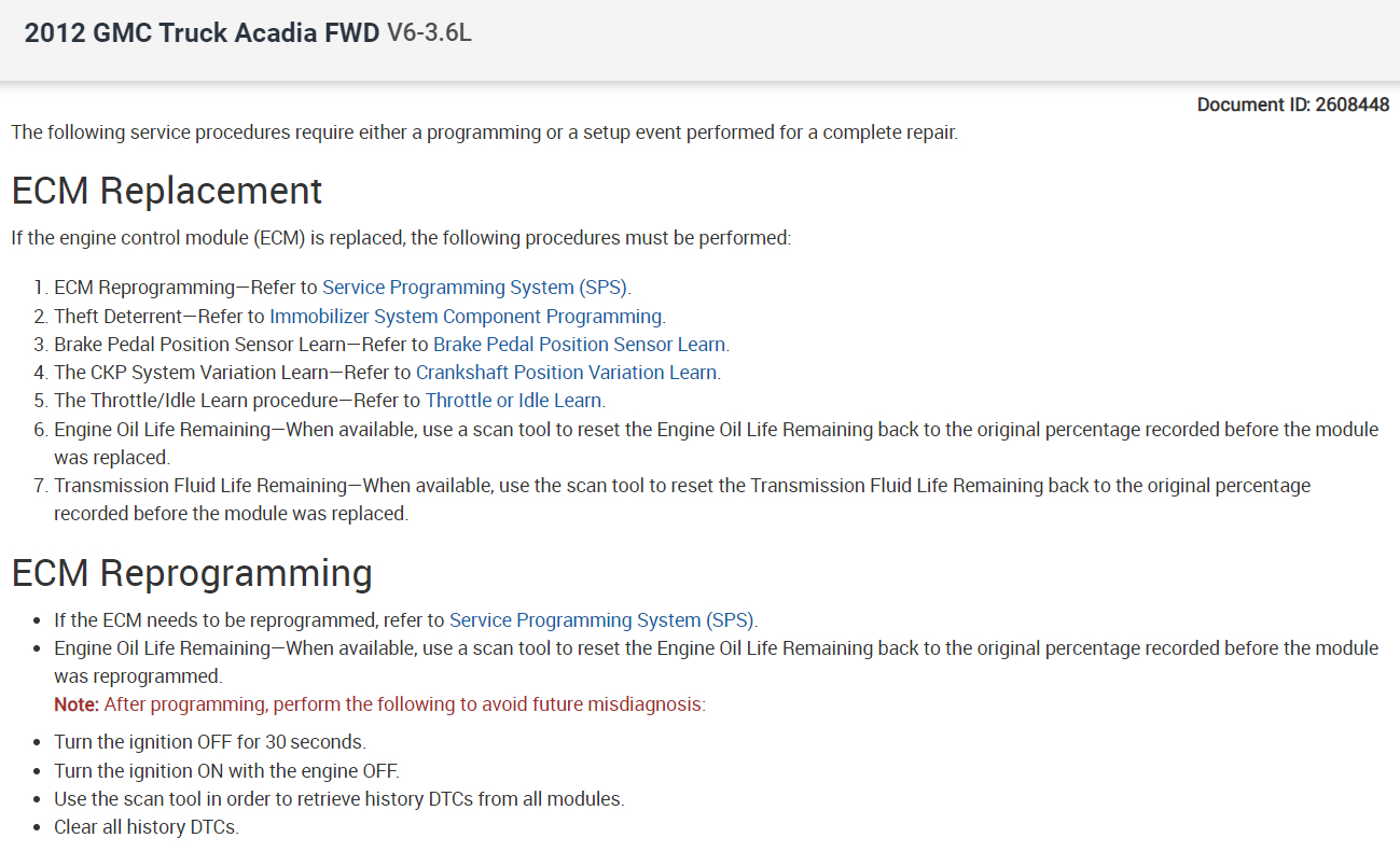

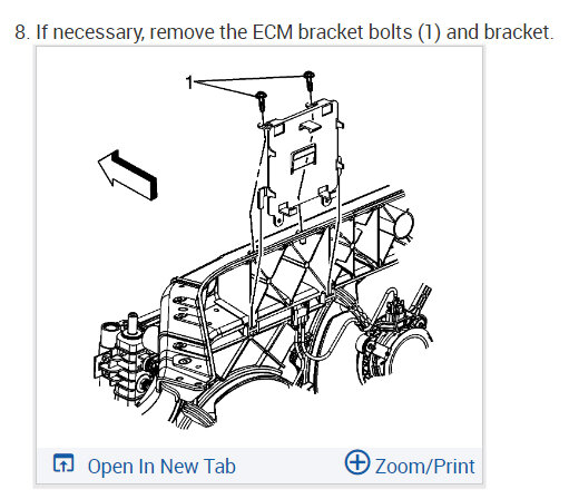

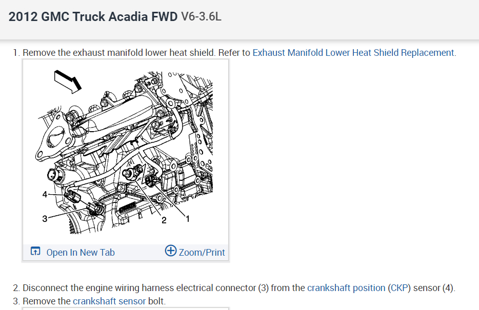

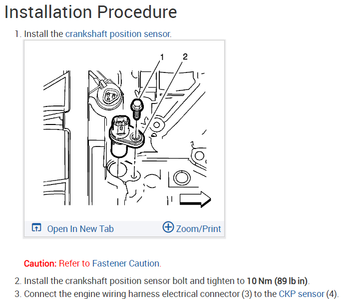

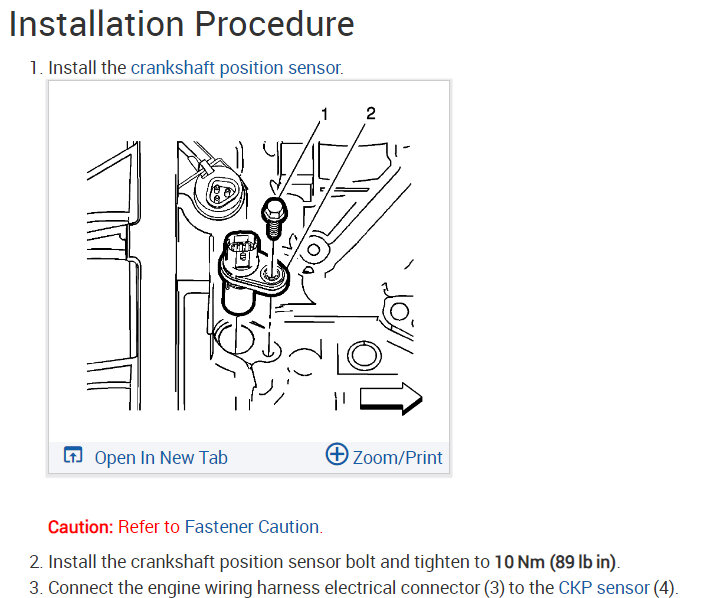

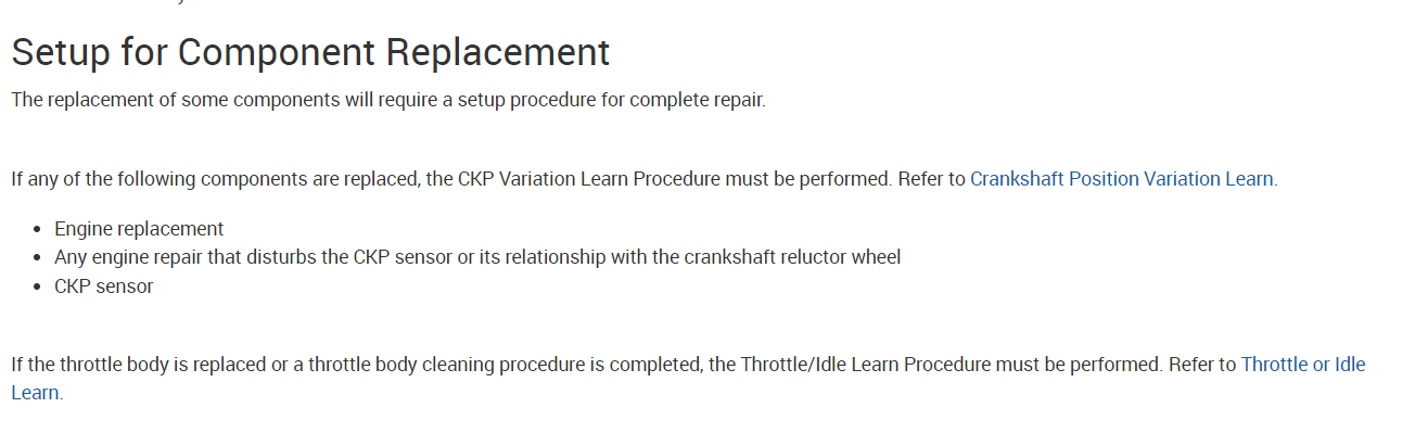

can you please double check the code #, code p062 is missing a digit. Also, there is no crankshaft relearn for this car, here are the instructions and they mention it. Check out the images (below). Let me know the other code please.

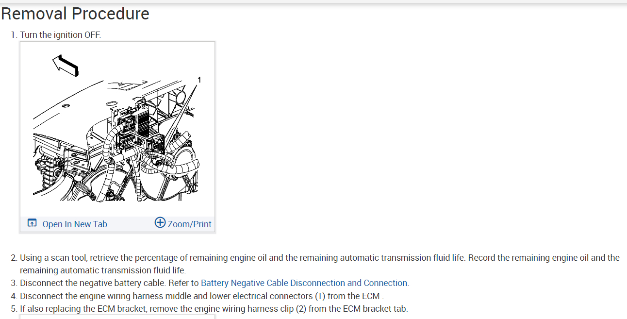

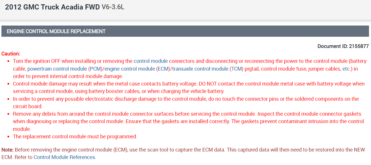

Yep, that is the problem then, the PCM is not programmed correctly. I would try it again. Here is the correct way to replace the PCM in case you need it. Check out the images (below). Please let us know what happens.
