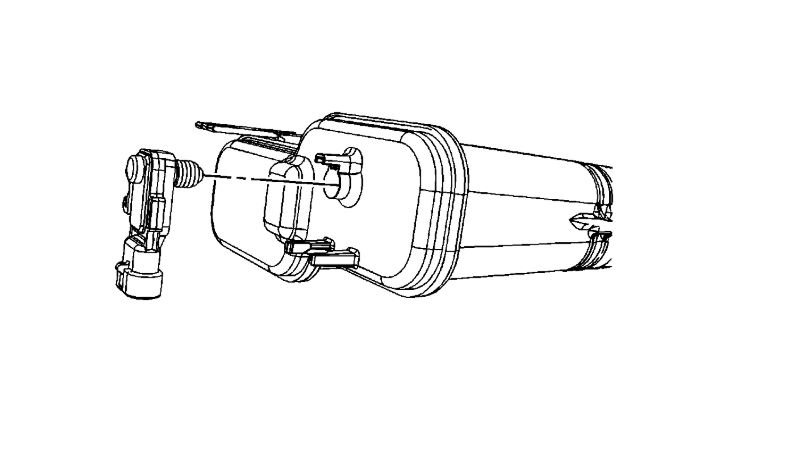

Me again. I have looked everywhere and nothing. Could you possibly send me a picture of exactly where the EVAP fuel tank pressure sensor is located on the 2005 Cadillac STS 4.6L Northstar engine?
Nov 2, 2018 at 8:22 AM
It is located in the vapor canister under the car in the rear.
Picture attached.
