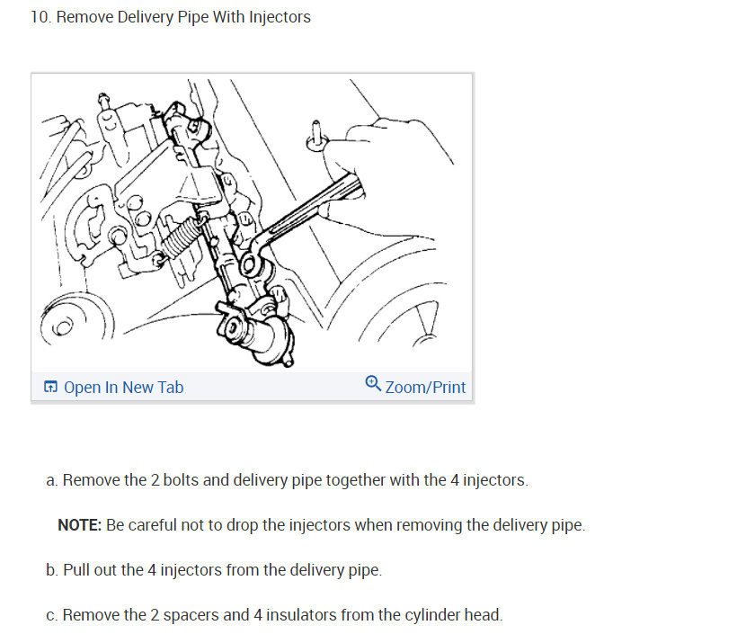

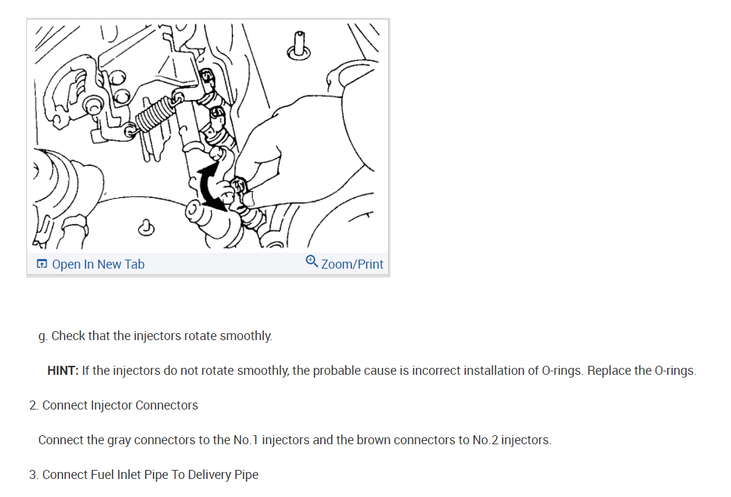

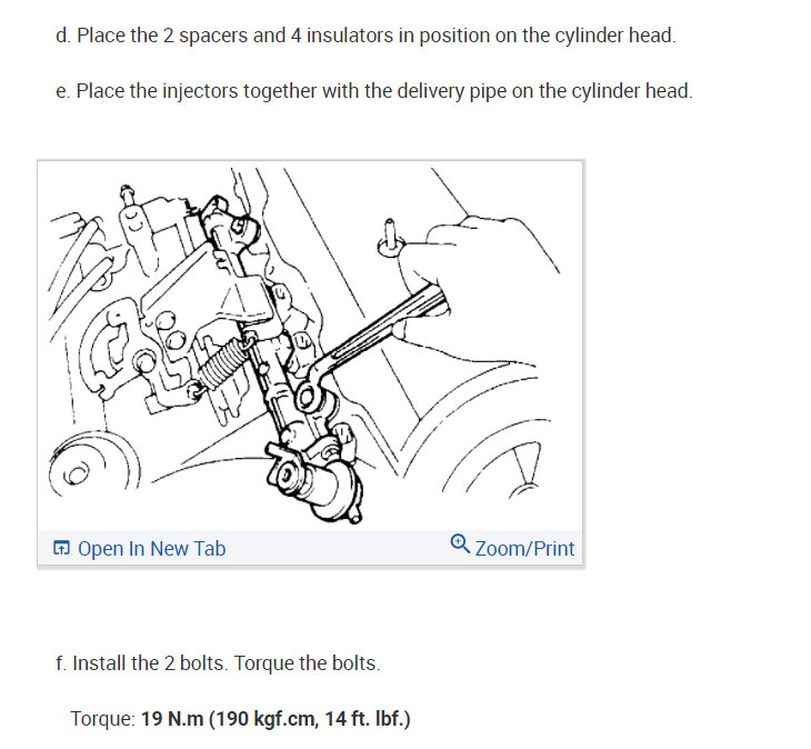

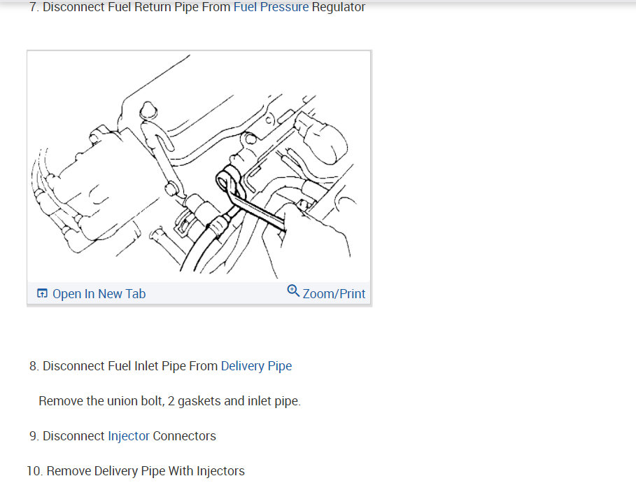

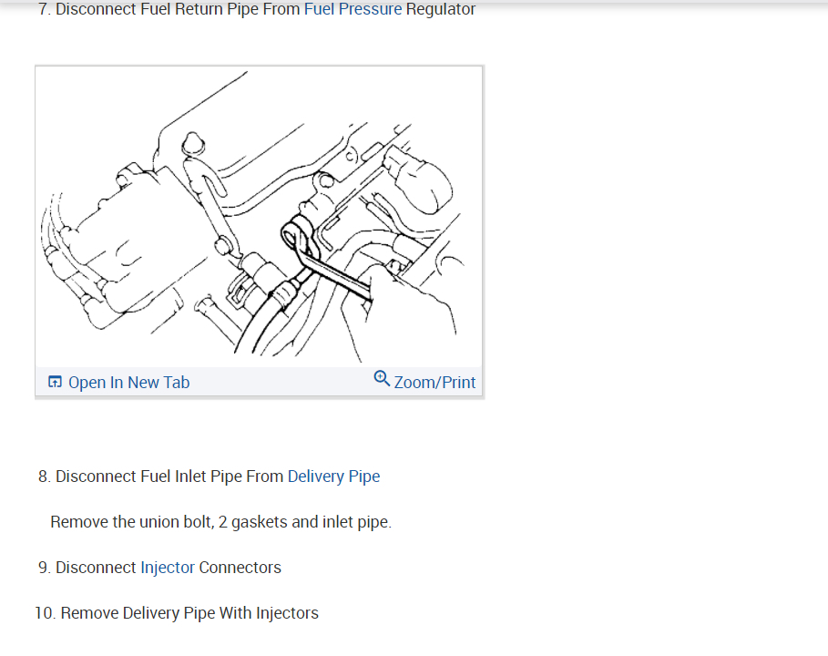

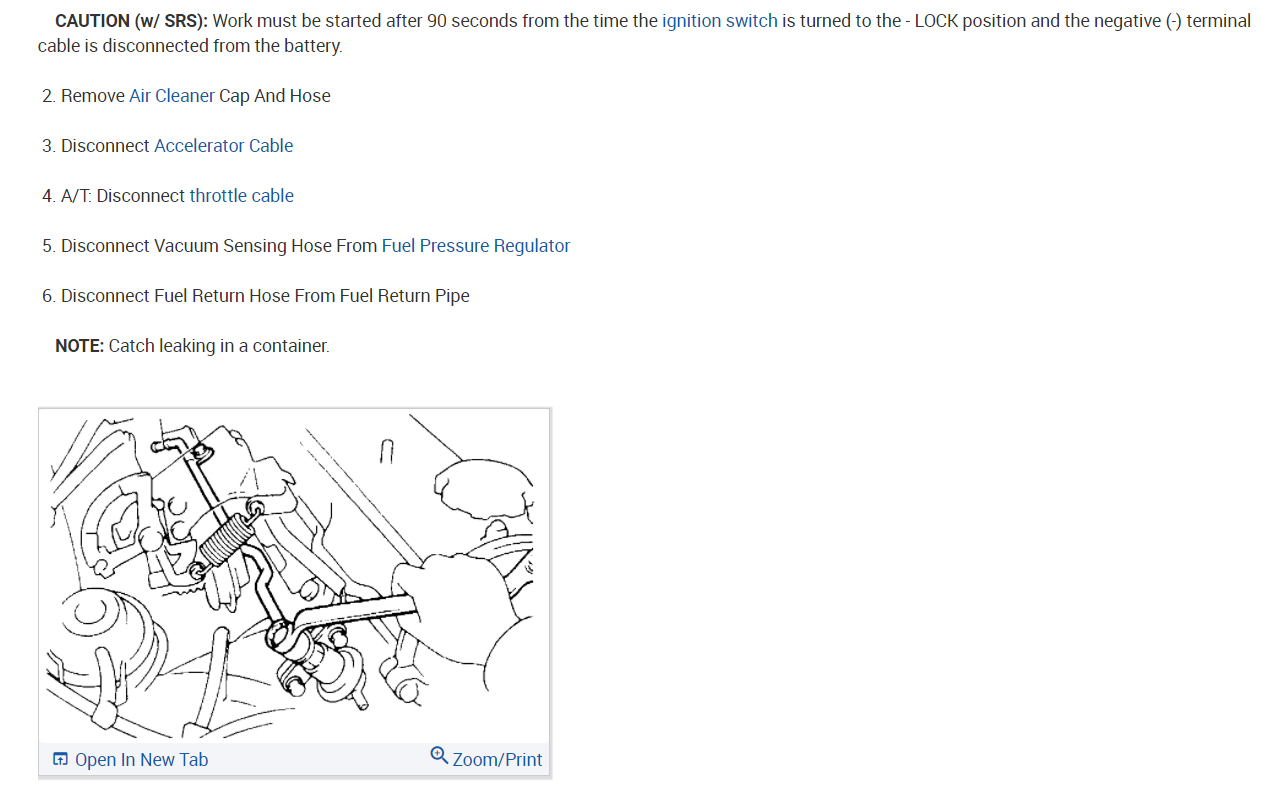

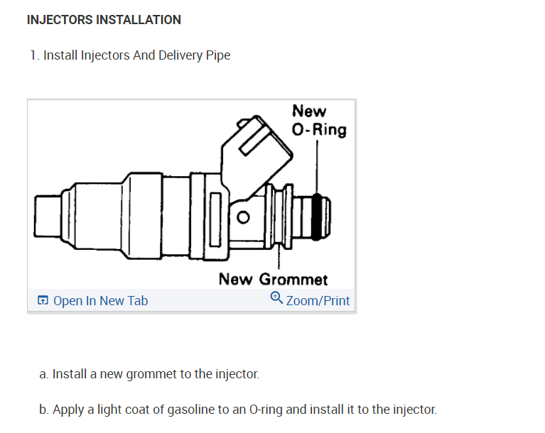

I would have the injectors checked. You may have dirty or bad fuel injectors causing the misfire issue.
https://www.2carpros.com/articles/how-to-test-a-fuel-injector

That is a larger difference and it indicates either a valve issue or a piston ring issue. Either way, it is a major repair.
You could add a small amount of oil to that cylinder, a cap full, and retest the compression. If it raises, it is the rings. If it does not change, it is valve-related.
