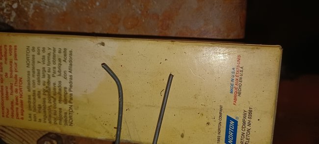

Also, I'm not sure if this may have damaged anything but when i was turning the crank manually watching distributor and had a dowel in first piston watching it as it goes down and then up at compression stroke and putting it to TDC dowel got stuck. I rotated the crank backwards a tad and was able to get it out but there was a bent in it about an inch from the top. (See picture below) I'm hoping no problems or rings impacted. What should i look at doing before I start up? And cylinder compression test.
Pic is of dowel next to another one after i got it out.

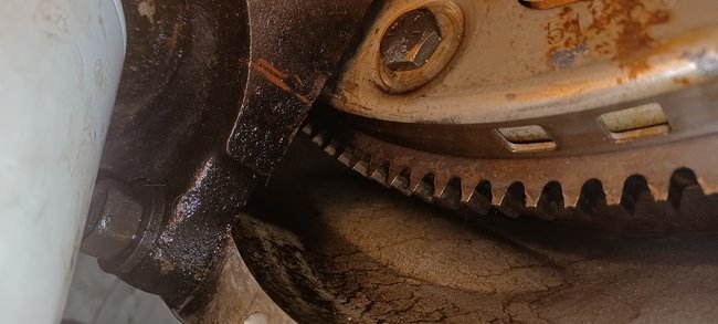

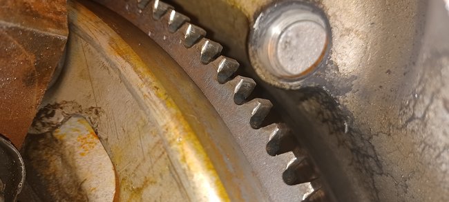

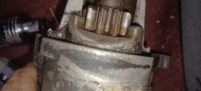

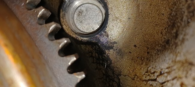

I pulled the starter and cover plate to see the teeth in flywheel. Even turned engine by crank to see entire wheel and didn't see any teeth out. here is the pics.
No, it wasn't in run mode at all. Once an odd noise hit i shut it off to look at the flywheel.
When pinion engages it can't bind can it? since both turned?
Apr 25, 2022 at 9:14 AM
HIDDEN1
  • 107 POSTS
Update: After the pics it started up fast and smooth this time. I turned it off after a few seconds for the time ..
I had taken off that aluminum guard piece covering the flywheel. and temporarily put starter back in and tight.
Turned flywheel /at crank back to TDC. - it started better than yesterday's second attempt. And far better than the old starter with vroom noise, the engine didn't engage.
Maybe that bell housing ,aluminum cover plate is working like a shim to the starter? an after i repositioned things, it started better with it off..
I'm glad i did examine the flywheel after the many different noises..
Does it look okay?
I will be testing the truck, looking for any leaks an letting it run tomorrow as it is.
Can get video. ..

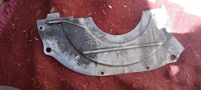

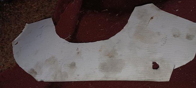

This was causing all that recent noise. I even cut side off at the starter, still did it. I took it back off, quiet again.
I guess I'll have to get one off another Dakota. .I don't really want any debris to get up in there ..
Apr 26, 2022 at 5:15 AM
STEVE W.
  • 15,320 POSTS

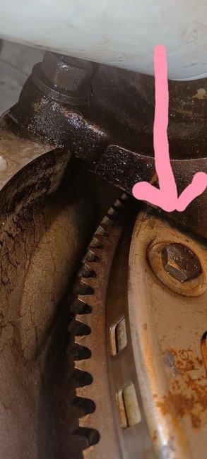

Likely it was rubbing on the flex plate.
Apr 26, 2022 at 10:50 AM
HIDDEN1
  • 107 POSTS
Yes,it looks very close to those bolts .
If the next one does the same thing what should i try ? Spacers a nut or flat washers at the tranny support bolts an 2 tiny ones,to move it back?

No go on another piece. It scrapped too.. looks like inside at top of the curve . ..i noticed theres a bigger gap between oil pan an the bell housing on the other dakota ..
Maybe thats a factor..
I had to cut a piece of aluminum off a roll of coil an fabricated one as best i could...but not sure it can prevent all rock or debris from getting in..
I tried to even cut that middle out at curve but still rubbing..
For now that is better than nothing
Any ideas?
I will likely reform another one later .unless you have a solution.
2nd pic piece is replacement even after middle was cut out -scrape.
Apr 27, 2022 at 8:16 AM
STEVE W.
  • 15,320 POSTS
The cover should go between the transmission and the block, the thin plate provides the correct clearance for the other parts.

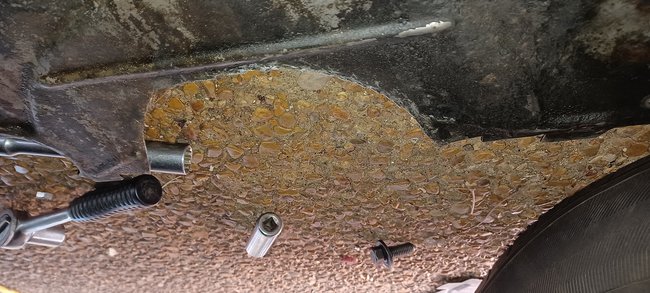

No but the engine and transmission at bell house an overdrive had to be lifted or jacked up so as to drop oil pan low enough to get inside it. There's a cross member under oil pan and it's tight. Motor is back on the motor mounts an overdrive back on its supports all tightened back..
Apr 27, 2022 at 8:55 AM
HIDDEN1
  • 107 POSTS
Engine had to be jacked up in order to get to oil pan, an overdrive supports were undone so as to be able to lift that an bell housing as getting to inside of oil pan truck brace goes directly under pan and it's difficult to get into [ a piece of gasket was in the bottom. all reassembled.
Apr 27, 2022 at 9:01 AM
STEVE W.
  • 15,320 POSTS
That shouldn't have changed anything regarding the cover then. Maybe lay a straight edge across the bellhousing to see what part is rubbing, then use a hammer to bend the cover to clear it. Or check if the offending part is correct.
Apr 27, 2022 at 10:52 AM
HIDDEN1
  • 107 POSTS
What exactly do you mean on laying a straight edge..across bell housing?
That flat piece of aluminum
coil i cut isnt rubbing but its not tucked in at top ..
I even tried using fender washers under the piece an still heard it..
I think later ill fabricate or trace a piece of that aluminum coil an seal at top w rtv .
