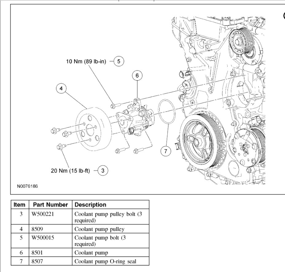

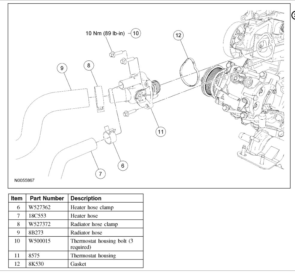

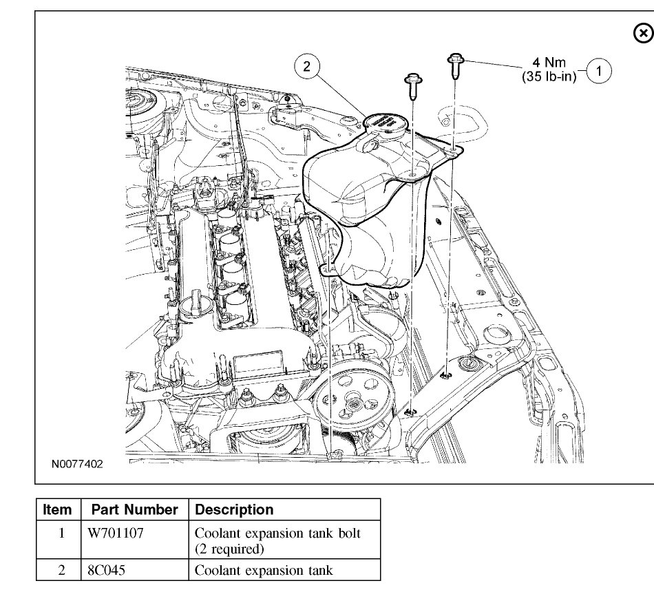

It just increases temperature in the first fifteen minutes when I started it, but the coolant looks full in its container.
Jun 17, 2018 at 3:34 AM
  • 55,433 POSTS

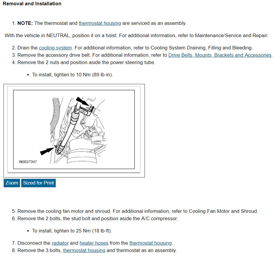

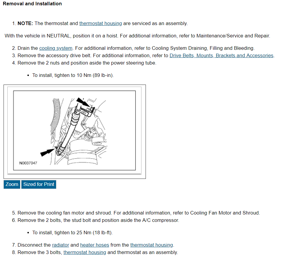

This sounds like you have a stuck thermostat. Here is a guide to help you see what you are in for when doing the job and diagrams below to help you see what it will be like for your car:
Jun 18, 2018 at 5:34 AM
SANELE
  • 19 POSTS
Hi Ken, I bought an new thermostat but it still heats up like water not circulating enough.

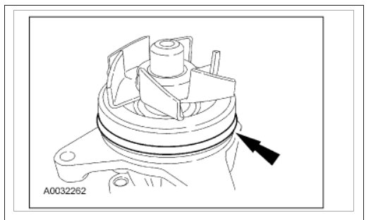

  • 55,433 POSTS

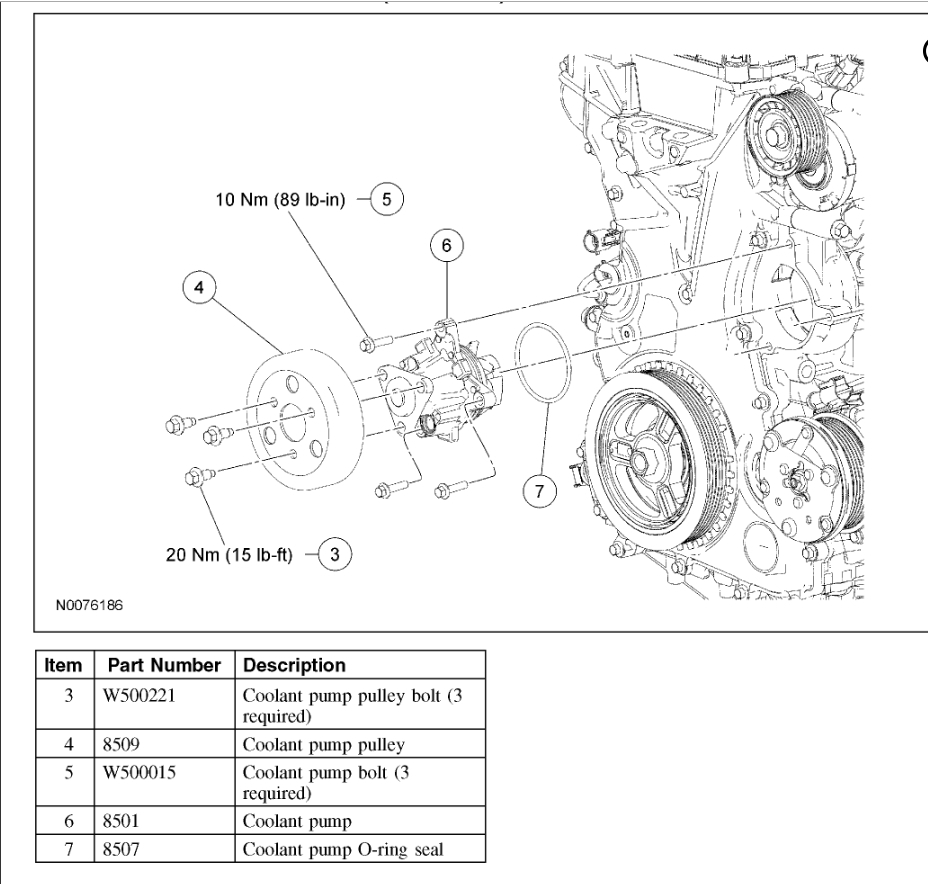

Yes, I have seen where the water pump impeller falls of the pump so no coolant can circulate. I would remove the thermostat and refill with water then start the engine you should see water flowing. To be absolutely sure I would remove the upper radiator hose and start it water should rush out if not the water pump is no good and need to be replaced. Here is a guide to help you see what you are in for when doing the job:
https://www.2carpros.com/articles/water-pump-replacement
and what it will be like for your car (below)
Jun 25, 2018 at 4:43 AM
