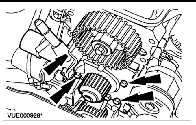

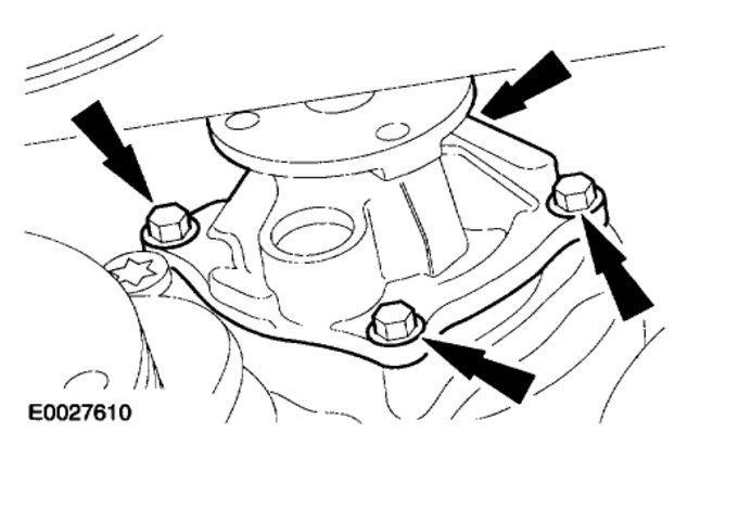

This car is the hatchback 1.4 Zetec. how can I tell if my water pump is run off belt or the fan? could you help please?
Feb 20, 2017 at 11:31 PM
  • 55,721 POSTS
Hey LIVKOP78,
If the engine is signal overhead cam then it is run from the timing belt, if it is dual overhead cam it is run from the serpentine belt. Here are two images to help you see.
Let me know if you need more information, we are happy to help.
Best, Ken

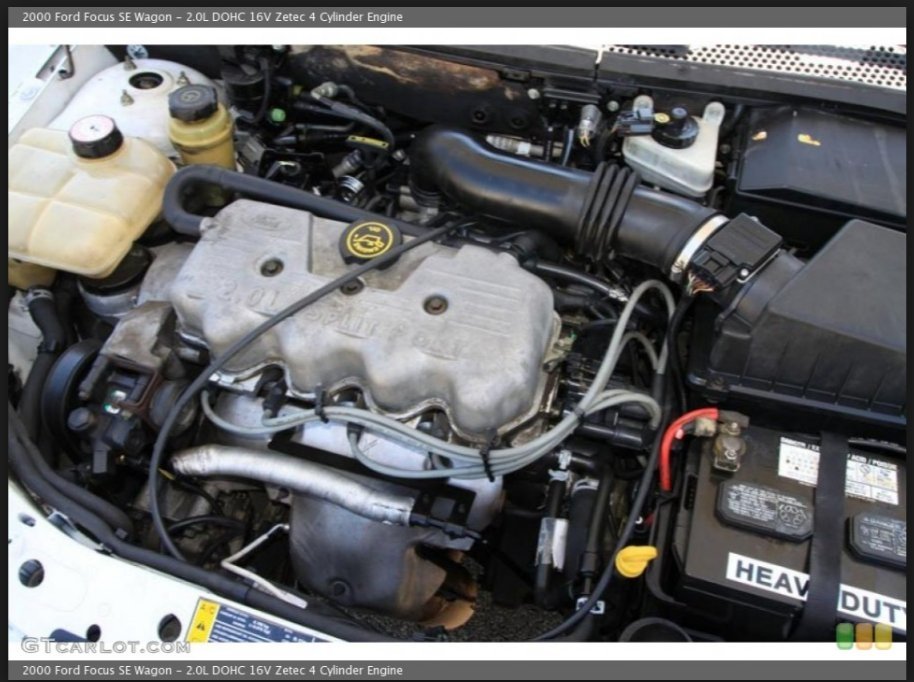

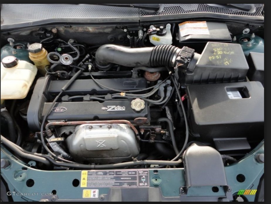

Wats difference between signal over head and a dual how can I tell
Feb 23, 2017 at 7:48 AM
  • 55,721 POSTS
This is dual overhead
Feb 23, 2017 at 8:02 AM
LIVKOP78
Can u send me a picture of signal over head il donate
Feb 23, 2017 at 11:50 AM
  • 55,721 POSTS
You bet, here you go.
