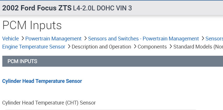

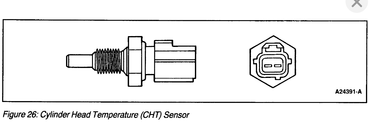

JDL
  • 16,098 POSTS

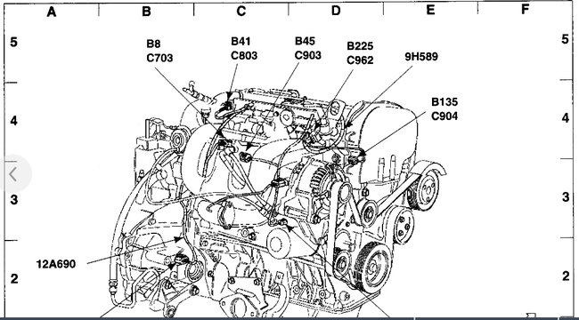

I found this picture. It appears to be on backside of cylinder head, driver side.

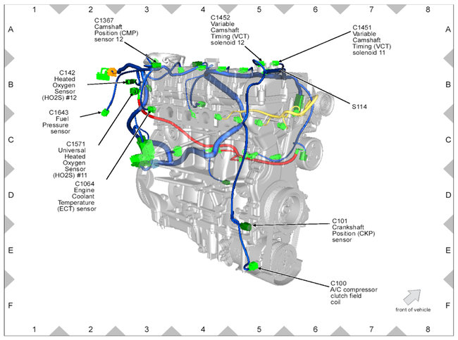

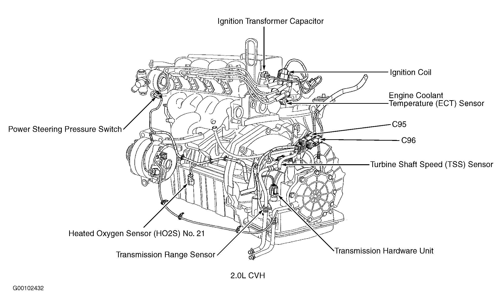

JOHN NOPE
I am trying to find the location of the coolant temperature sensor. A video would be great!
May 26, 2020 at 7:38 AM (Merged)

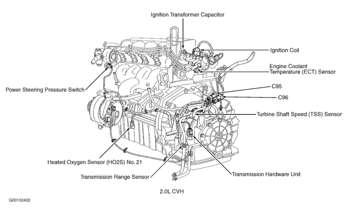

SCGRANTURISMO
  • 4,897 POSTS
I have included the information that you requested in the diagrams down below. The Engine Coolant Temperature sensor (ECT) is located in the center of the rear of the engine, in the thermostat housing.

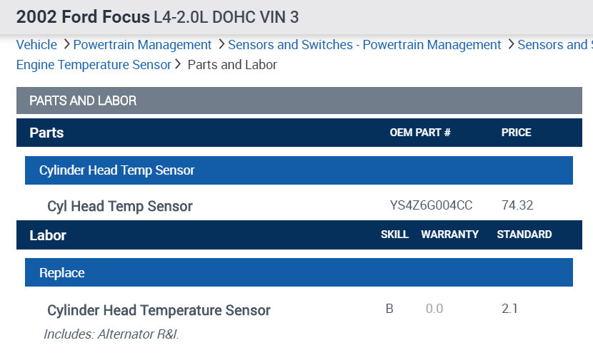

Your vehicle is a 2002 Ford Focus 2.0L Automatic, right? What is the exact model of your vehicle? Is is a Focus wagon, wagon ZTW, ZTS, ZX3, or a ZX5? I have included some general information in the diagrams down below for you. I can look up the correct part number for you as soon as I have the exact model you have.

JOHN NOPE
Did the image of the engine show up?
It's a 4 door se
2.0 split port SOHC (I think)
SCGRANTURISMO
  • 4,897 POSTS
Hello again,

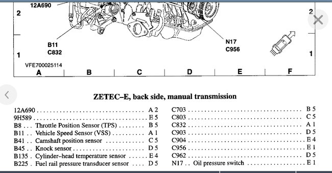

As promised, here is the information that you requested in the diagrams down below. Please if you have any other questions about anything automotive, please, feel free to ask. That is why we are here.

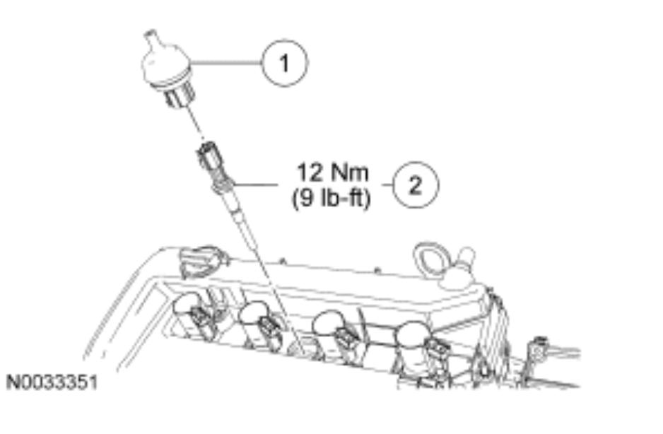

I have a 2005 Ford Focus pzev. I'm trying to replace the cylinder head temperature sensor but I'm having difficulty because it is below the valve cover between spark plug numbers 2 & 3. I can't seem to find a deep wall socket or any ford specific tool to r & r it. the problem is the distance between the 3/4 nut/bolt and the top of the sensor is too great so either the socket is not wide enough to fit around the top of the sensor or bottoms out before getting a bite. needle nose pliers do not work as well because there is not enough room around the sensor. I really don't want to remove the valve cover because I just replaced the valve cover gaskets not more than 3 months ago. is there another way or a tool I need to obtain?
Jun 1, 2020 at 2:35 AM (Merged)
  • 110,240 POSTS
I have to be honest, some of these can be a pain. Have you already purchased a new sensor? Does the socket you are using properly fit over it? If it does, check the old sensor to make sure it takes a standard type socket. I know that some sensors are designed in a way that requires a special socket.

I tried asking a couple dealership service depts to no avail. I wound up removing the valve cover anyway. Lucky for me the gaskets were in excellent condition so I reused them. I went ahead and made it an all day event and to the opportunity to check my bearing caps for play along with camshaft lobe integrity and clearances. I guess it's just gonna have to stay a pain. In all likelyhood, at least I won't have to mess with it again.

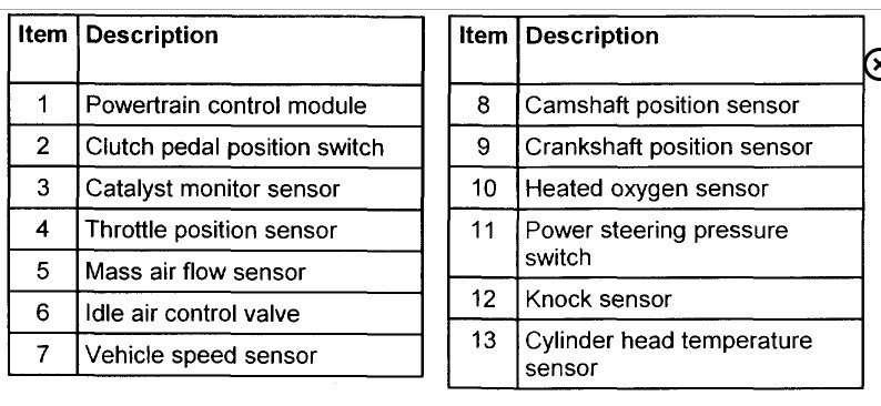

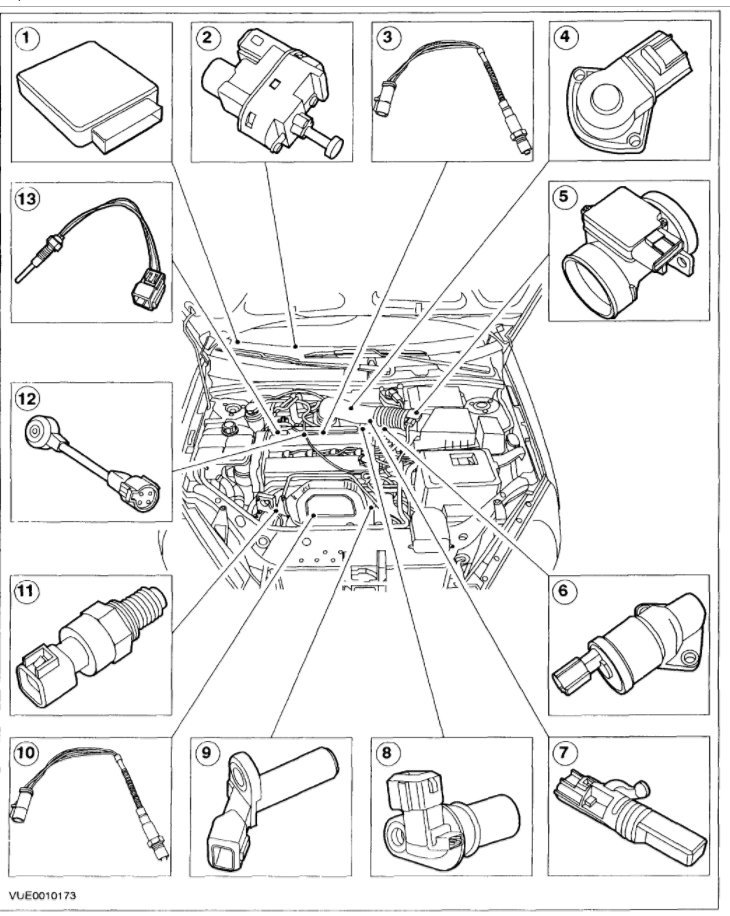

BEV SINGLEY
where is the water temperature sensor located at on the car listed above it is the SE 2.0 z tech?
  • 55,381 POSTS

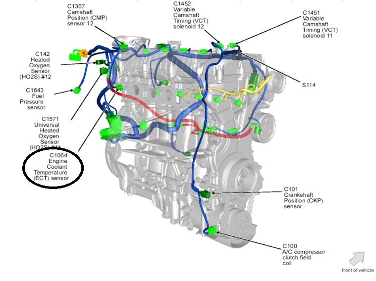

The engine coolant temperature sensor is located in the cylinder head toward the front of the engine. Here is a guide and some diagrams (below) to help you get the job done.

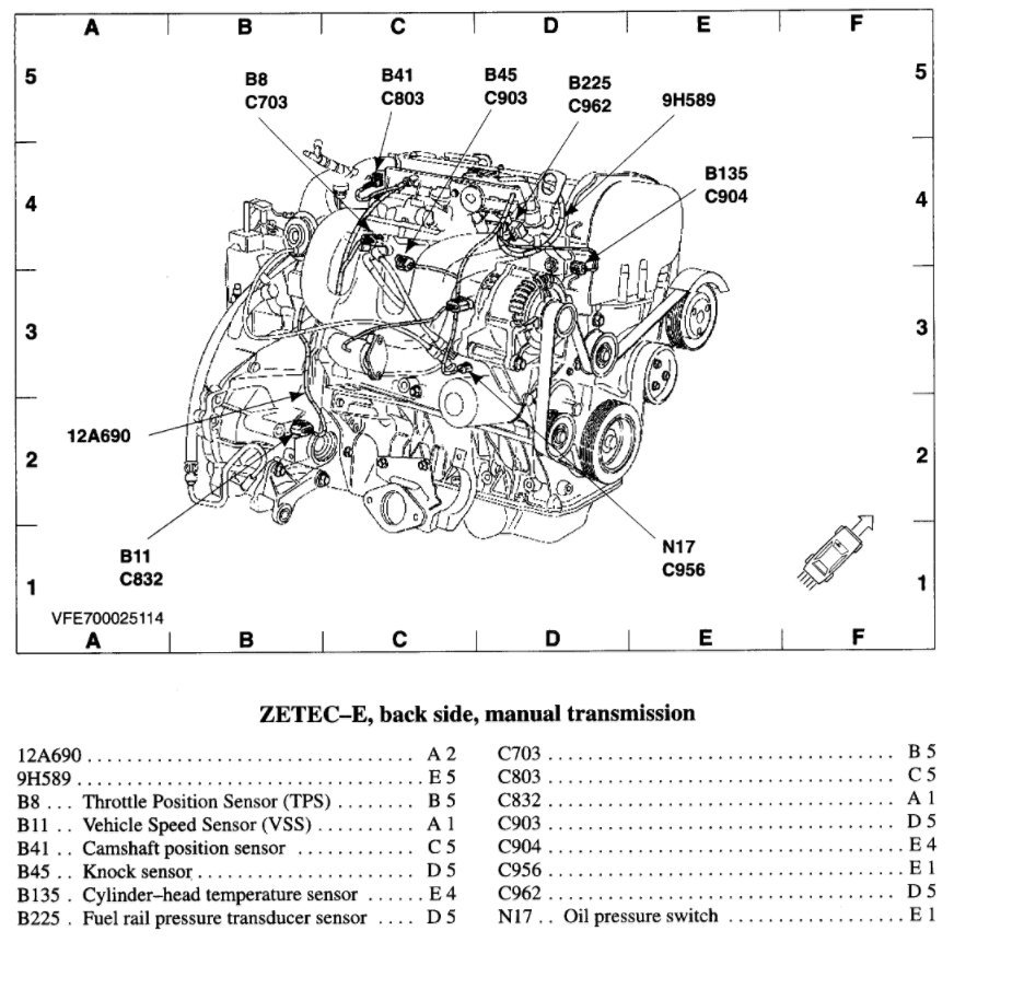

BRENT HAWKINS

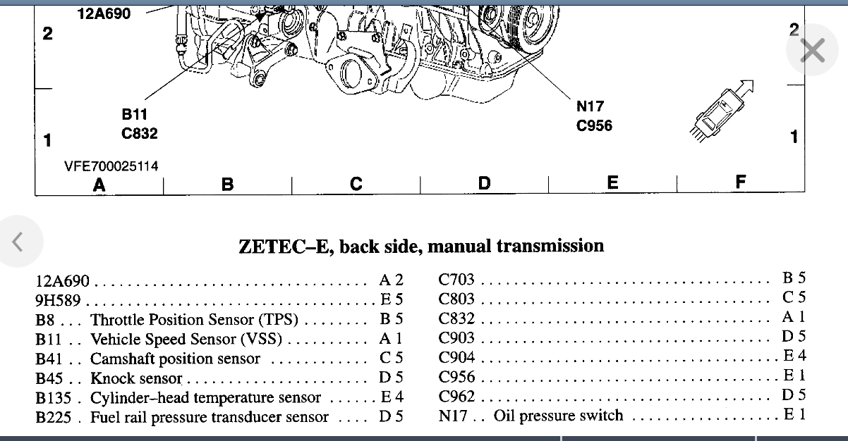

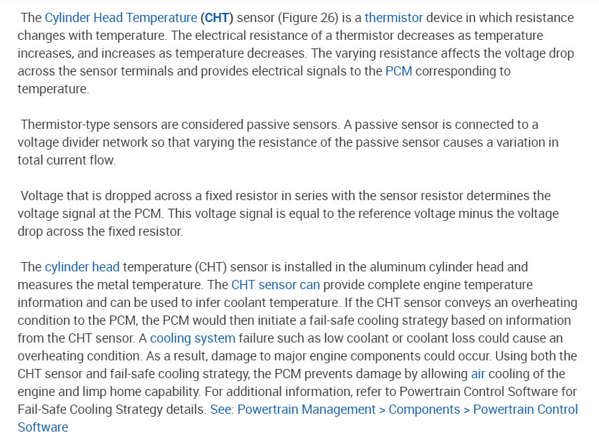

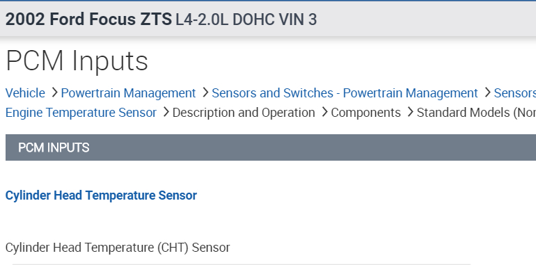

I have a 16V-Zetec ZTS Ford Focus.Car is running rough. Skipping and bucking during acceleration.Weather has turned cooler and car is beginning to idle rough also. Check engine light is on. code P0125. Coolant Temp Sensor. Cant find the sensor to replace.
KHLOW2008
  • 41,814 POSTS
DTC P0125 : Check Engine Coolant Level
This DTC indicates ECT sensor has not reached the required temperature level to enter closed loop operating conditions within a specified amount of time after starting engine. Possible causes for this fault are:
Insufficient Engine Warm-Up Time
Thermostat Leaking Or Stuck Open
Malfunctioning CHT Or ECT Sensor
Low Coolant Level
Check and repair cooling system as necessary.
A Cylinder Head Temperature sensor is used instead of an ECT.

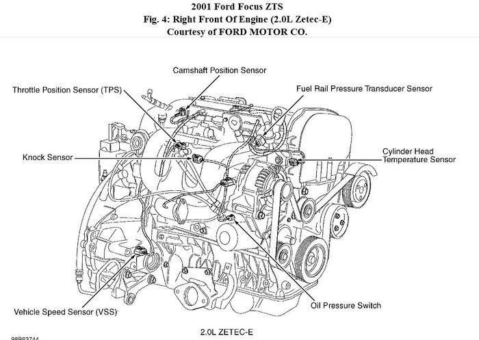

VLADIMIR3233
I have a ford focus from the year 2001 and have noticed that the coolant temperature sensor is not working anymore, but as much as I look I cant find where it is located and if I find it, I need to know step by step how to change it, please help
Jun 1, 2020 at 2:39 AM (Merged)
IMPALASS
  • 3,112 POSTS
Hello - I need to know the exact model and size of your engine in liter. What I have given you is for a Ford Focus LX 2.0L. There are no procedures for this. Disconnect the electrical plug and using a wrench unscrew. Install new one.
