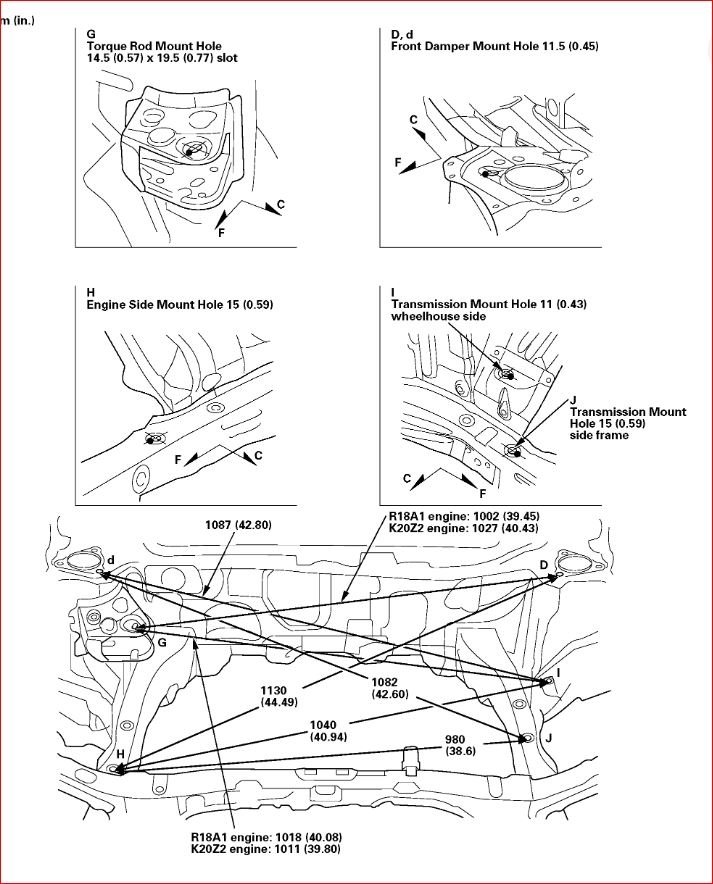

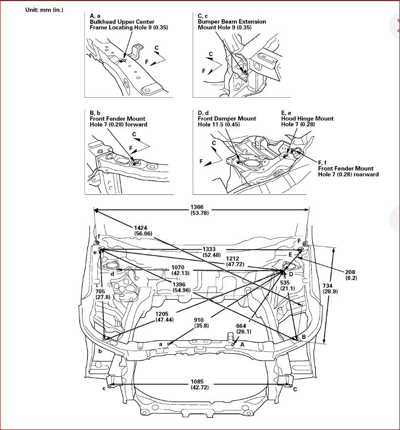

Replacing radiator support with CAPA Certified one. need under hood Tram Gauge points/dimensions.
May 10, 2019 at 4:58 AM
Hi Charles,
Is this what you are looking for? Let me know if you need more information. Thanks
May 10, 2019 at 1:14 PM
CHARLES PREUETT
Yes exactly. Now my search will be for an affordable Tram Gauge (a one time use for a DIY'r). Any suggestions?
