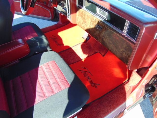

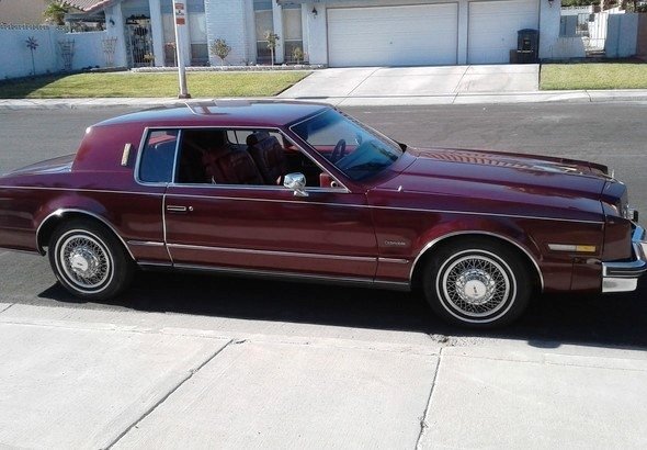

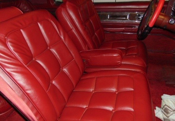

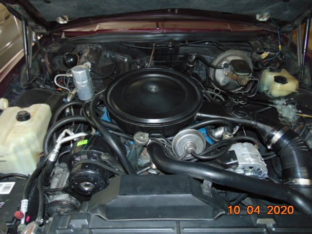

Here is a picture of my completely restored 1979 Oldsmobile Toronado.

Very nice car, from a time when you could recognize the make year and model on sight, not like the melted soap vehicles today where they have no spirit or style. It's a shame it isn't a few years older when the OE engine was the 455, but those were also huge land yachts.
