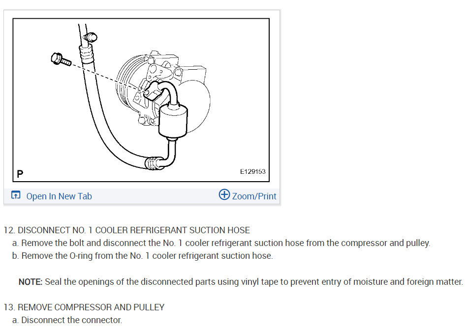

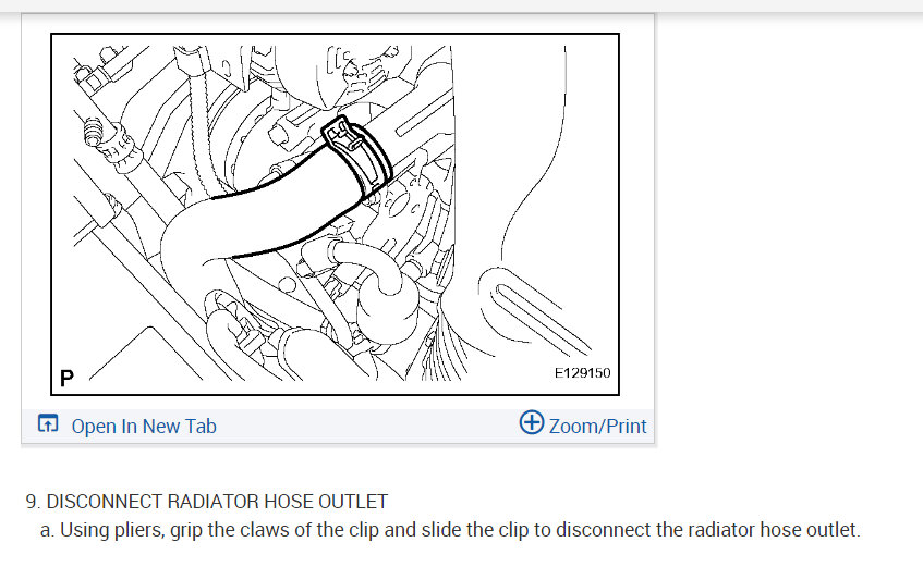

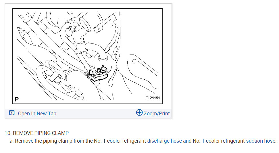

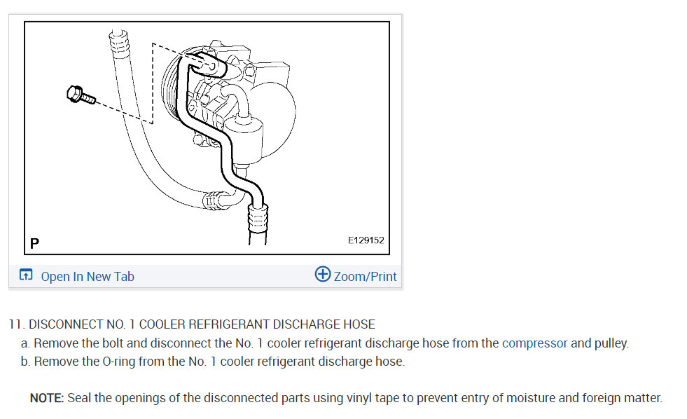

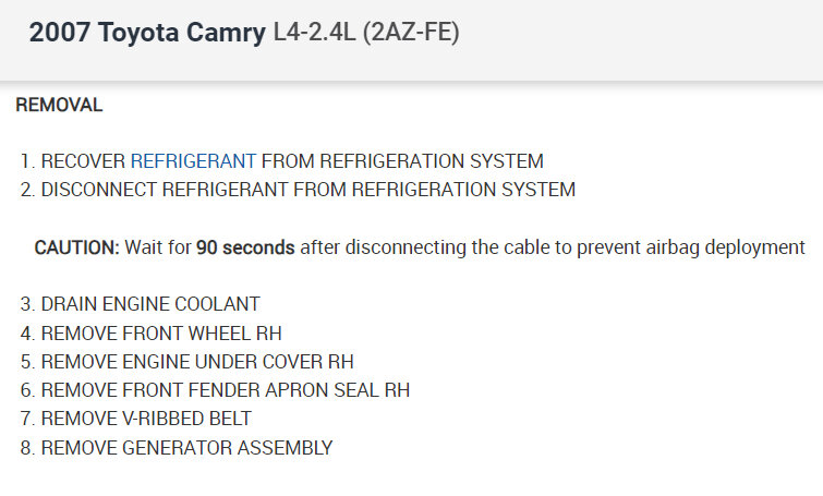

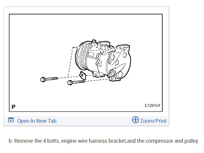

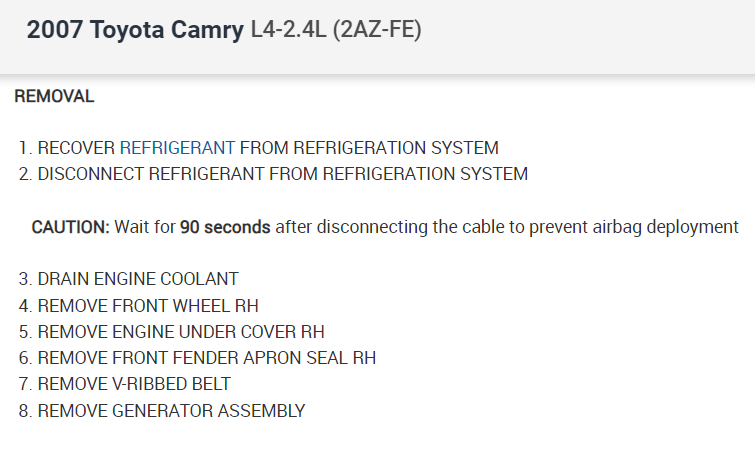

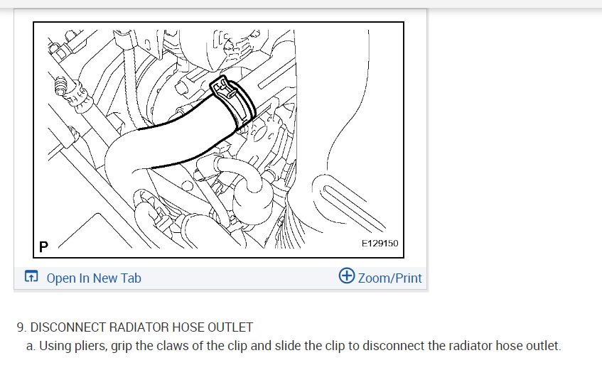

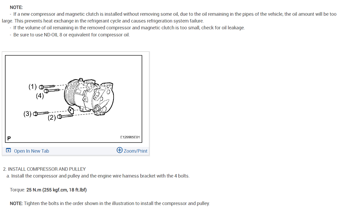

If the high side is low at idle chances are the compressor is going out. Here is how to change the compressor out in case you need it. Also, this guide can help walk you through the steps:
https://www.2carpros.com/articles/replace-air-conditioner-compressor
