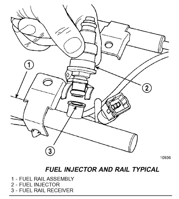

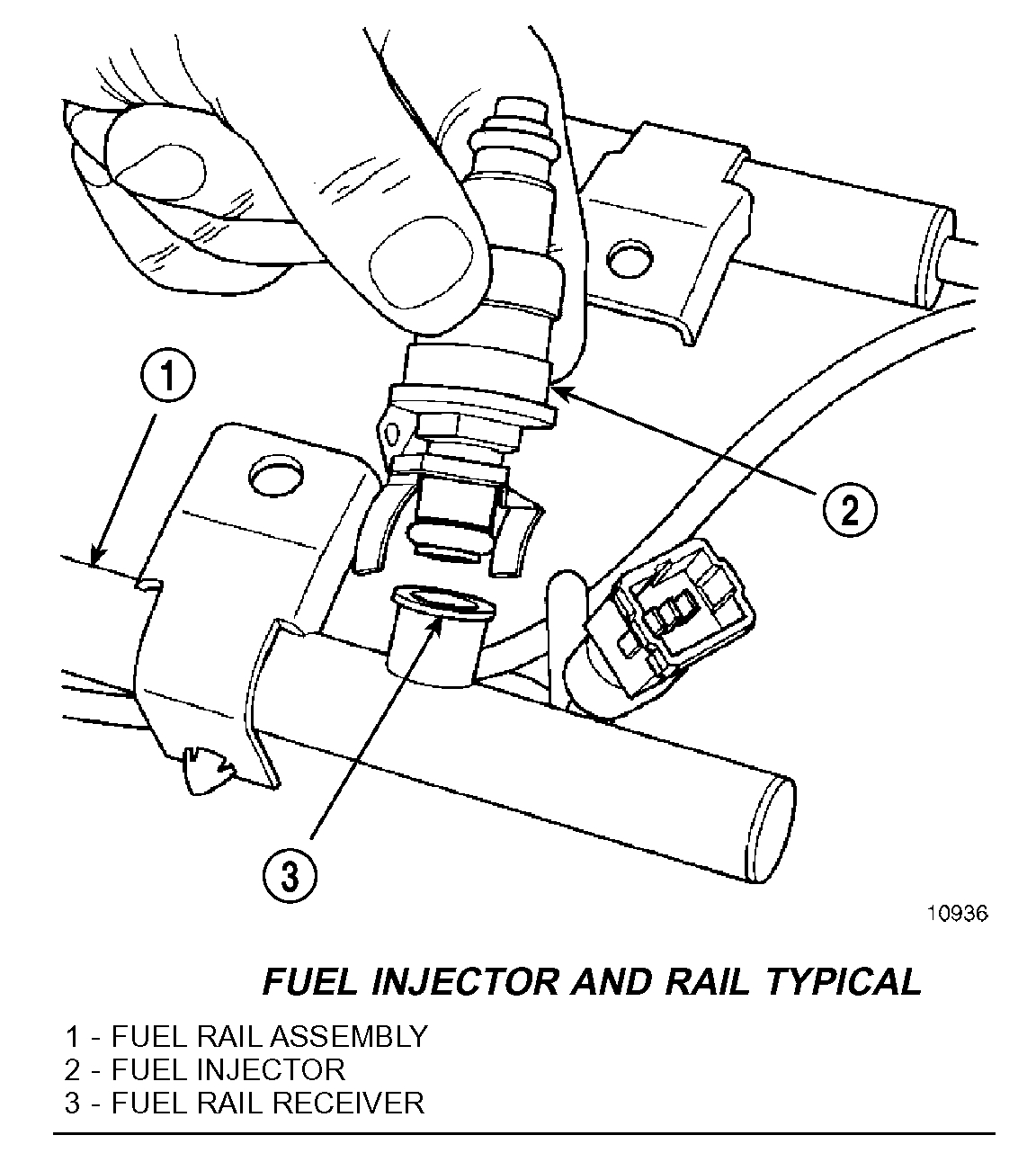

Now, here are the directions for replacing a fuel injector. The attached pics correlate with the directions.
________________________
2005 Dodge or Ram Truck Grand Caravan V6-3.3L VIN R
Procedures
Vehicle Powertrain Management Fuel Delivery and Air Induction Fuel Injector Service and Repair Procedures
PROCEDURES
REMOVAL
1. Disconnect the negative battery cable.
2. Remove the Intake Manifold.
3. Disconnect injector wiring connector from injector.
Fuel Injector And Rail Typical
Pic 1
4. Position fuel rail assembly so that the fuel injectors are easily accessible.
5. Rotate injector and pull injector out of fuel rail. The clip will stay on the injector.
6. Check injector O-ring for damage. If O-ring is damaged, it must be replaced. If injector is reused, a protective cap must be installed on the injector tip to prevent damage. Replace the injector clip if it is damaged.
7. Repeat for remaining injectors.
