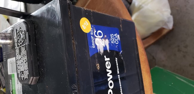

No, see, I bought a brand new, fully charges battery and drove about two hours from the place I bought it to my girlfriends house and left it there two weeks. Went back and it had no power or anything. I jump started it with jumper cables and let it run about ten minutes. Drove it a couple places and turned it off and back on at each place; had no problems. I exaggerated the five hours, might have maybe three tops. Drove it to my house and started it everyday for about two minutes to make sure it did not shut off. I ended up leaving it for two days then went to start it and it had power from the battery, but would not turn over. It was wanting to, but sounded like it was dying out as I turning the key which is what led me to the alternator. All the lights were off as well, nothing was left on.
I do not believe it is the starter since it was dying out as I turning the key and I was losing charge from my battery, and it started fine before had even when I had to jump the battery. It is also possible I had a bad battery.
I bought one of those cheap Value Start batteries from Walmart because it was all I could afford at the time. I had no smells or anything either when the vehicle was running or as I was starting.

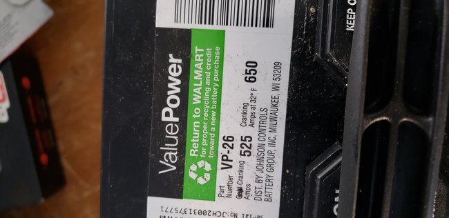

That could possibly be another problem I have is I have no battery hold down plate. It either broke or they removed the battery.
Also, the Value Start battery I bought has a CCA of 590, and, if what you say is correct, it is significantly lower than the recommended 650 CCA. I, also, checked an EverStart MAXX battery that is recommended for my Jeep and it was bigger than the Value Start the online website said would fit my Jeep. Both are top post like my vehicle takes.
At my employer, we have a Duracell with a CCA of 775 at 0 degrees, and I am really leaning towards buying that battery and a hold down plate through a Mopar Parts Store for my Jeep and see if it helps anything at all.
Oct 18, 2018 at 7:52 PM
CARADIODOC
  • 34,321 POSTS
My '80 Volare came with a 350 CCA battery, and that was an upgrade included in a package that included FM radio, and a bunch of plastic bolt-on "Road Runner" body panels and tape stripes. That battery was so small, unscrewing one cap almost caused all of them to unscrew because they were so close together. Drove that car its first two years back and forth to college in miserable Wisconsin winters. It never failed to start the engine, even after sitting for three weeks over Christmas break. It was 30 below the day I went back, and the engine started just fine. Replaced that battery when it was more than five years old only because I didn't trust it because of its age.
Your battery should be fine for the size engine you have. Replacing it with one with a higher CCA isn't going to solve a battery drain problem.

I understand that, but the point I was trying to make was, according to Walmart battery guide book, the battery I bought for my Jeep is not listed as being compatible for my vehicle in that brand. Either the online battery sizer I used through the Walmart website or the book is wrong. Comparing the size difference between the Everstart MAXX battery and the Value Power batteries, the Value one is significantly smaller than the Everstart, so, the battery I might either have a dead cell or is not for my vehicle at all which could cause the battery drain because there is too much juice being pulled and the battery is not strong enough.
I was talking to a coworker who is a car guy, and he told me to get a better battery, and use a quick disconnect on the positive terminal until I can pinpoint where the drain is coming from. He said leaving it connected while I am at work for eight or nine hours should not hurt it, but if I have to leave it for longer periods then I should disconnect the positive terminal to prevent my battery from draining.

There is a clinker in yer thinker. I have a suspicion your battery was not listed for your vehicle because it is considered a truck, not a car. Truck batteries are expected to bounce around more which can be expected to shorten their life span. Therefore, they often come with shorter warranties; typically only three years instead of the more common five years. I cannot emphasize enough, the battery is not causing the problem. You can put one in big enough to start the space shuttle, but that still will not stop the drain. Think of a small leak in a municipal water tower. Your answer to stop that leak is to put the tower on longer legs. What you need to do is address the leak, not the size of the tower, or its height. What you need to do is address the drain, (electrical leak), not the size of the battery. Once the drain is solved, you can put in a battery that's half of what you have now, and it will work fine.

In the instrument cluster, you'll find a bunch of 194, . . . what I call "peanut" bulbs, because they're about the size of peanuts, (as opposed to the larger "acorn" bulbs), but that is a story for another day! Those 194 bulbs where fairly universal among all car brands and models for many years, so you can find a pile of them in any pick-your-own-parts salvage yard. These bulbs have an unusual characteristic where they turn black inside over time. Even though they might not be burned out, they give off very little light. You will find these for a lot of license plate lights too. As a side note, I have to visit a yard soon to get about 160 of the twist-in sockets these bulbs plug into. Need them for a new display board I'm building to sell LED versions of these at an old car show swap meet. 1980's and 1990's Jeeps are some of the easiest instrument clusters to remove in a salvage yard. Often just need a Philips screwdriver and nothing more.
The group 24 and 27 batteries are the only two I have memorized because they used to be so common. I suspect the biggest difference with a group 34 is it probably has the two tabs on the bottom for the hold-down bracket, but the height could be shorter too for vehicles with lower hood lines, or something like that. Regardless, if it can be bolted down, you are good to go.

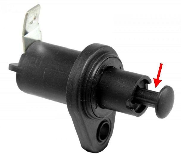

Just thinking out loud, . . . when you turn the key in the door lock, there is a switch that sends a disarm signal to the Body Computer to turn off the anti-theft system. You only hold the key in that position for a fraction of a second, then return it to centered so it can be removed. What if the wire for that switch is broken between the door hinges and is touching a frayed adjacent wire? That is one way an inoperative door lock could be related to a drain. Those touching wires could be sending the disarm signal continuously. That is the kinds of things we have to consider when looking for a drain. Once it is solved, we usually find something that works properly now that should have been a useful clue.

Made a road trip to Walmart to see what the differences are. A group 34 battery is 1/2" shorter than a group 24, and the caps are recessed. That means your 24 is one inch taller. Width and length are the same. I have the same issue with my 2014 Ram. It calls for a weird battery with recessed posts for hood clearance, but after letting it sit all winter and freeze, I drove it to the battery store with a borrowed full-size group 27 and had no clearance issues. Under just the right set of conditions, the engineers found a special battery was needed, and rather that try to confuse us with a pile of choices, they just picked the battery size that would work in every application. Someone might require that special battery, but my truck does not.
The 1993 through 1998 Grand Cherokees are all listed as needing the group 34, but if you did not create a bulge in the hood or sparks when you slammed it shut, you can get by with the group 24. That might not be the case in a different year, or perhaps with an optional hood style.
It was interesting to note that 1999 and newer Jeeps call for a group 65. That battery is the same height as a group 34, but it is one inch longer. That does not mean you must put that one in. A group 34 would fit and bolt down just fine, with an inch of room left over. By the way, all three of these have the mounting tabs on the bottom. The book lists the cheaper group 24 as having 650 CCA, and the original for your vehicle is listed as a 600 CCA. As long as the posts do not hit the hood, as I have said multiple times, the battery you have will be fine. If you buy the other one with 800 CCA, you will be buying more battery than you need or will use.

Even still though, the original recommendation was 600 CCA and the group 24 battery I bought is 590 CCA, so, going by the original specifications, the group 24 I bought is under the original recommendation for my vehicle.
Oct 20, 2018 at 10:59 PM
JOSHUA CURTIS
  • 22 POSTS
I apologize, I was wrong, I bought a group 26 battery. Regardless, either there is a leak or that battery is not strong enough for my Jeep.

Go ahead, but it is not going to solve anything. Remember, the biggest, strongest, baddest battery in the world is only guaranteed to crank the engine fast enough to start after sitting for three weeks. Longer than that and the battery can not be blamed for a failure to start.
As a side note, I buy a lot of batteries to run lights and a radio display at an old car show swap meet. I get all of mine from a battery store where I can buy "reconditioned" batteries for $35.00. These could have just been in stock too long and they want to get rid of them, or, more commonly, someone returned a new battery because it didn't solve their problem. They cannot sell it as new now, so they call it "reconditioned" instead of "used". I take whatever group size they have available. Two of those were deep cycle batteries I got a few years ago. One just died two weeks ago. It would only crank the engine for about four seconds, which usually isn't long enough for it to start. I put its twin in, and now it will run my inverter and laptop for over two hours, then still crank the engine just fine. Before all this drama, I had a puny group 24 in there that lasted over six years, then it developed a shorted cell. Whenever one of my numerous vehicles needs a battery, I grab whatever is at hand, and I have never ever looked at the CCA rating or gave it any concern. If it fits, it works.
My 2014 Ram came with a 750 CCA battery. It was a salvage vehicle that my buddy rebuilt at his body shop. Since I did not really need it, I let it sit at his shop over winter, and the battery ran dead, as expected, and froze. The people at the battery store said the replacement would run $135.00 because it was a special size for hood clearance, with recessed posts. Upon their suggestion, they looked in their reconditioned pile, and found one rated at only 675 CCA. Naturally I grabbed that one, and it has been working fine. I only drive that truck about once a month. It always fires right up, and that battery will also run my laptop for well over two hours.
I pay for these batteries by turning in five or six old ones for the "core". They would not take my old Ram battery until I could prove it was really bad. They said I needed to take it home, slow-charge it for three days, then test it. Sure enough, it is working fine in another vehicle, just like they said it probably would. This might be one of the new "absorbed glass mat", (AGM) batteries I have heard about that have unusual requirements. Going to have to learn more about them.
The bottom line is you are obsessing over the wrong thing. Do not waste your valuable time worrying over a few cold cranking amps. That is as relevant to the problem as is the number of street lights there is in Walmart's parking lot to whether or not you can see at night.

My interior light do not come on when I open my driver side door. When I click the unlock button on the keyless remote the dome lights will come on, but, as I stated before, it doesn't unlock the doors so I didn't see a point in using it.

Very good. You still might want to check for broken wires between the door hings. That job is made a lot easier on most Jeep models because that harness unbolts, then unplugs, and can be inspected and repaired on the workbench, not with your head stuck in the door like on most vehicles.

I was actually looking where you said something about the door, and I don't have a door jab switch on the driver side. All I saw there was a wire connector, but I can't find any kind of replacement for it. On Rock Auto, they have dashboard mounting door jab switches where mine is right on the inside door by lock hinge. I don't know if having that wire just hanging there is drawing any power to it or not. Also noticed I don't have a glovebox light. I'm looking into getting a new switch for it, and the ashtray light I don't know if it works or not. The hinge is missing from the ashtray so it just hangs there. Looked on Mopar Part Giants, and they have one for it, so I'm going to change the bulb and see if it works; I can just tape it shut until the new one comes in.

Dangling wires are the exact opposite of a short. In electrical terms, we call that an "open circuit". That would be the equivalent to a garden hose with the nozzle turned off. No current, (and no water), will flow. The opposite of that is a "closed circuit". That is a properly-working circuit that is turned on. All motors and light bulbs have some resistance that limits how much current will flow. In the garden hose, you could add resistance by squeezing the hose or standing on it. That higher resistance would decrease current flow.
When you have a short circuit, current is able to bypass that bulb or motor, so there is no resistance to limit current. That's when the fuse is overwhelmed and blows. The equivalent with the garden hose would be if you chopped it open with an axe. In this silly story there is still some resistance in the pipes, otherwise the municipal water tower would empty out instantly.

So it's possible then that dangling plug is live and could result in my battery going dead? Although I dont see that killing my battery after 2 days. I also found that the visor switch on the driver side was up and I'm assuming it was it in the on position since there's a little slide like with an arrow up and down. Assuming down is off and up and on, it would have been left on. Even with the visor closed it could had some play.
I found some door jamb switches for like 4.99 on auto zone so I'm going to replace all 4. Then when I get a battery I can see if they work or not cause I honestly have no idea. Since there was no door jamb on the driver side I assumed it didnt work. I never tried the passenger side where there is a door jamb to see if the under dash light and all came on

You didn't follow my sad story. There can't be any current flowing in something that is disconnected. For current to flow, you must have a "complete circuit". Here's the story I used in the classroom:
Water flows down multiple creeks into a river. From there it flows to the ocean, it evaporates, then the cloud floats back up here. Low-flying clouds get ripped on a church steeple and dump the water as rain. That water finds its way back to the creeks. That is a complete circuit. If you interrupt that anywhere, such as placing a sheet of plastic over the ocean, you stop the cycle, and no more water flows anywhere.

As far as the visor mirror light goes, as I stated, the switch was in the up position, which I can only assume is being on, even though the visor was closed would it still cause the light to be on? I know that would drain my battery.
The door actuators I believe are shot or not functioning correctly since they dont unlock my doors with the keyless remote, would that have anything to do with it? Do you know if they're difficult to replace? I know you have to remove the door panelling, but aside from that I'd be lost.
Oct 23, 2018 at 8:44 PM
CARADIODOC
  • 34,321 POSTS
The door switch listed for your vehicle is this teardrop design. You can find tons of them in any salvage yard. They were used on '96 and newer Caravans too. They have an extremely low failure rate, but a lot of people replaced them for the "Door Ajar" light and the interior lights turning on when going around a corner. That was caused by the slight outward movement of the door.
These switches are one-time auto-adjusting, and often slamming the door caused them to over-adjust, then this problem would occur. The simple fix is to use a pick to pull out the plastic "nail". That is how it adjusts. You pull it out too far, then it will find its adjustment when you close the door.
I had a lot of these vehicles come into the dealership with this problem, but instead of selling the customer new switches, or simply pulling the nails out, my fix was to pull the nail all the way out, slide on three M5 lock washers, then put the nail back in. My nifty red arrow is pointing to where the washers go. The washers prevented the nail from over-adjusting in the future, so the customer never had that problem again. I always did both switches right away, and for that professional touch, the people in the parts department gave me a bottle of black touch-up paint to color the washers so they didn't stick out.
If one of those switches is missing, my suspicion is someone less-informed than you removed it to stop the chime and warning message.

I have one on the passenger side, rear passenger, and rear driver, but I don't know if they chime or turn on the interior lights. I know if I click the unlock button on the keyless remote the overhead dome lights and under dash lights come on. As I said before, I never tried to open the passenger side door to see if the lights came on because I never noticed the driver door jamb was missing. I happened to look after you mentioned it and saw the connector wire hanging where the jamb goes.
From what all I noticed on the other ones they are all factory, and have the jamb sticking out like it's supposed to. As I said, I'm going to buy one for the driver side and replace the other three and see what happens from there.

Every visor light I've ever seen turns on with a switch in the flap, so if that is closed, the light will be off.
