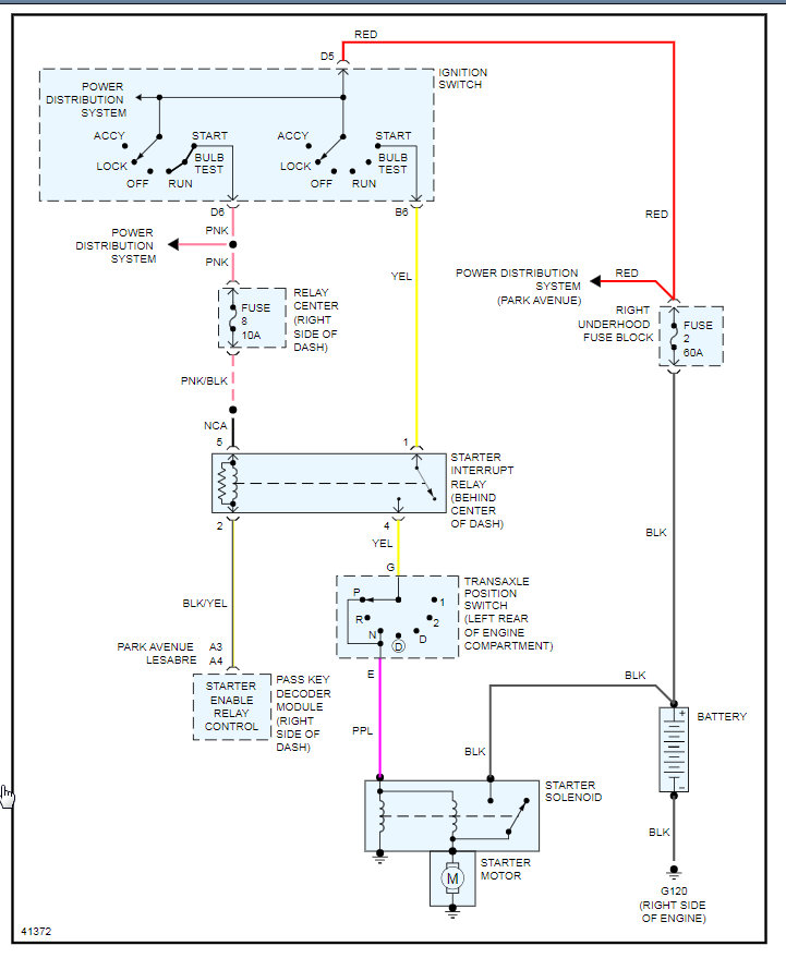

As for this issue I suspect we have an ignition switch issue but it is very odd that it just started out of nowhere, unless you have had issue with the ignition switch in the past.
